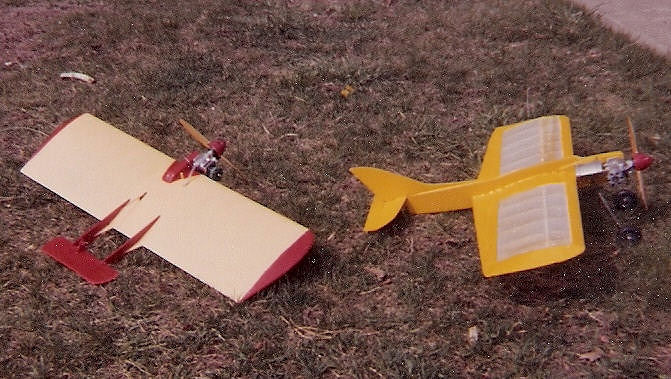

I have a Viper kit and was thinking about powering it with an old McCoy .098 or OK Cub .099.

My other thought for the Viper was one of my McCoy .049 diesels.
The reason I originally suggested a McCoy .098 or Cub .099 was that later .049 engines had almost as much power as these early .09's but the .09 engines are more user-friendly and don't have to scream their guts out to fly a small UC model.
My engine collection is heavily weighted towards .09 engines because I found out at an early age that half-A models with an .09 in the nose fly much better for me and I don't have to back up to keep the lines tight in light winds.
For me, an older .049 engine in a UC model may be nostalgic but an .09 engine can turn that same model into a very satisfactory flying session.
I did fly a Sterling Ringmaster Jr with a McCoy .09 Diesel and later with a K&B greenhead .09. It was an OK flier but more of a sport model than stunt.
As for the Flight Streak Jr. I agree it is a superb flier and I flew them back in the sixties with K&B Greenhead .19, Fox .19 and Testors/McCoy .19 engines. The K&B was my favorite and I still have a new one in case I run across another F/S Jr kit. I know Brodak has a repro kit so that's probably what I'll get.
