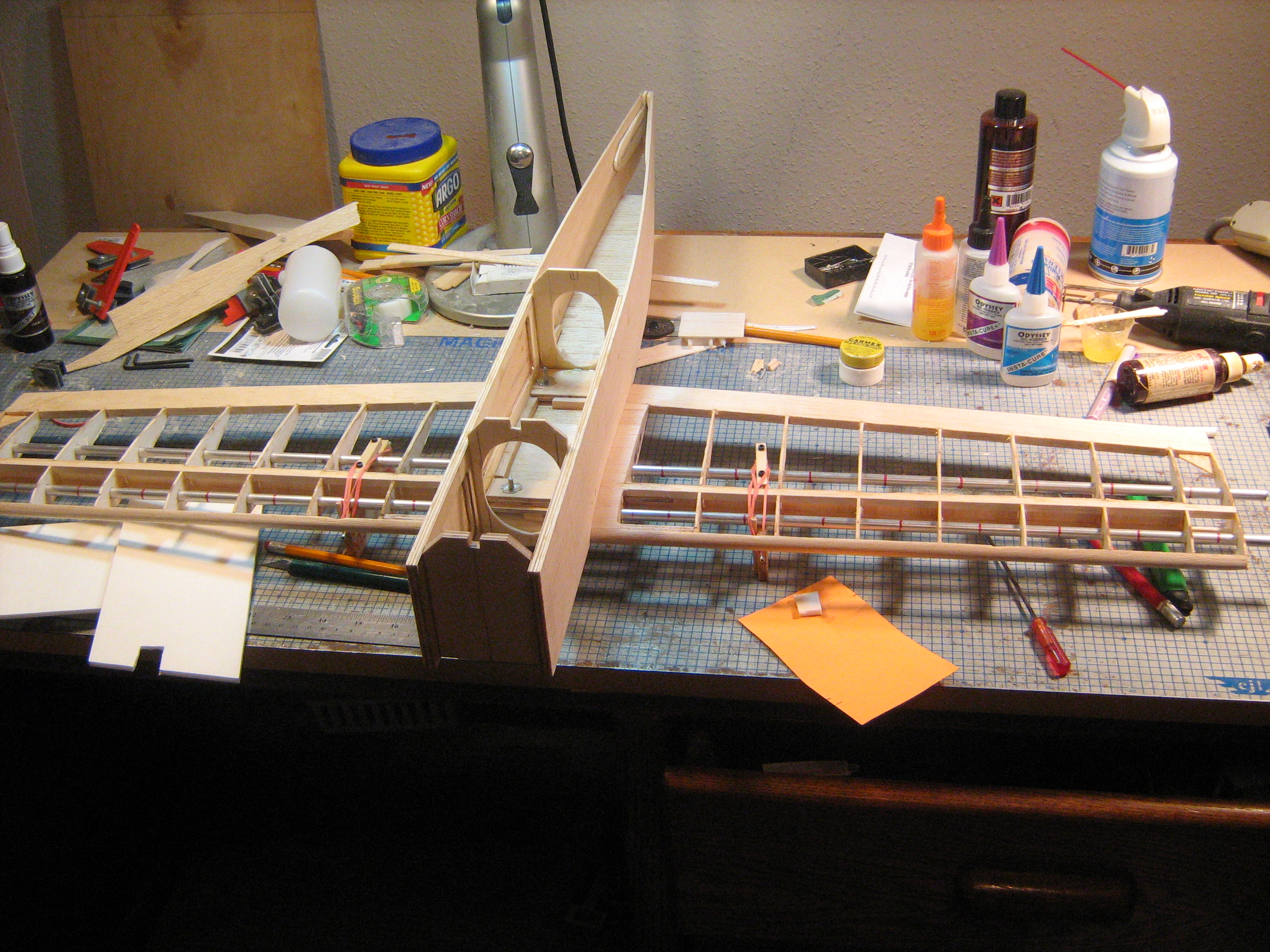

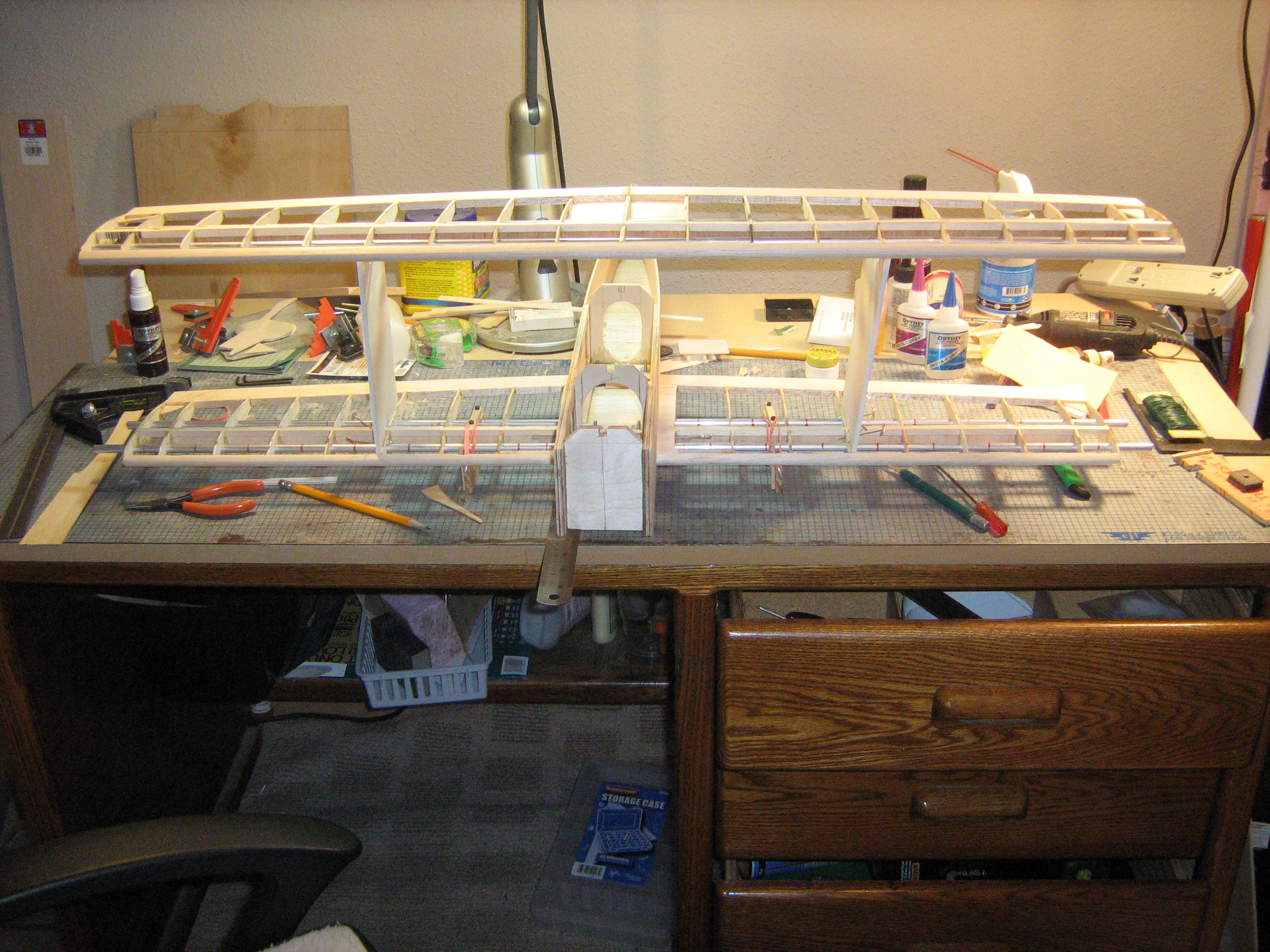

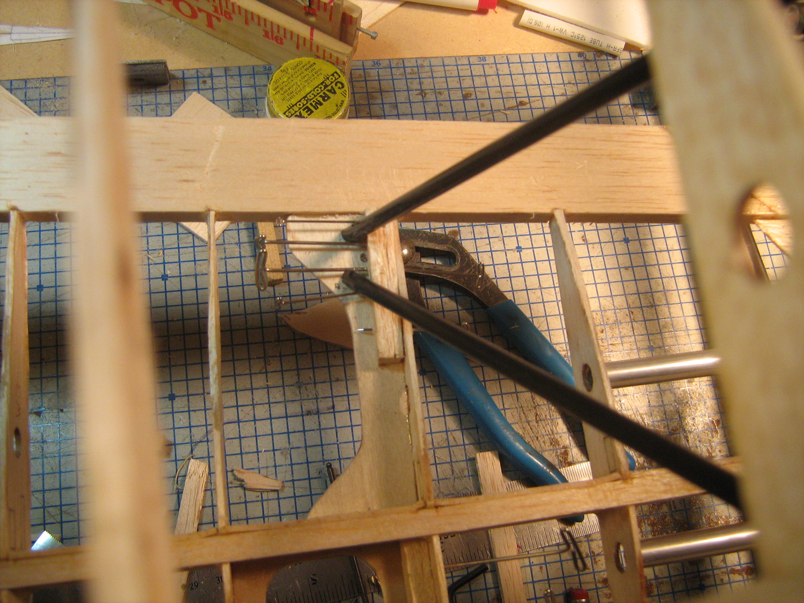

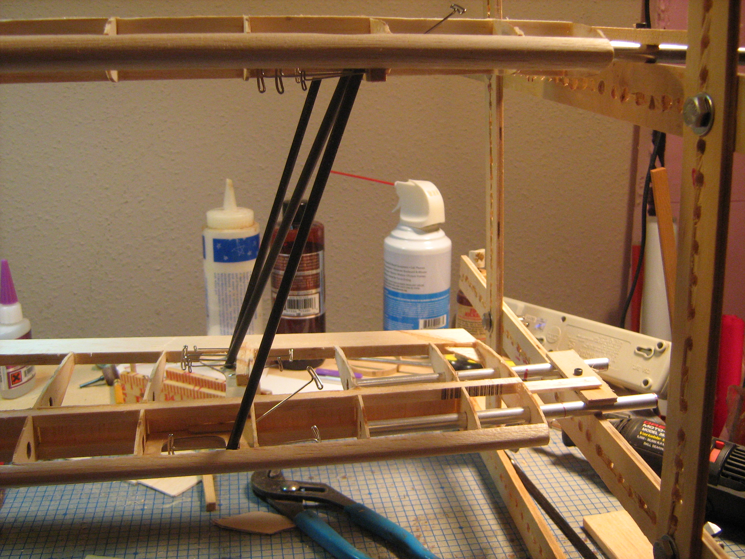

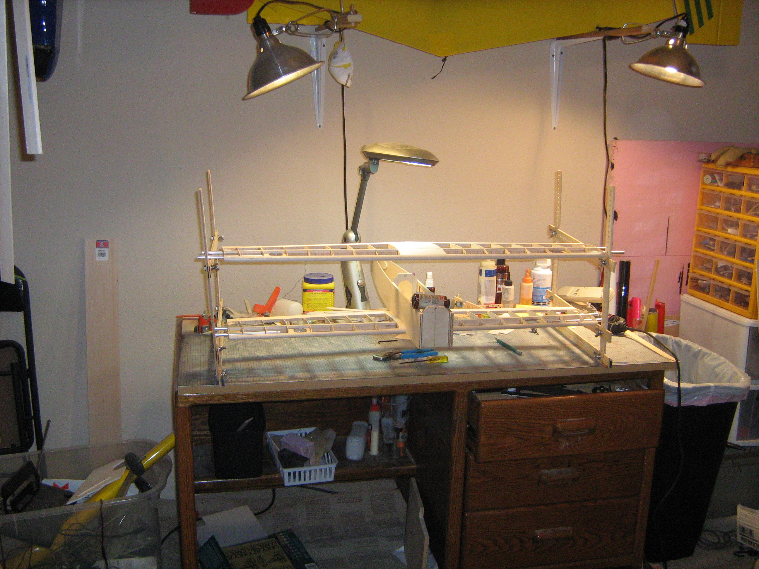

Well I am attempting to puzzle out top alignment.
So here is what I have done so far.
I put the wing building rods back in both wings to have a common reference point. I had to buy 2 more rods. I also had to cut the rods in halve that go into the bottom wing. The ply plates for the front wing bolts interfered, so cut resolved that issue.
I bolted the bottom wing on the fuse, and then set the wing rods on the rod holders. That took a bit of playing with. I had to move the rod holders way in as the wing (bottom) would twist to easily. Next thing was getting the aluminum rods clamped down good. Rubber bans proved the easiest way, just looped them over the wing rods.
I then cut some foam board into sort of struts. They set on the bottom wing building rods. I had to notch for the spars. I then pinned the foam struts to a couple of ribs and set the top wing on. Now I will try to get both wings in exact alignment.
Oh and the top wing is set forward of the bottom wing 1.75" There is also a full root chord of separation between the 2 wings.
I will instal small ply pads where the real struts will attach.
So what I have done is just to kind of wrap my handful of brain cells around mounting and alignment.
A disclaimer at this point.
Not even the tiniest drop of glue has been harmed at this point of alignment and mounting. A dry run.

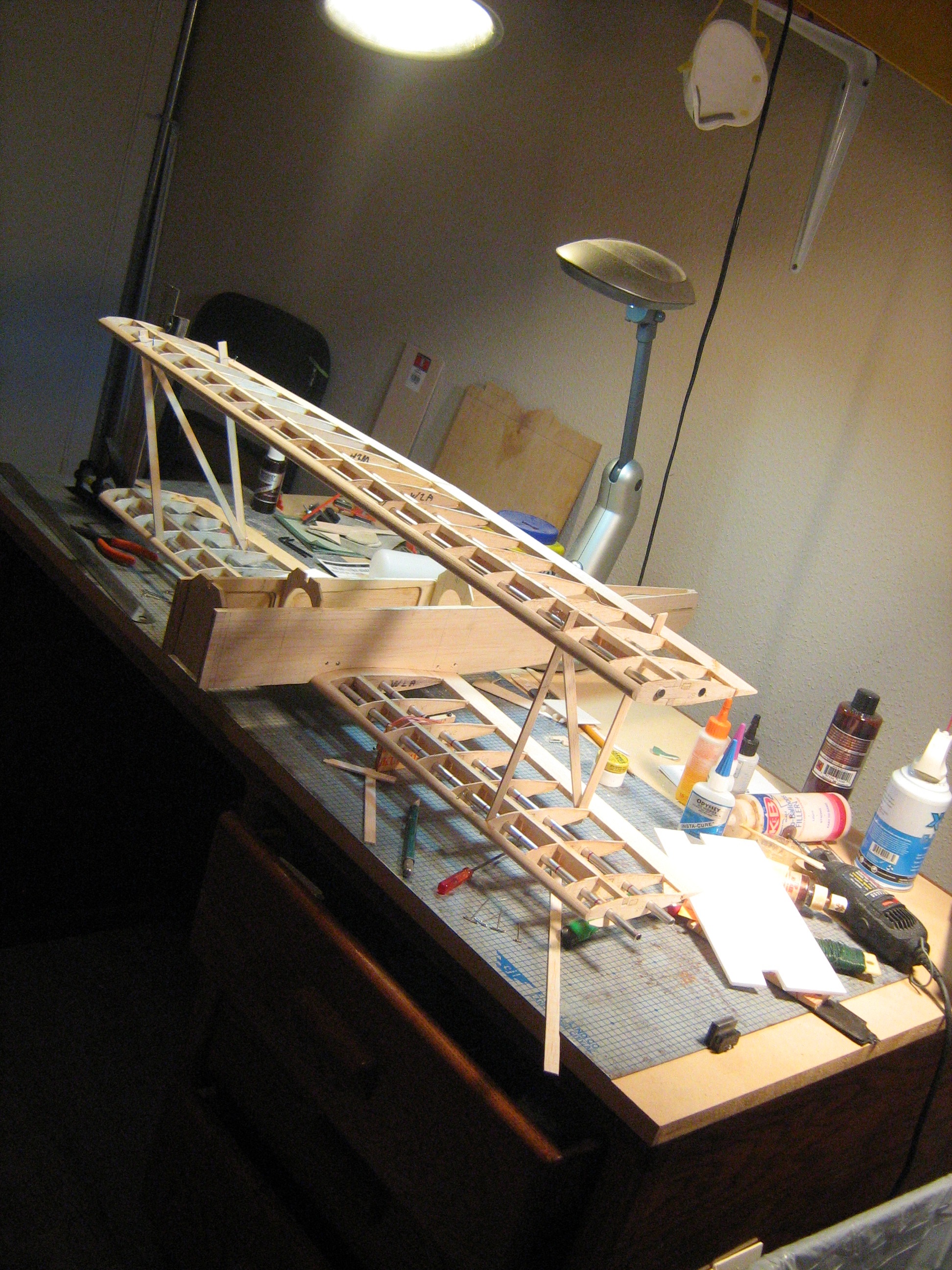

Ken

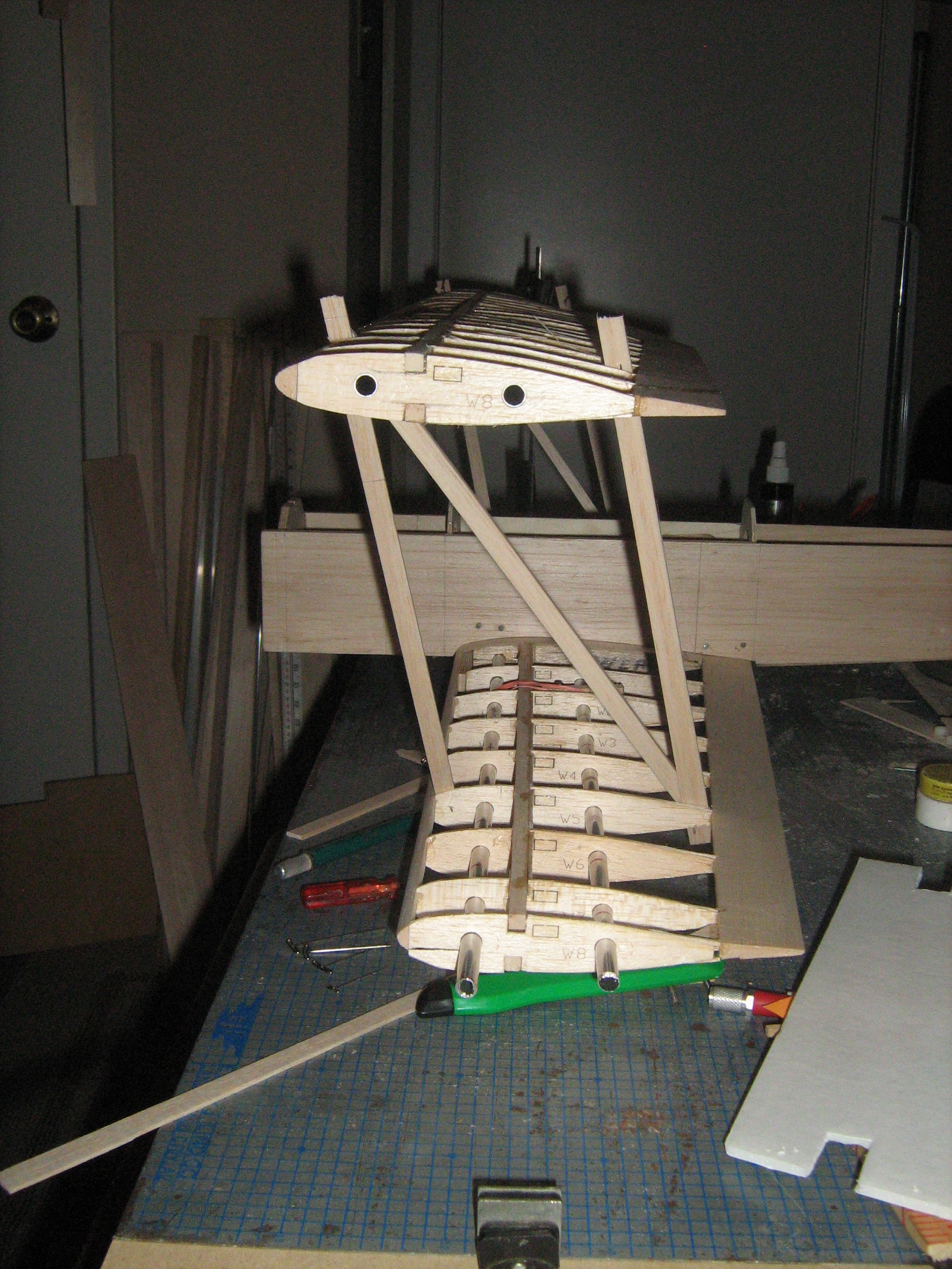

The first 2 pics are duplicates but I can't remove them.

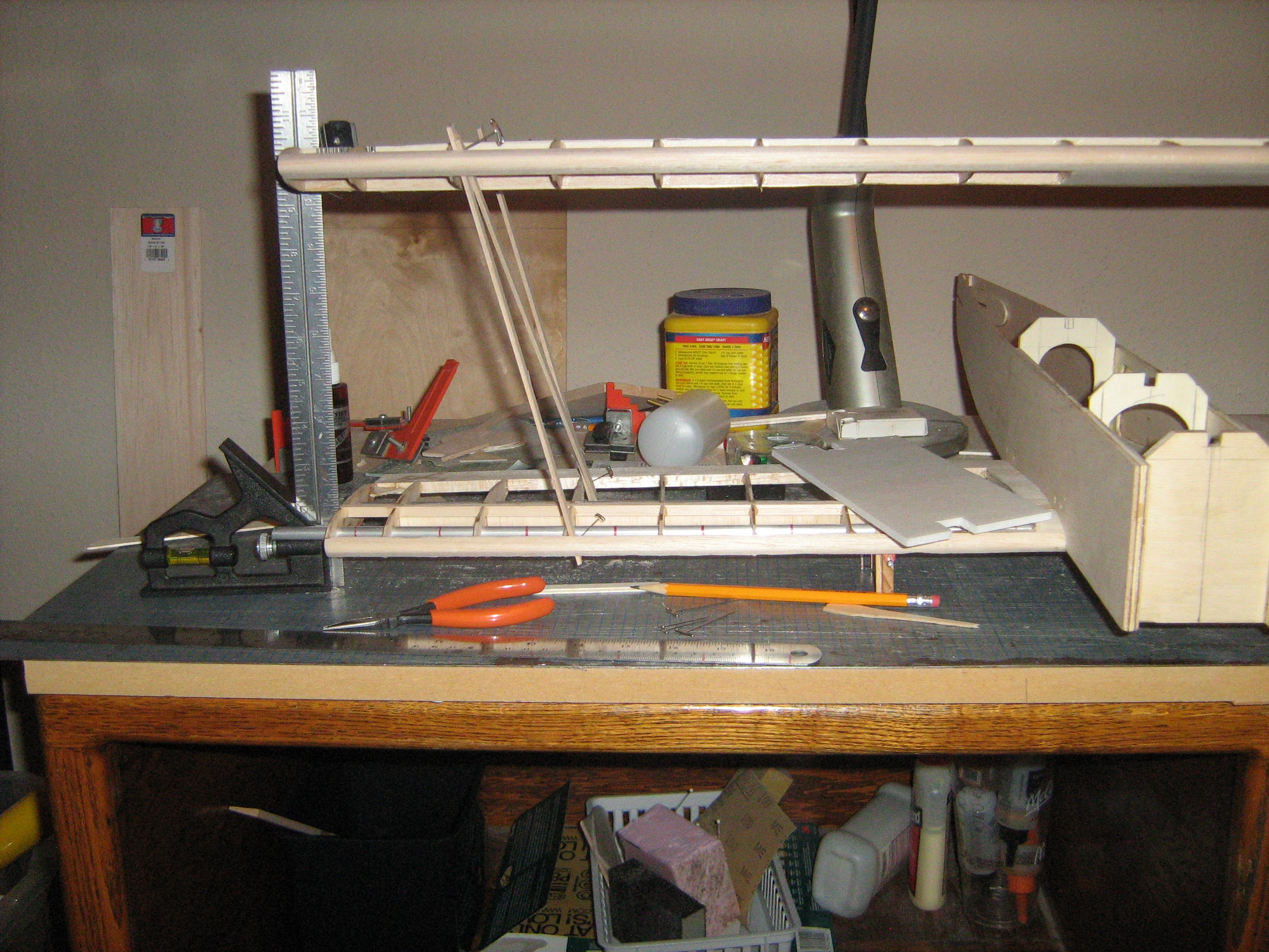

The other thing both the wife and I noticed, the wing gap seems excessive, even though it measures out correct. We think the fuse depth is what gives this impression. I think the way to solve this is to deepen the fuse. Both by just add some depth and by a tallish turtle deck.
It was suggested on another site that I lower the top wing 1" and to use a tallish turtle deck. I will do both.

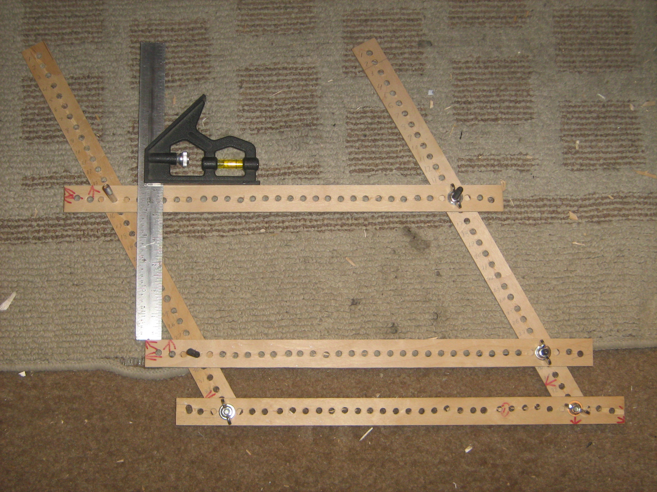

I think I may miss working on this plane this weekend. I want to build a pair of parallelograms type jigs for doing wing and stab alignments. I have about 4 more biplane projects I want to do. A 1/4 scale RC Pitts. I am kicking the ideal for a Rc Tri motor biplane and a CL tri motor biplane. Plus I have a pair of biplane wings needing a new home.

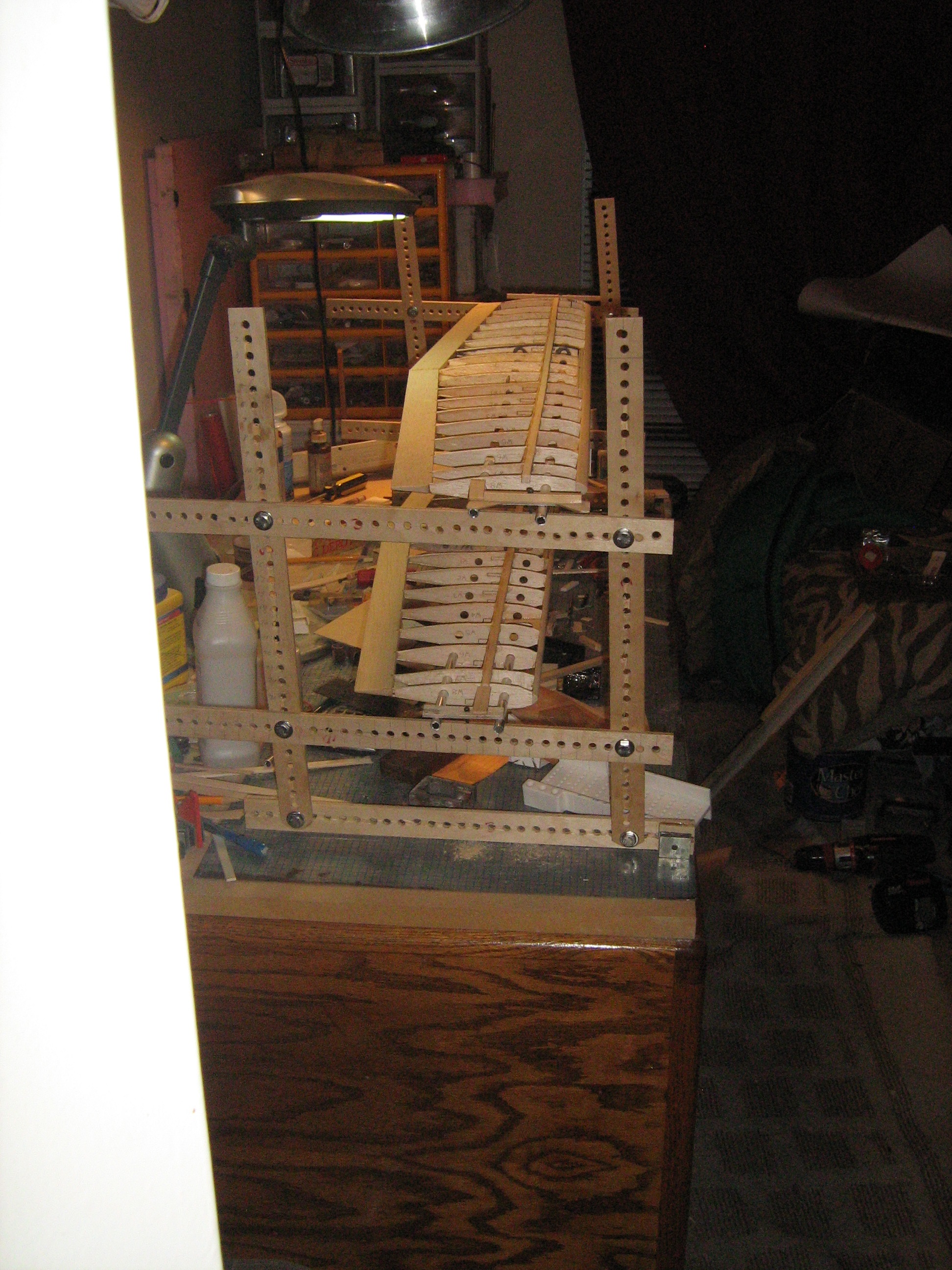

Slow progress this weekend. The wife and I did not have much running around to do. We basically stayed home and did nothing. We were both just worn out I think. So I got next to nothing done yesterday. Sometimes that is good, you just got to chill out and rest.
I have started physical therapy for my back, it should help at some point.

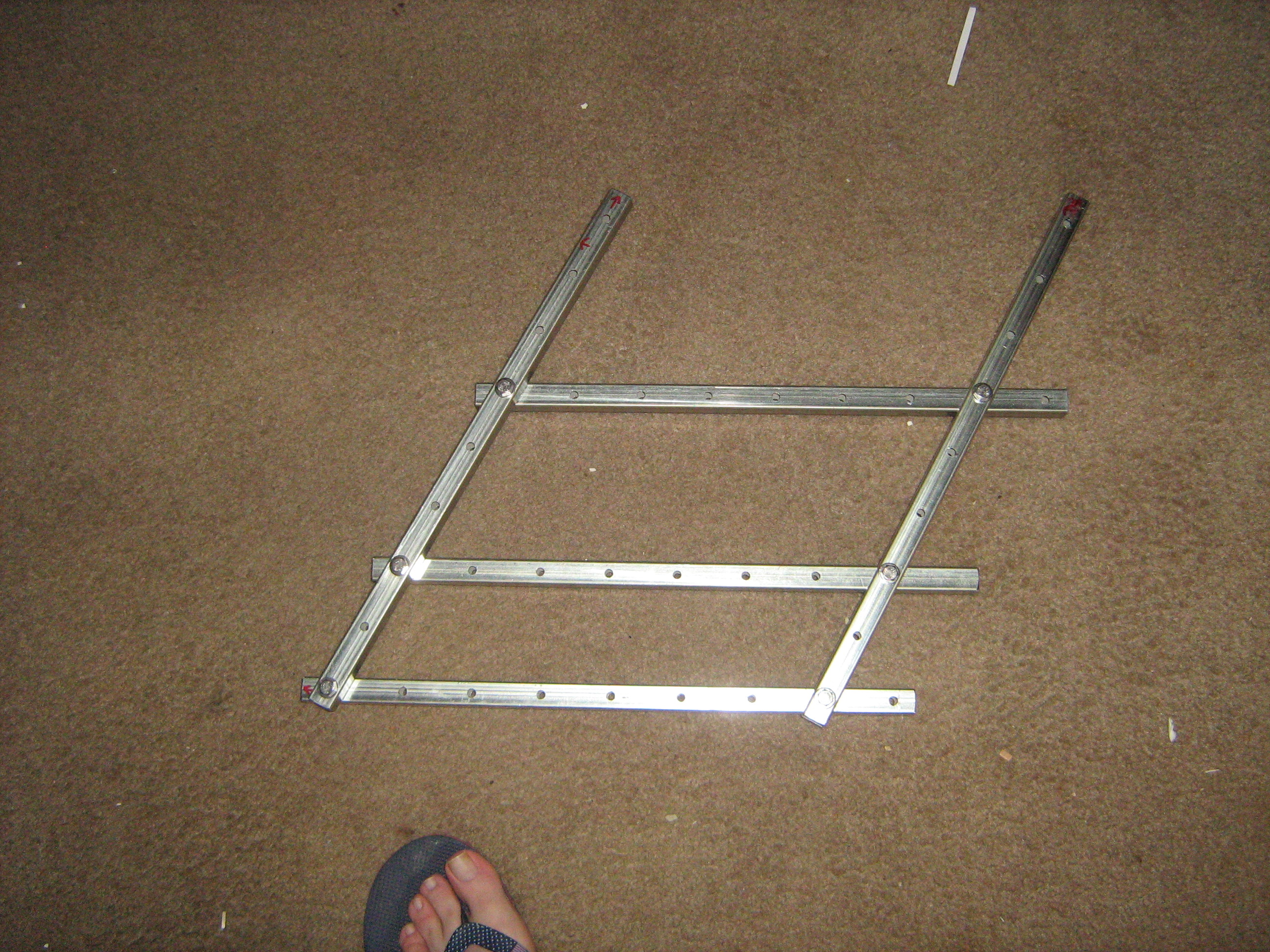

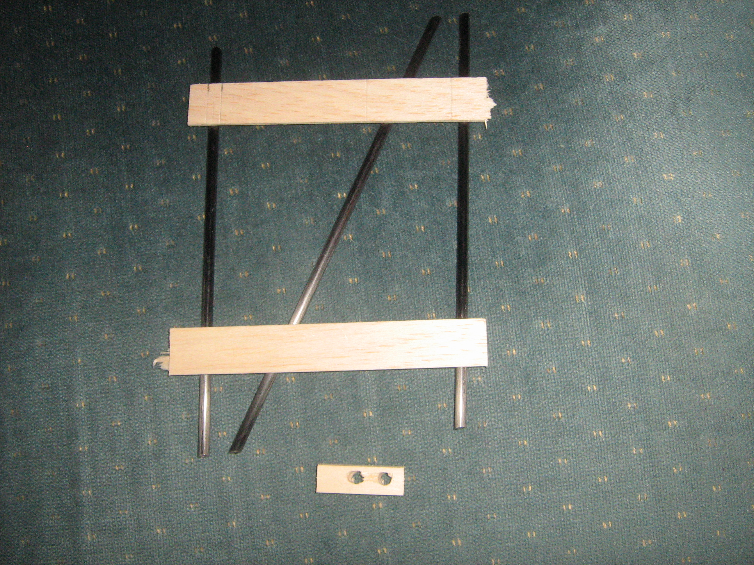

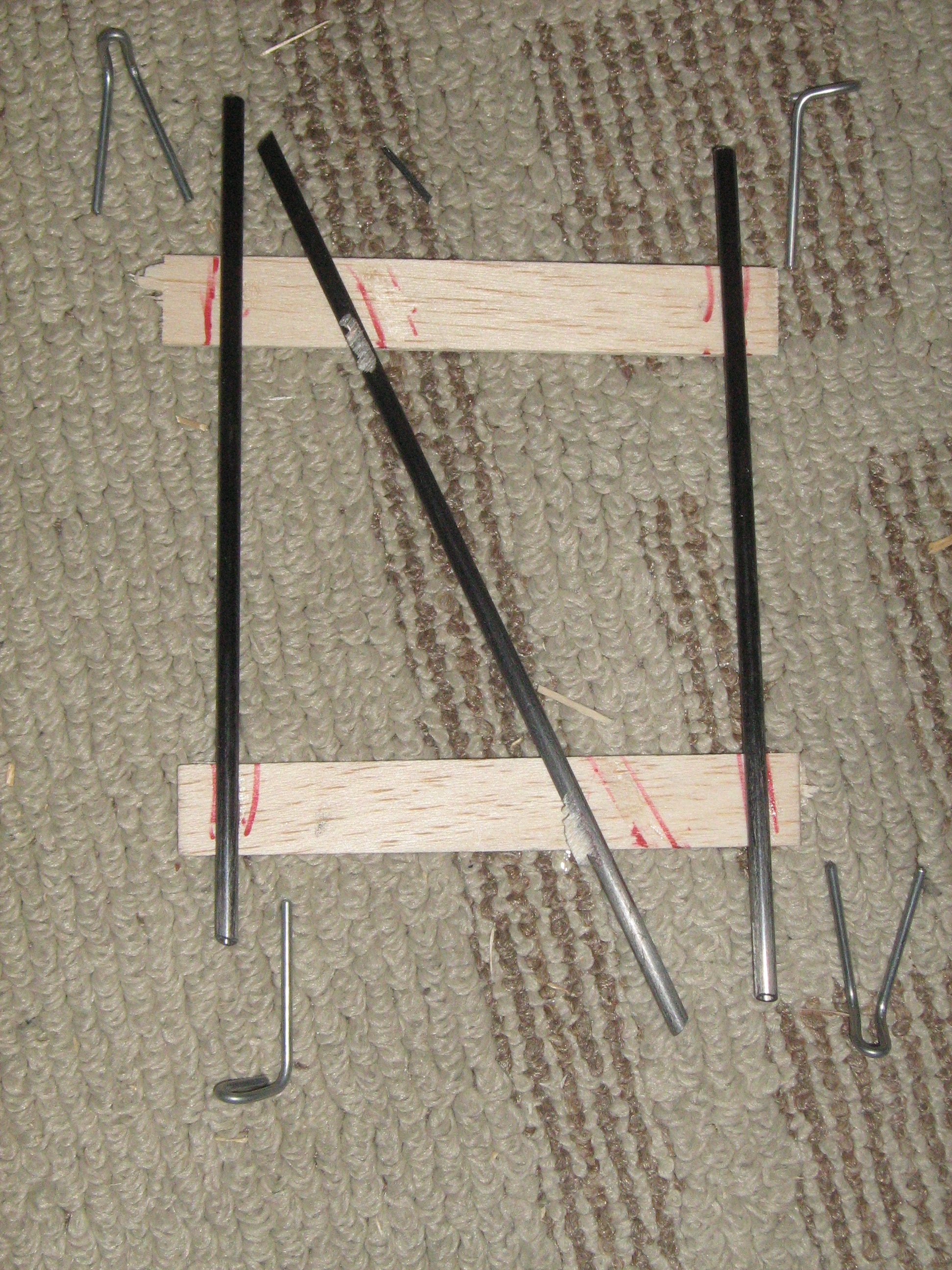

In regards to the parallelograms jigs for doing wing and stab alignments. A base and 2 parallel runners would make aligning bi plane wings much easier. I did make a tripe to Lowes looking for CHEAP yardsticks to make them out of. Well I found them but they did not have perfectly straight edges, so i gave up on the immediately. Angle aluminum would work good but was way to spendy. But about a month ago someone tossed a 1" square piece of steel tubing in front of the parking spot. It has just been laying there in the grass and weeds. So when I got home I took a good look at it. It is straight, not yet rusted. In short it is perfect and free, so it is now in my patio area. I will measure out pieces and start hack sawing it. I will make a jig to drill all the holes exactly the same. Check alignment of my drill press and have at it. I will post some pics. But that is a next weekend project.
Now back to the bi plane.

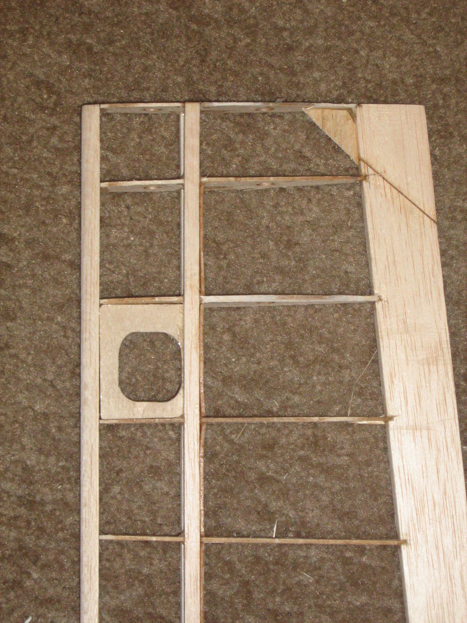

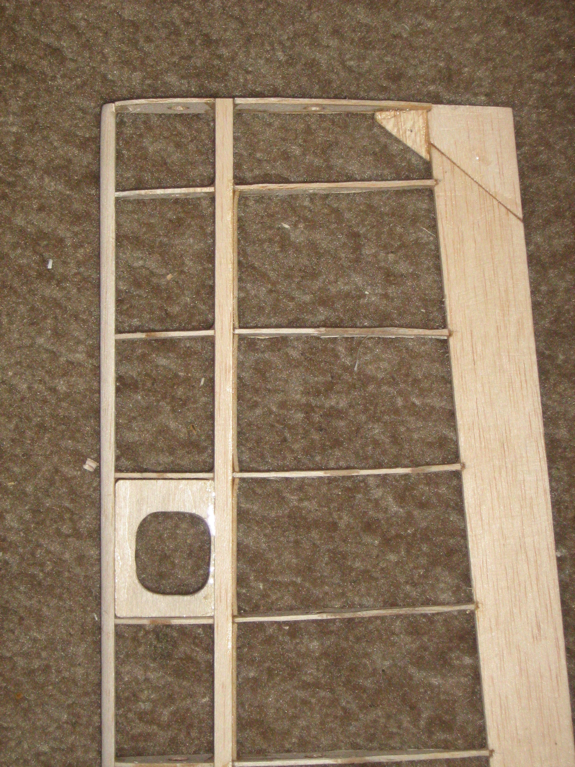

I did get some small amount done today. I made and epoxied in the front mounting plates for the inter plane struts. Next I have to make the back plates. They are 1/16" birch ply. Will need some gussets and possibly reinforcement. Once the back plates are in then I will need the pair of parallelograms jigs to set the wings. Then I can start making the interplane struts. This way I should be able to get the struts almost dead on, or so I am hoping.
Pic 1 is the bottom wing. The mount plate is in the 4th rib bay from the ends and is positioned towards the top of the wing The outboard side is wider and is where the strut will attach. I think I am going to put the front leg of the strut real close to the spar as that is the strongest point. The back leg will mount real close to the T.E. stock.
The second pic is the top wing The mount plate is in the 3rd rib bay from the ends and is positioned towards the bottom of the wing. The strut mount point is the same as the bottom wing.
By offsetting 1 rib it makes the struts lean out wards a bit. I don't know if it will be enough to help stiffen the wing wings in side to side play, but I like the look.

Ken was just checking back in and noticed the gap chord. I agree with both you and your wife the gap chord is excessive to the point its going to look very odd indeed. And I believe it would be a mistake to deepen the fuselage turning the airplane even more into a characture airplane and not even very recognizable as a ringmaster.
I am not talking about aerodynamics, Hang the aerodynamics if it does not look right you will never be happy. I am going to suggest you do not deepen the fuselage more and that you lower that top wing until it looks right to the eye. Another suggestion is even though it is not needed aerodynamically is to add some mild dihedral to the lower wing as this will improve the looks immeasurably.
I have done many "kit Bashes" over the years and one of my goals was always avoid loosing the identity of whatever it was that was started with.

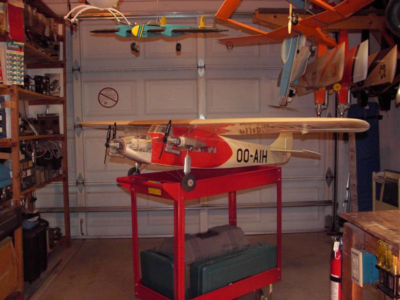

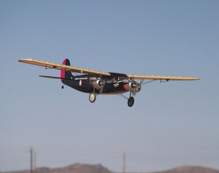

Thanks Ken for the kind words. OK now I totally get it on the trimotor thing and I think what you are going for is what I call a Characture airplane and not really ment to represent anything. I have done some along that line of thought and you know what I think that kind of ship can be totally cool. Ya go for it a big tri/bi plane really offers a ton of cool things to dream up.
I am thinking a ship of that size three 15/20's would work out just fine but the only problem with that is there are simply not many left in that displacement and likely choice would be the OS LA-15.
You know one of my dream projects and I know I am not likely to ever get to but that does not mean I can thourghly dream up the design. An that is the only Caproni CA-60 with nine wings (a triple set of triplanes) no tail surfaces (pitch and roll controlled by wing surfaces) an eight engines, Oh yea its a flying boat.

I was lazy yesterday.Did a lot of other things that were productive, but never went near the plane.
Today I got off my lazy butt and got busy on the parallelogram jig. I SHOULD HAVE STAYED LAZY!!!!!!!!
I totally screwed it up. I have one parallelogram built. IT AIN'T RIGHT!!!!!! The wing support arms are off about 3/32 front to back.
I made a jig to drill all the holes in exactly the same locations. I used a 1/4 bolt as an indexing pin for each hole. I have checked and I have holes that do not perfectly aligned and found one the was a full 1/8" off.
The jig I made has a fence and a indexing pin hole. I checked and trued my drill press. My jig is very securely clamped to the drill press table. I marked the working face of each piece and also the front of each piece.
But I ended up spending hours turn 3/4" square steel stock into garbage.
I do not know where I screwed up. I did not rush this. I spent a lot of time brainstorming it out.
I have gone over my steps and set up, and just don't understand how I could have had holes out off alignment with each other.
I am so p***ed off.
I will post 1 or 2 pics here, but I think I need to open a new thread in the Questions and Answers section. maybe someone can set me straight.
Ken

I took another crack at this jig.
!/4" ply. All the spacing holes are 1/2" apart. Lots of adjustability. I will have to buy a bunch of 1/4x20 3/4" bolts. I stuck whatever I had laying around.
But here is the important thing. IT IS PARALLEL. It checks exactly the same on both ends. I do need to check all the possible height positions.
I measure out all the holes at 1/2" intervals, but I used a cC clamped fence to keep a constant position from the working face of each arm. I stated all the holes on only one arm using a Fostner style drill bit. I then clamped all the arms together and started the first hole. took forever with the Fostner bit, so I switched to a regular high speed bit.
I still need to had the magnets to the base arms.
Now to get all the bolts assemble the second jig AND BUILD A WHOLE BUNCH OF BI-PLANES.

Any I am ready to get back to it now.
Last week was squandered on my failed parallelogram jigs.
Then I had a procedure on my back. Had the leeds removed today so got to work on the parallelogram jigs again this time they are of 1/4" ply and adjusting holes every 1/2". Any way it works. The arms are parallele.
So I intend to make some headway thanksgiving.
So here is the plane on the parallelogram jigs
Ken

Ok it was bugging me so I had to do a little bit of work. I made the 4 outer rear strut mount plates. Not yet glued in just test fitted on one panel. There is a small maybe 1/8" deep notch in the T.E. section to anchor the plate. At the plates front it extends past the spar and ties into the front plate. I will add some gussets as well.
If I had been thinking further ahead I would have made one piece mount plates and installed the before the top 1/4"square spar was installed. I think that would have been stronger. Oh well next bibe.
Maybe tomorrow I will get them glued in. Epoxy. I still have three more T.E notches to make and relieve the vertical shear weeb between spars. Back to work tomorrow so we will see. and short session, No SCS (spinal chord stimulator) right now. I am sure missing the pain relieve that thing provided.
Ken

The wings have been jogged onto the parallelogram jigs. I have set them at 7" for a 7" gap. Just under a full chord (average) gap. Any more and it just don't look right, looks like you could drive a Mack truck between them.
So I have been fight and fight with trying to make pads for the carbon rods to set in. The problem is that they have to have holes drilled in them for the rods. Compound angle holes. About six attempts and the same number of utter failures.
I finally gave up. I slept on it after I gave up and came up with something different.
I jigged the rods into place. Even that was a multi try effort. But I got it.
I will next glue some scarp balsa stock to all of them front to back, top and bottom. That should hold the strut assemblies together.
I still have to have the ply mounting pads at all four corners. I was trying to drill (at compound angles) 1/4"birch ply. No good, just can't get the angles correct. So I have a different tack. I will make the pads out of multiple layers of 1/16" birch. Drill the holes in each piece, but then cut from the edges to the holes making slots. One piece with the slots facing in and the other facing out. I can then epoxy the pads together as opposite layers.
It is either that or some really big sloppy holes, and I don't think that will work as the carbon rods will have to be securely epoxied into the holes, and if the joints fail bye bye airplane.
I sure hope somebody else has better ideals than I do, if so chime in.
Ken

Here is the first strut carbon core. Streamlined aluminum tubing will eventually cover the carbon rods.
At the bottom of the pic is one of the failed 1/4" ply pads that I gave up on, because I just could not get the compound angles correct.
Now that I have the rods jigged up and free I think I will take another crack at 1/4" ply as the pads. I can see one set of angles (fore and aft). There also has to be angle that leans outward (bottom wing) and inward (top wing).
This part is about as frustrating as anything I have ever tried.

I bent up some 4 40 rod. It took all of about 5 minutes each to cut and bend wire for the N portion of the strut. much less for the other ends.
Simple easy. And can fine tune the bends and angles to get the strut parts at correct angle and fit.
Will have to adjust the lengths of the carbon rods.
Ken
