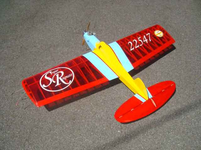

Many are familiar with the Super Ringmaster by Sterling for a 35 engine. This is a new redesign of the model for a 45 sized engine by Pat king. with a 52.5 in w/s and 590 square inches of wing area with a real stunt airfoil and modern construction methods.
ok so enough of the details. This is mine and just finished. It weighs 44 oz and is unflown till this weekend weather permitting.
powered with an LA46 and finished with transparent Red Ultrakote and Rustoleum paints. The graphics were done by Walt Umland..
I think that this might go a long way towards redeeming the S.R.'s reputation as the originals were prone to being overweight and I'm sure that I'll probably have a smile on my face after the first flight.

Dennis, that's a beauty- looks accurately built and NICE finish. How about some more specs-tank, controls,etc?
Old 04-24-2014 | 12:51 PM
My Feedback: (90)
Posts: 1,872
From: Minersville, PA
Nothing out of the ordinary. Has a 4 oz tank that is just short of getting a full pattern out of it till I change the venturi. Has a Tom Morris suspended bellcrank with C/F pushrod and ball link, but if doing another I'd omit the C/f rod it as it takes up a lot of room in trying to get it out the back to the elevator. A good wire set up would be fine, I just went for overkill. I made the control horn to get the length that I wanted to reduce the throw and it is pegged at 20 degrees each way. Balanced slightly behind the recommended setting, my preference, and the model delivers well at that balance point. It has a glide that has to be seen to appreciate. Not like the old Sterling drop out of the air landing
I've flown it a few times yesterday and the thick airfoil is a definite asset. Good lift and pretty good in maintaining the same speed through the maneuvers. It tracks well and tension is pretty good at the top. I have done all of the maneuvers but can only get a pattern in if doing the old pattern with 1 lap between maneuvers. Flying on 64 foot 015 lines with Powermaster 5/22.
