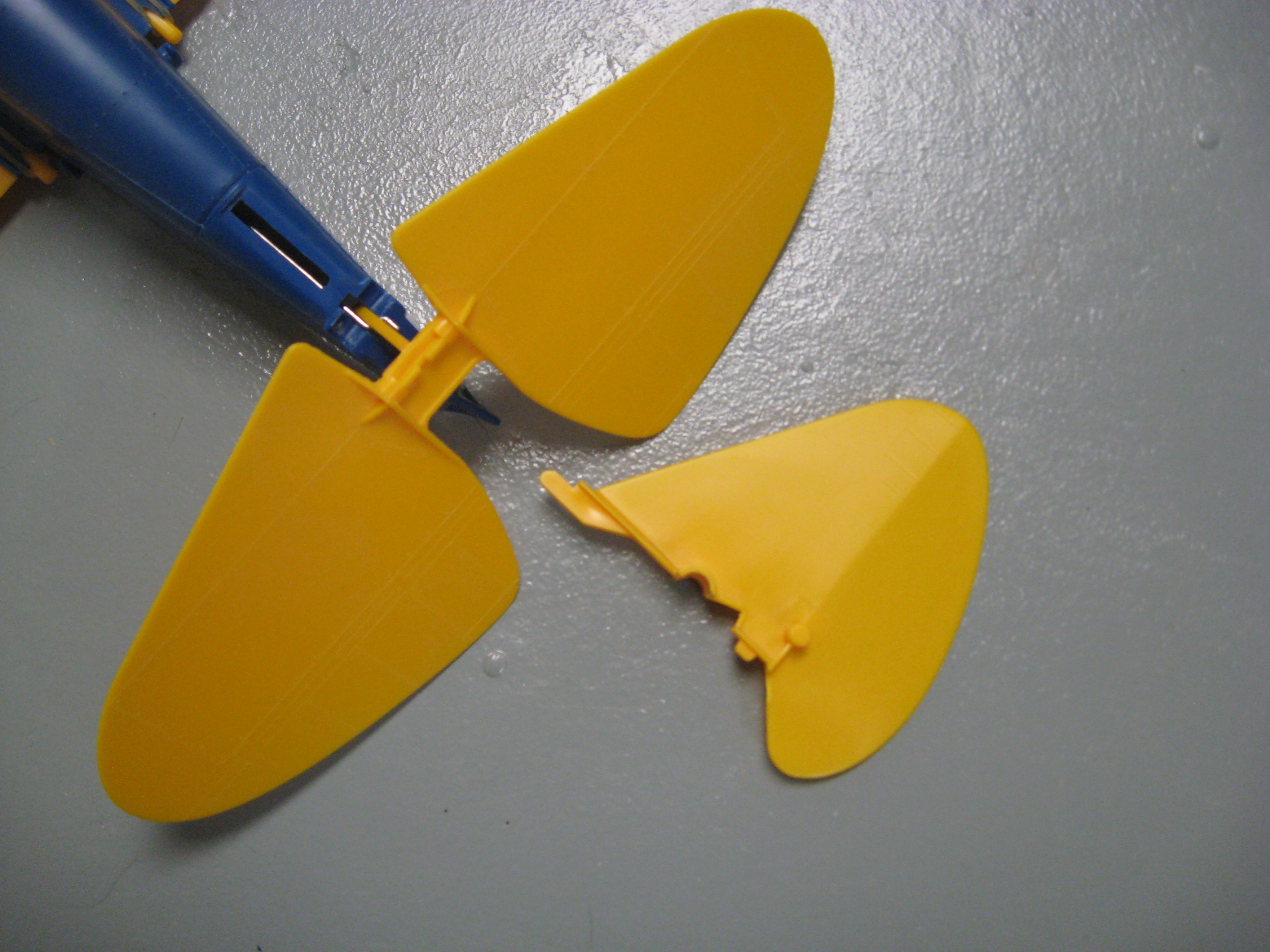

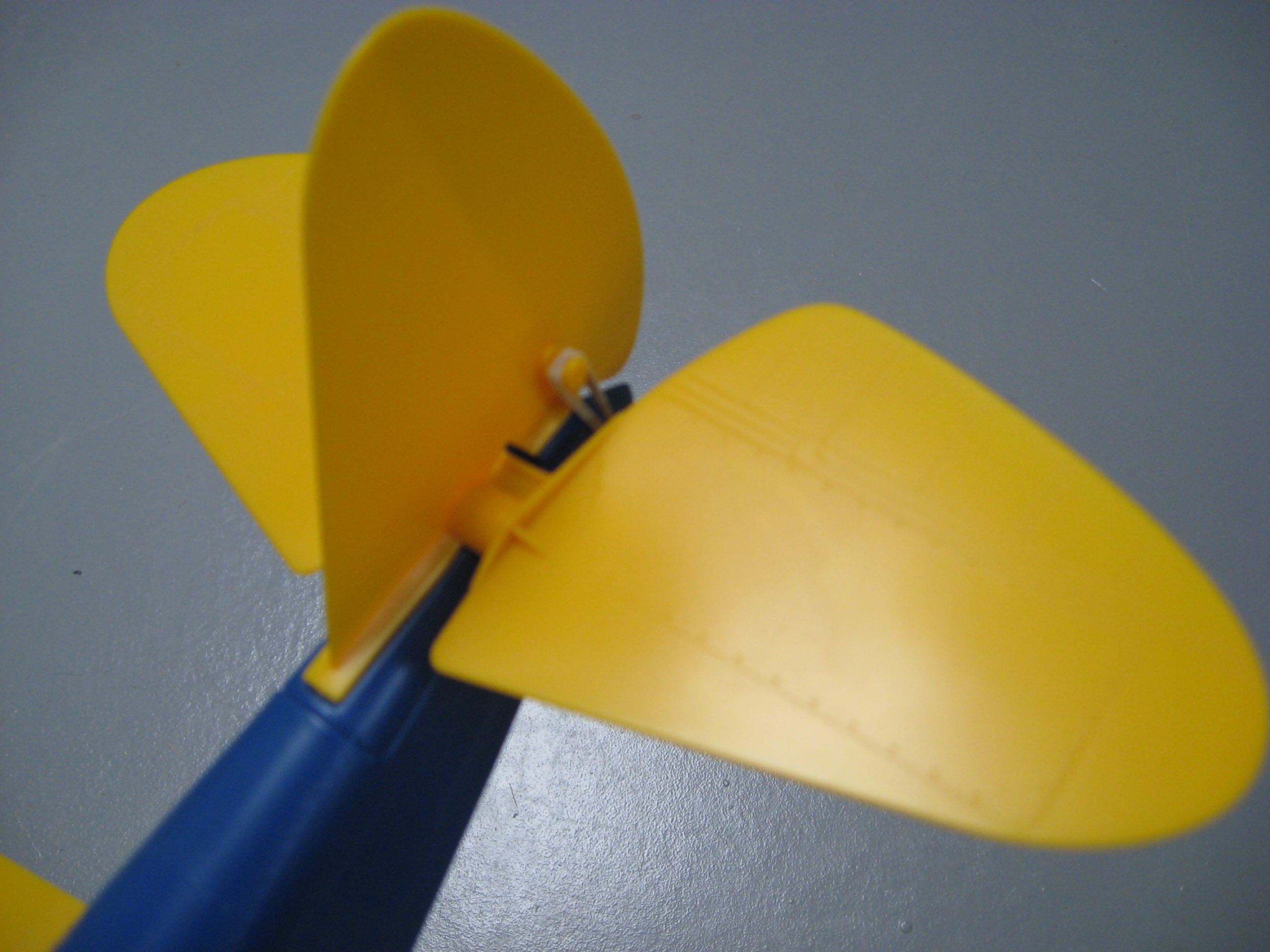

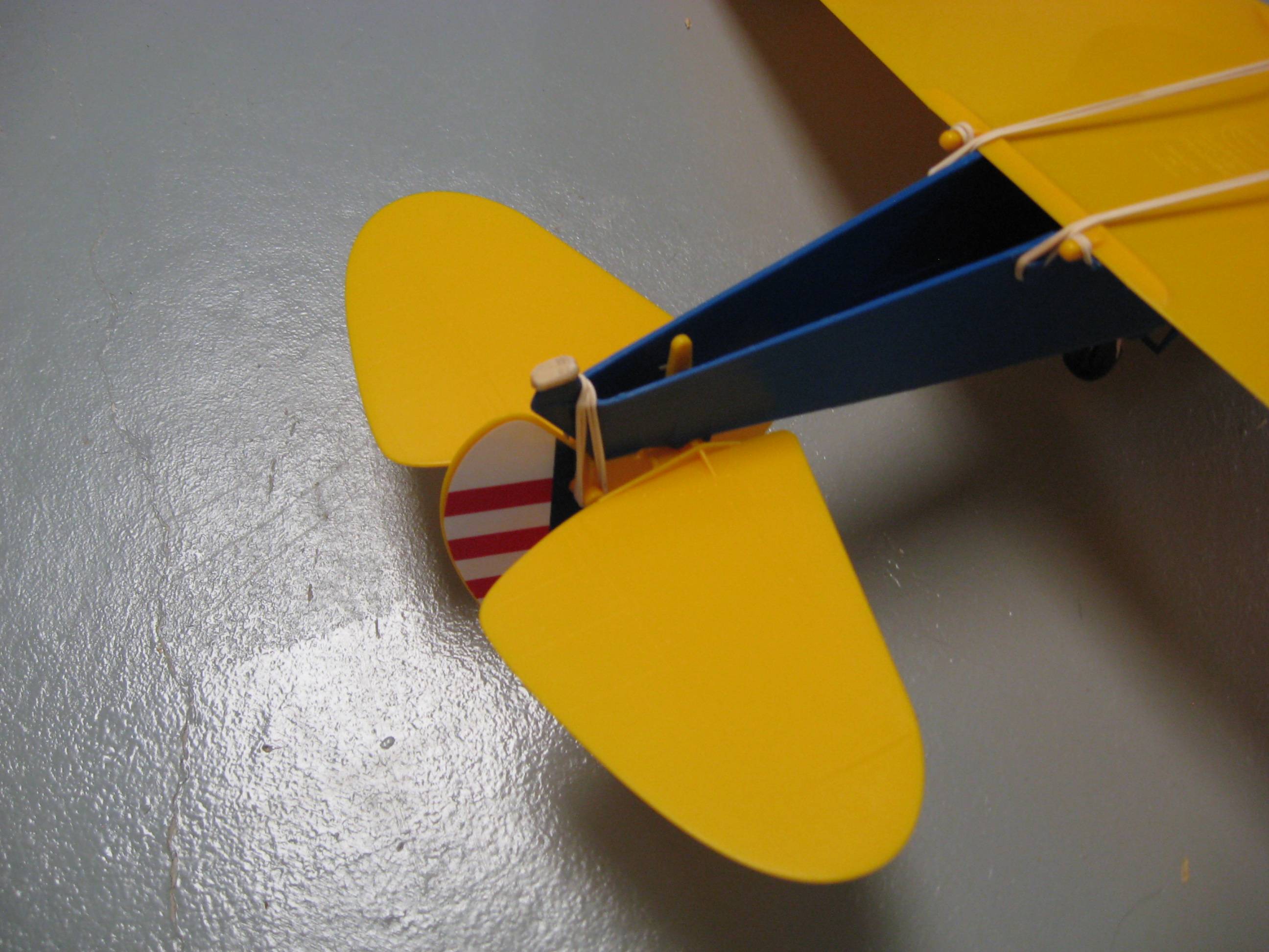

Thanks for the advice, John - I may fly the airplane as is since the stabilator horn has two holes and the pushrod is attached to the inner most hole which I believe gives more control authority (sensitivity). I would assume that the outer hole decreases throw even more. I just get the impression this latest rendition was an attempt to make the airplane impossible to over-control for the rank beginner. I'm concerned if there is enough throw to flare after glide to landing...
BTW, I'll use a Cox handle - seems I always used the outermost holes for all Cox models I flew - still may be regarded as a short handle?
I bought the airplane new and the bottom of the wing is stamped "Made in China" so I know it is a late, perhaps final, production product.

Actually you have that backwards at the control surface horn just like in RC the innermost hole will give you more throw, the outermost will give you reduced throw. I would suggest using the outermost hole on the elevator horn.

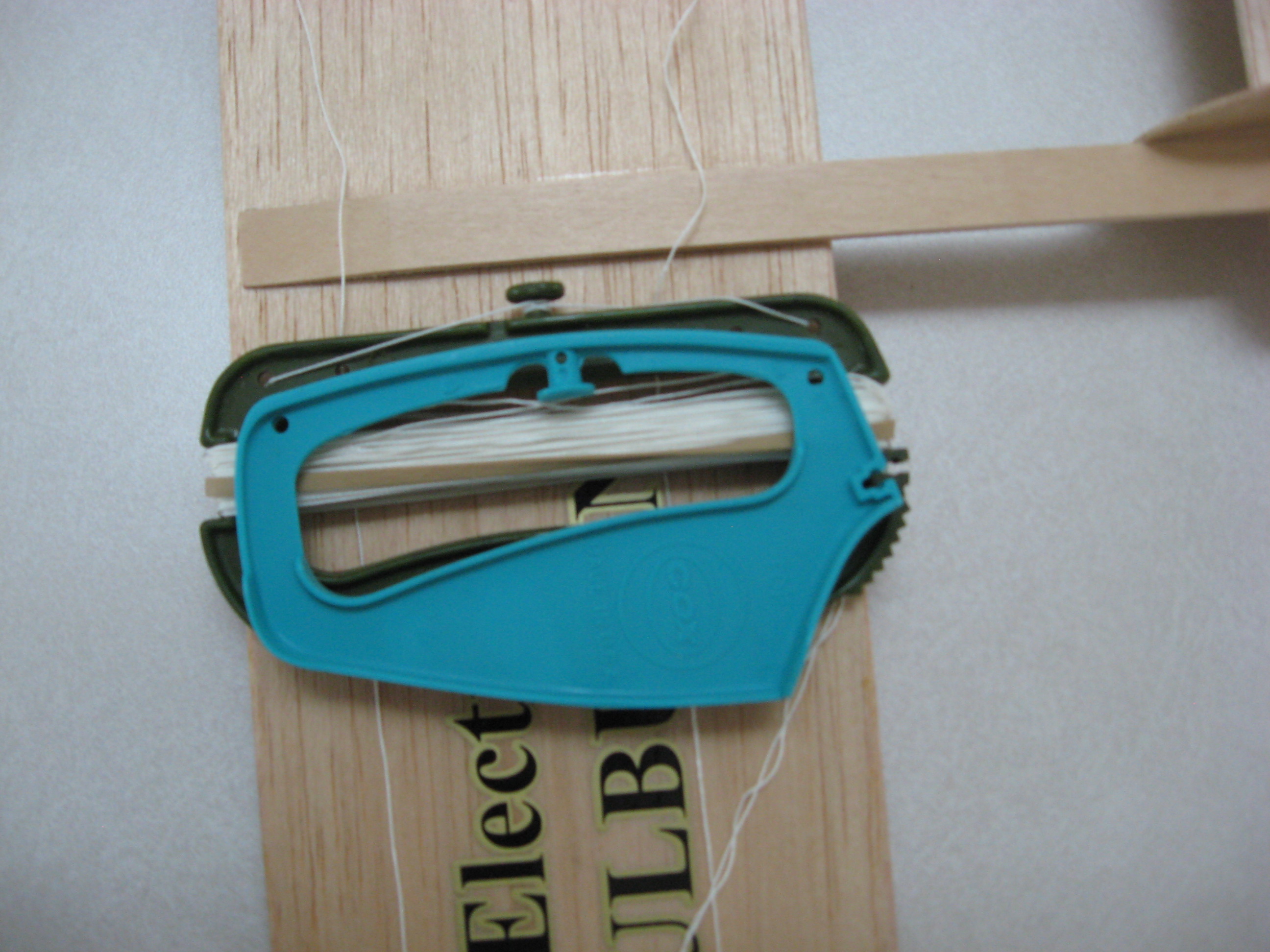

As for the Cox handles, Yes they all are short and there was a variety of them but most if I remember correctly had three available holes and with that stabilator I think since we are using centuries to describe when we last flew controlline I believe if it were me I think I would go to the middle hole.
At he handle the further the lines are apart the more throw at the elevator. It is as if your hand is the servo and the handle is the servo arm.

I used the handle equipped with the plane, and decided to use the inner hole on the stabilator horn to get the max control option - it wasn't clear in the picture on my previous post. The blue handle sitting on top of the older, green handle is the one I used, so there was no option at that end. I took off on a hard surface and flew over grass. I used full up before going off the end of the hard surface. Reaction to control input was sluggish but I liked the "heaviness" at the end of the lines. Before the engine quit, I was pretty sure landing would be less than graceful and considered whipping to get back over the runway. I decided to land on the grass and as suspected, could not slow the airplane with that amount of elevator travel. As soon as the airplane's wheels touched the grass, it was all over in an instant - Praise the Holy Name! Amen! No damage! Perhaps its no big deal but I still wonder if the older designs had more travel. Contrary to the videos I've seen of the PT-19 doing loops, I don't think this one would do it stock as is.
