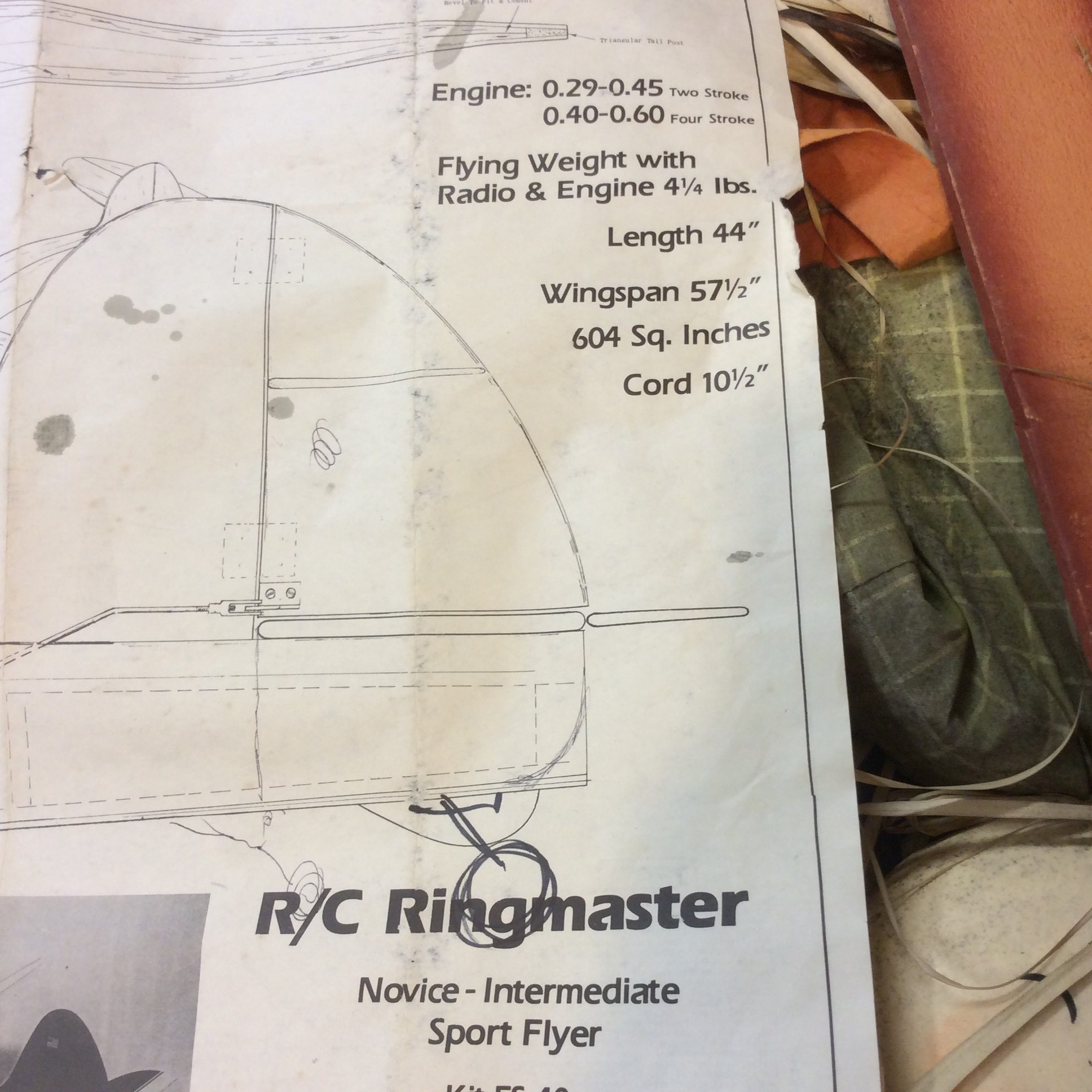

Just purchased a Sterling Ringmaster model fs 41 REMOTE CONTROL ( not u control)- would anyone know the point of center of gravity for this model?

On my fs-40 plan it shows 3 1/4" back from the L.E. The fs 40 is the kit. The fs41 is the Almost Ready to Cover kit isn't it?

the CG is usually 1/4 of the wing root cord width. The 3 1/4 inch that you suggested would make the wing 13 inches and my wing is only 11 inches. 1/4 of my wing width would be 2 3/4 inches. May I ask what the root cord width is of your wing?

This kit was originally designed around the sterling Fledgling. It was a trainer from I believe the early 70s. So the C.G. is more than likely back farther than needed just for stability. The farther forward the quicker the plane will react to pitch.
