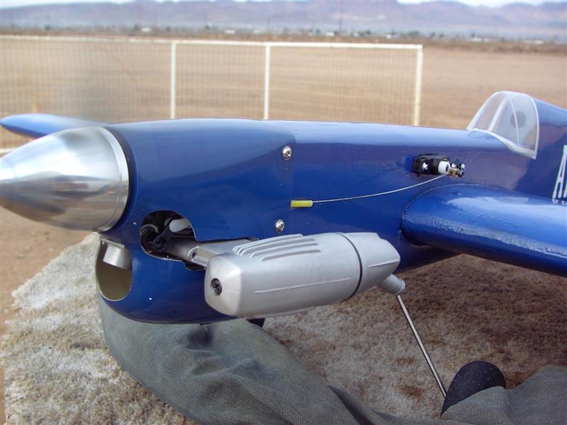

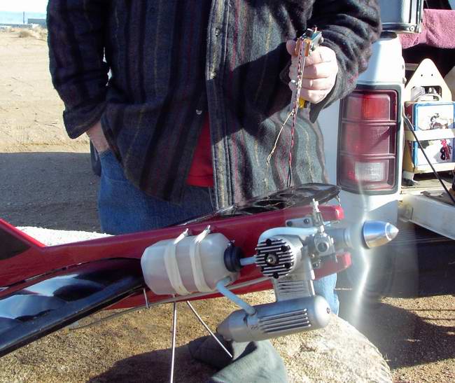

You mean something like this . The answer is absolutely no real detriment. Doing so works perfectly fine. I have helped a few each year set their airplanes up this way wth no problems. Actually since 2002 when I dropped into this wheelchair I thought I thought controlline was over for me and would be stuck with just RC. But I discovered the 'Bill Young' over the wire electronic throttle control and never looked back using only throttled engines. That system is dated now and currently use 2.4 throttle on all my controlline airplanes.
John
Name:	RingMaster A (2) (Medium).JPG
ID:	2084450   Click image for larger version
Name:	RingMaster A (Medium).JPG
ID:	2084451   Click image for larger version
Name:	nobeler 04 (Medium).JPG
ID:	2084452   Click image for larger version

OK CLB and Davey If I may please let me point out a few things about using RC throttled engines and the ways of actuating those throttles.
Using a throttled engine will allow you to perform maneuvers hereto for only just dreamed about. First of course the touch and goes that can be for an entire flight if you like and is a joy.
Next straight line taxi for any distance is possible. Yes before I was in this chair it was a joy take off and fly at one end of the runway then land and taxi for the full distance of the runway then take off agine on the opposite end. This can only be done with the over the wire or RC systems and it was a simple matter to walk along with an occasional tug to make small corrections and control speed with throttle. The old three line (or more) could not do this because of the intermittent slacking of the lines.
OK another advantage of using an RC engine is just as Mikeainia pointed out there is no need to stock and transport special fuels beyond your normal RC fuels.
Now lets talk about the control systems if you use a throttle (or more). I used the Bill Young three channel over the wire system for about fifteen years. It used a custom trigger grip along with other switchs and trims. This system at the time was wonderful for me and I love it however it does have problems that is endemic to any over the wire system. First that trigger which is what every body wants is for me a bad idea being difficult to make precision throttle changes while at the same time controlling the airplane. After all those years I still dislike a trigger grip for throttle.
The next problem of any over the wire system is first you need insulated flying line and the two electronic wires that attach to each end of the lines are a weak point and tend to get beat up and sometimes fail leaving one with a very long flight but not by choice. Set up of these special lines are time consuming although not nearly as bad as the old three line (and more) systems. I grew to dread the set up time.
Walla, the advent of 2.4 now is wonderful and we can use the systems freely and at our RC fields if we desire. Setup time is as fast almost as just flying ordinary two line and I do not have to use that pesky trigger grip. There are no wires to hook up with plugs.
I use an elderly Hitec Prism 7X with 2.4 module with a matching receiver and a HS 81 servo to actuate the throttle. The power is four cell 270 mah pack that is quite small and seems to last forever.
On to the best part I did a small mod to the Tx and bonded two hooks to the sides of the unit about where one formerly would have gripped the trx. Then just using an ordinary neck strap the tranny is worn around my neck and hangs in front with the sticks pointing toward the airplane. Using my left to fly the airplane its far easier to use my right for the throttle stick. .
I will try to get some pics up in a few.
John

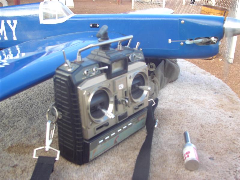

DaveyMo
Here are a few pictures that show how I use the conventional two stick RC transmitter (it can be either mode two or one) worn backwards with the bonded clips. Even if I were not in the wheelchair I would continue to use mostly throttled engines and 2.4 for control:
John
Name:	Concrete 2 (3).JPG
ID:	2084728   Click image for larger version
Name:	Concrete 2 (12).JPG

One of the problems with the pistol grip set up is the weight and shape either above, below or in front of the handle and I can best describe this aspeed by comparison with the old Jim Walker UReely which I am sure you know was somewhat ackward with its mass considerably forward.
What I fround works best in my years with the Bill Young pistol grip is to simply keep the throttle nailed as if there was no throttle during all maneuvering and pattern stuff. Only reducing power for slow speed stuff, touch and goes etc. It is during this slow stuff that precision throttle positioning becomes most difficult with a pistol grip.
Now with the 2.4 tranny on my neck this difficult throttle positioning is very easy and far more preferable. Also I do not keep my free hand continuously on the throttle, not necessary and not needed. So yes the chair flying is possible and practical while stil multi tasking with the free hand. I have had a considerable number of flights on a Kaos, Magician and a Jr Ringmaster over the last two years using 2.4.
For whatever reason my Magician by going inverted and up to a 45 degree angle to increase the rotation speed will by using my free hand to lock one wheel and raising my good foot will spin me until the tank is dry or my arm becomes exhausted.
John

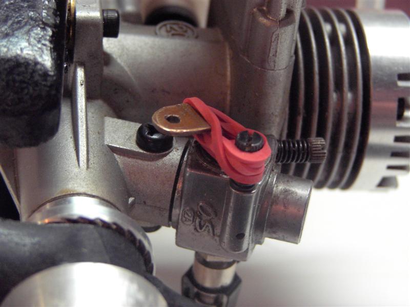

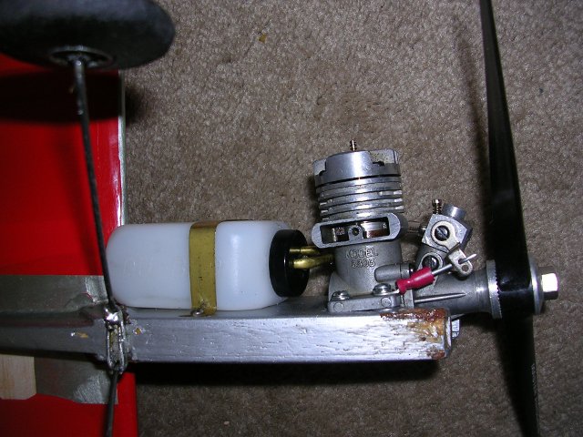

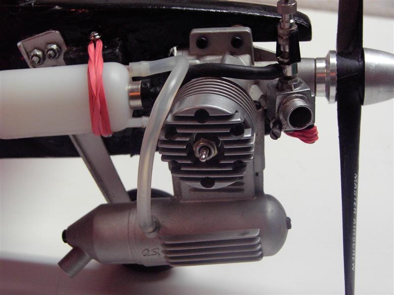

Regarding RC engines on CL planes, I found that RC engines work well.
I replaced the OS Max 15FP-S and 8x4 Masters prop with an Enya 15-III TV and 8x6 Masters prop. With throttle wired wide open I found I was getting the same lap speeds. The plain bearing Enya cross scavenge HP peaks out at a lower RPM than the sport Schneurle ported OS.
These Enyas are powerful little rascals.
Name:	RingJr Enya 15-IIITV Above.jpg
ID:	2085726   Click image for larger version
Name:	RingJr Enya 15-IIITV Below.jpg
ID:	2085727   Click image for larger version
Name:	RMJ w-Paint Touched Up.jpg
