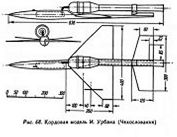

I am primarily interested in the attached delta-wing speed jet plan (upper plan) which is reportedly in the book, but all I have is this miniscule, illegible copy. A Xerox copy or a scan would be great, but I could buy a book if someone has one available.

Kirk,
Just another thought, When I magnify the Scale on the forst drawing, it seems that it starts at zero, then 10, 20, etc. up to 100mm.
That would make the "nose" length 100 mm from it's tip to the intersection of the two leading edges.
How does that fit with your expectations?
Ray
Ray

Ray;
Your magnifying resolution might be better than mine. I was thinking it might read 30mm from the nose to the LE, which might put the plane length at around 100mm. It looks like the wing cord is two-digits and reads 30, but I could very well be wrong.
I am not dead-stuck on this design, but it is difficult to find any deltas or semi-deltas that do not use the 34" long Russian engines with the fuel tanks integral in the front engine cowl. In the USA, it seems like the deltas never took hold and were deemed as too heavy. I am certainly open to any other designs out there.

id the pulse-jet it's self is 34" long can't you just scale the aircraft accordingly?
Ray
Kirk,
I'm guessing that you've found the online image at:
http://rocketsciencebooks.com/books/russian-pulsejets/
When I enlarge it, the scale became a little clearer.
Accordingly the scale shows that the nose is 300mm long and the maximum wing chord is 250mm.
It should be easy to scale it up given these dimensions.
Regards Ray.
Regards Ray.

Hi Ray;
Wow...nice job tweaking the image! Many thanks for your help!
This should be easy to modify to the right proportions. Will still look for the book though; some of these 1950-60's Russian designs intrigue me.

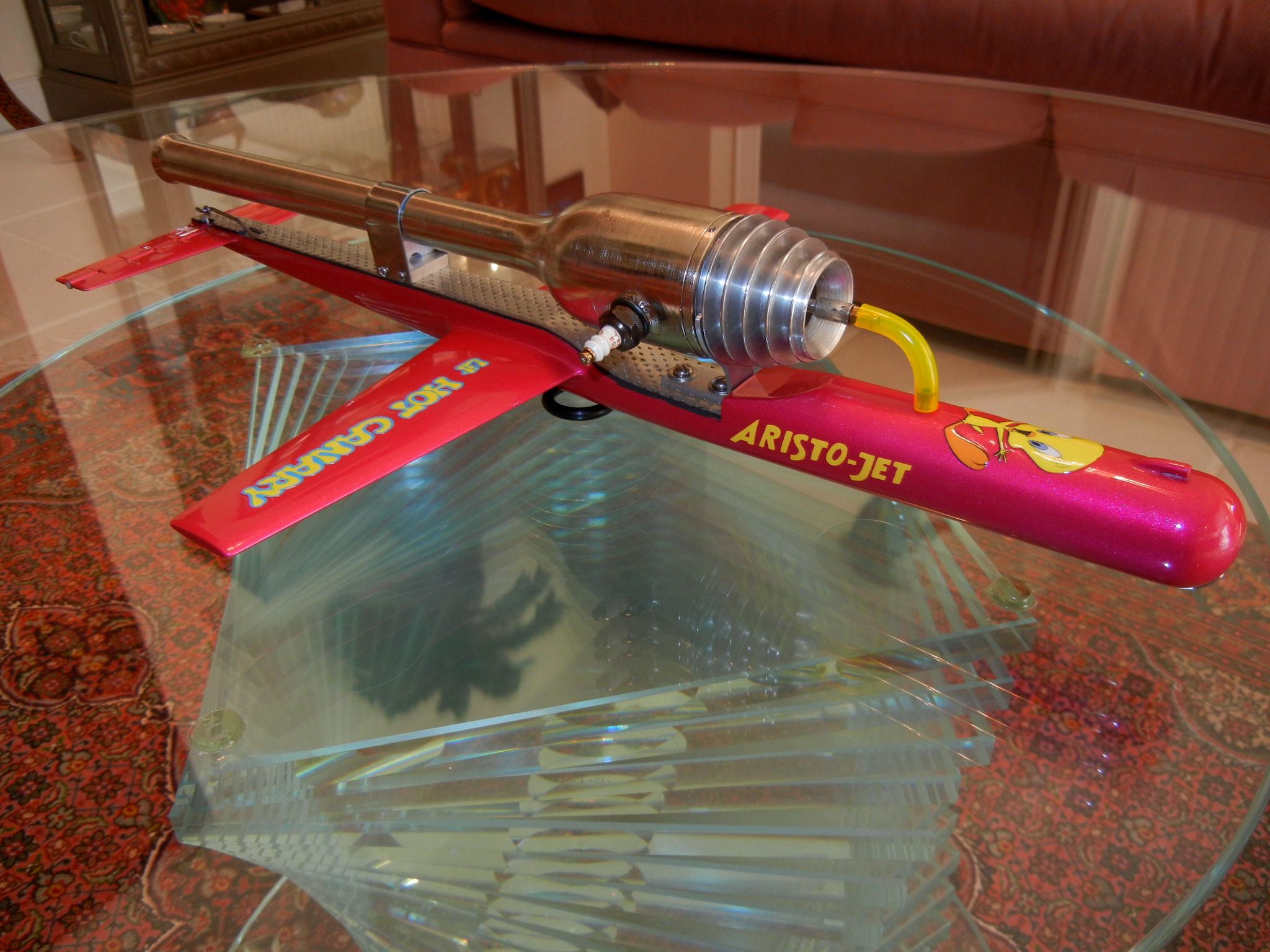

Here is my 10" wingspan Lil' Hot Canary with a 13" long, 1955 German Aristo-Jet engine, the same company who made the Hurrican-Jet. The pink color is a tribute to a friend's full-size H.C. t
hat broke loose in 1962 and tried to fly through a metal chain link fence.
