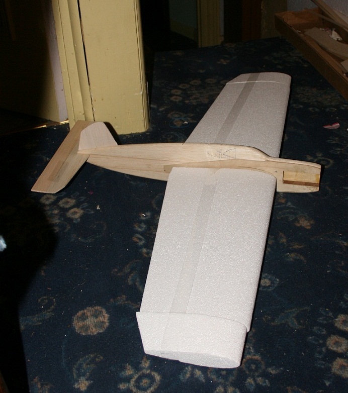

Looks very good! Nice cutting...
Are the panels passed through the fuselage? Is there a 'joiner spar' between them?
I see tape about 2/3 back from the LE - purpose? (I have used fibreglas reinforced tape on the underside of glider wings to improve stiffness against flexing under launch loads...)
How do you plan to cover the foam surfaces?
Like the Ukeys and a few Aussie designs, the bellcrank can be mounted externally with only some effect on the flying. Nice and simple.
Keep us updated?

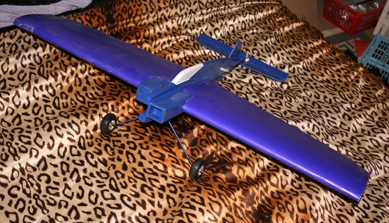

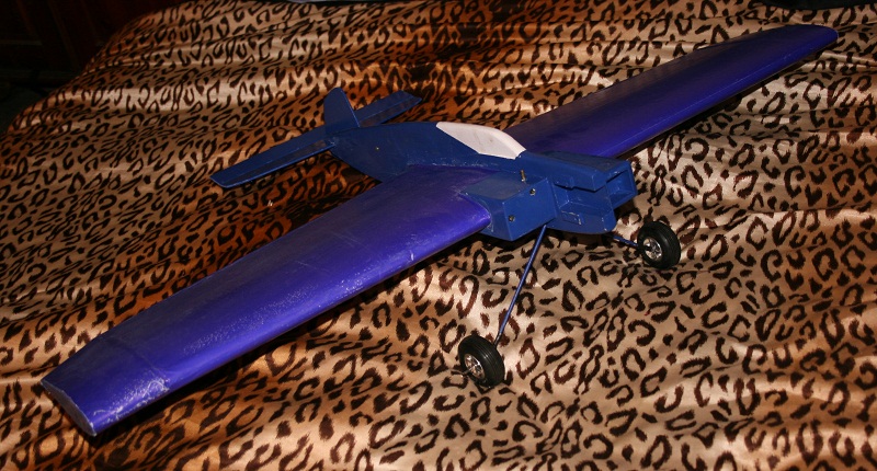

It's not one of mine - from a Pete Tindal kit.
It's not tape - can't remember what it was - it has an internal spar.
Whole wing doesn't pass through the fuse just the spar the wing is butt glued to fuselage.
Covered with blue wrapping paper.
Has an OS Max 25 for power.
Annette
