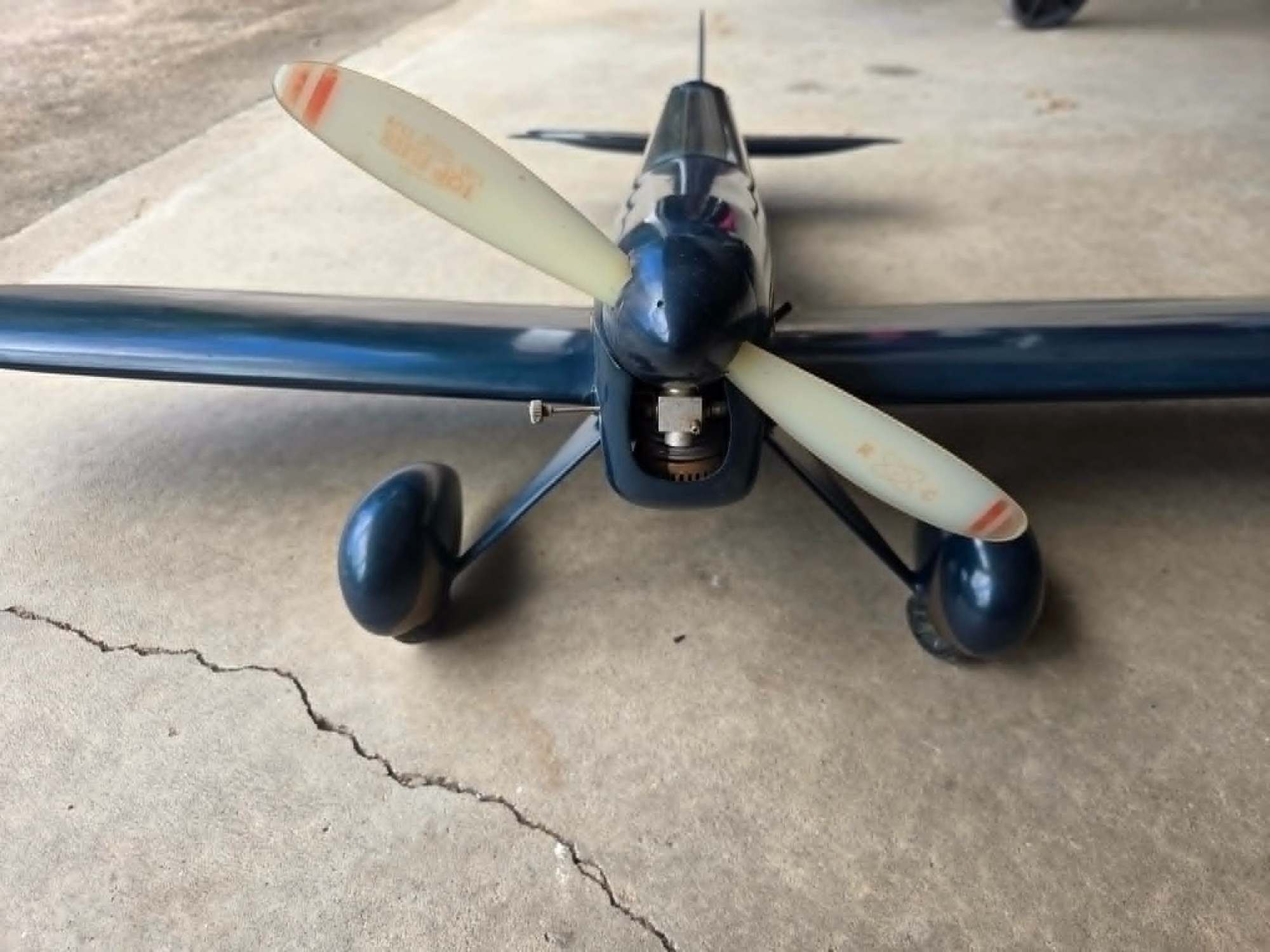

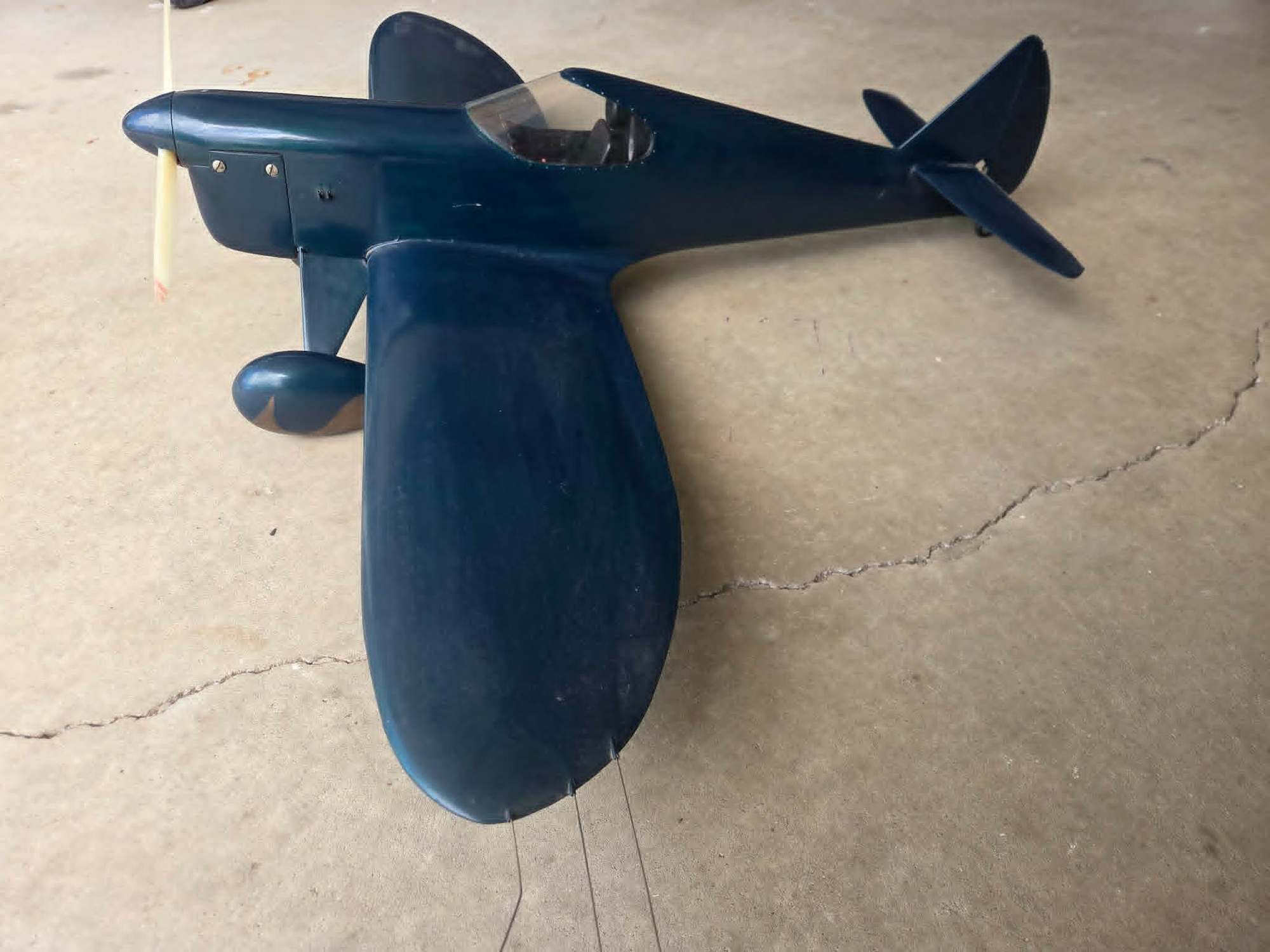

The blue/green one has three wires extending from the port wingtip versus the typical two. Would the third wire be for a throttle control?

The blue green model appears to have an RC carb on the engine so some sort of throttle set up is probably a good guess. Wing spans and engine brands/ sizes would help for looking up the models. Which side of the Atlantic you are on may also make a difference as there were different companies selling kits on either side of the ocean. I ask because one of the engines is a diesel. They aren't unheard of in North America but are much more common in Europe.

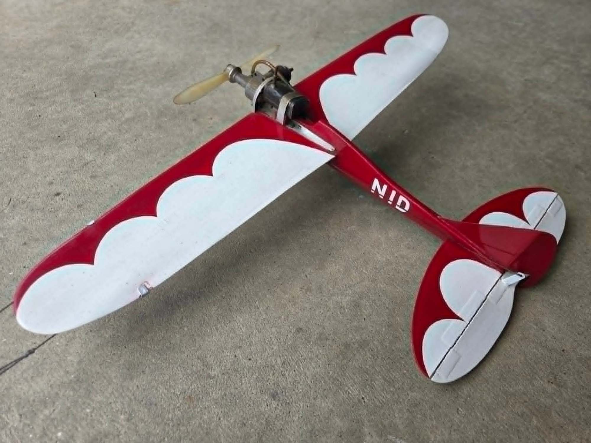

The red and white airframe:
Wingspan: 19.5"
Length: 12"
Motor: OK Cub

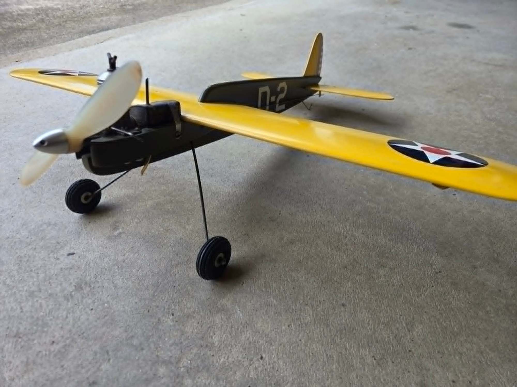

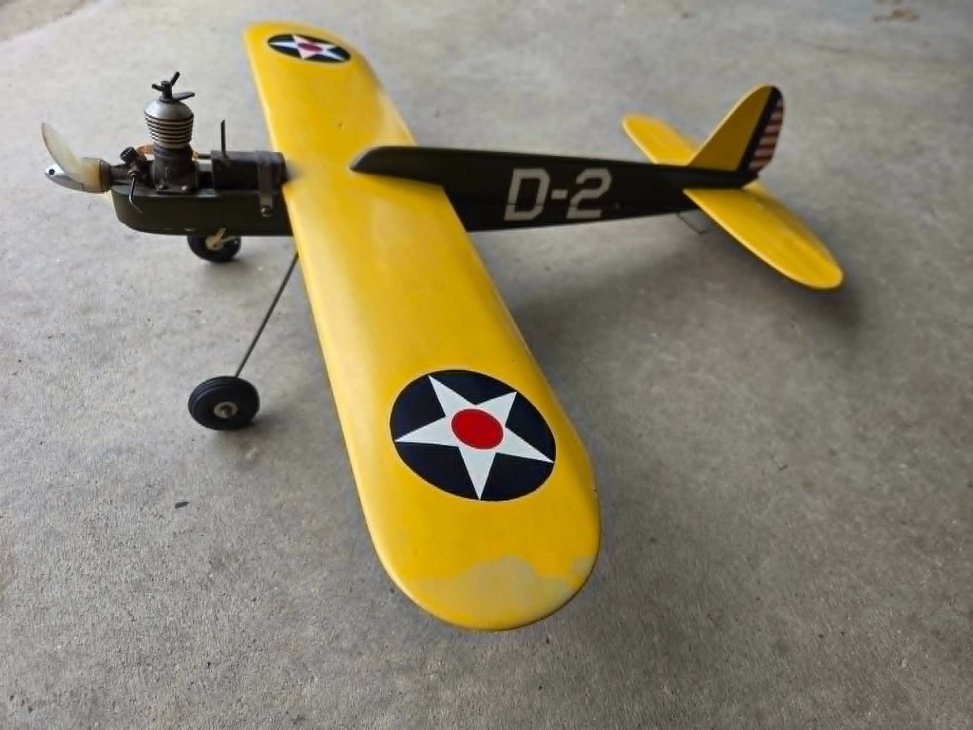

The USAAF plane:
Wingspan: 23.75"
Length: 19/75"
Motor: Webra 1.5
Blue/Green:
Wingspan: 42"
Length: 31"
Motor: It looks like it says ORONE in raised letters in a vertical line. It also had the number 6730 stamped on the engine block which I assume is a SN.

The red and white plane is probably a Jim Walker Firebaby that has been repainted. The plane in the USAAF marking is probably a Testors Freshman 9. I'm drawing a blank on the blue green plane. It could be a scratch build or a modified kit or even just something I haven't ever seen.

Thank you so much for the additional information Matt. That gives me a good starting point to do some more in-depth research. The blue green one is completely sealed up. The only thing that's removeable is the engine cowling. The entire wing and fuselage is sealed so if there are any repairs to be made you'd be out of luck without a major structural rebuild.

There was a "Drone" brand of engine where the stylized D could be mistaken for an O but they were primarily diesels. They had a distinctive cone shaped cylinder head. As far as the green plane being sealed up that is the way is was usually done. No radio gear to access, small enough to toss in a car in one piece and the control line gear really didn't need much maintenance.
