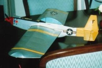

Edit: Trying to include a pic, if it works. The lower one is stock with a baffle Fox .15 and the upper one is with extended wings and a TT 10.

Thanks for the picture- looks like a sort of way-overpowered biplane in the thumbnail!

Is the main (dis)advantage of the larger wing slower flight? Tighter turns? They both look 'right' to me..

The lower plane in my pic has a Fox .15X with muffler. The upper plane has a TT .10 with muffler...probably about the same weight and power output.
George
