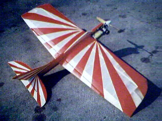

I am running an Enya 35 on the original Flite Streak and have no problems with vibration. It does go fast but it is a good trainer and agood slow combat plane. 60 foot lines. Also have a super streak, 47 in span scratch built from Jan Rummery plans. Silk and doe finish. 60 foot lines with a fox 35. Areal solid plane and very smooth. Hope the picture shows up on this post.

I saw you with this down at Sig. Any news on commercially producing it?
