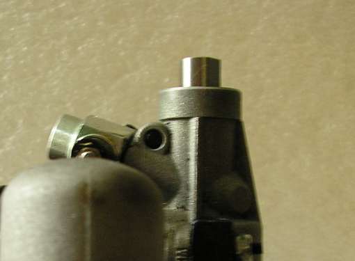

Yeah, turns out is is a big mig.
Got this guy as-is, and I'm wondering if this is a serious or minor prob. You can see, from the attached snap, that there's something broken off, where the prop attaches.
What I'm hoping is that this is only the retainer nut that's severed, and not the crankshaft itself that's broken.[img][/img]
Engine still turns over and has good compression, so I'm thinking it's maybe just a job for an "easy-out."
Can y'all tell?

The .25 uses a replaceable prop shaft that is reversable -- you can screw either end into the crankshaft, depending on the thickness of the prop hub. The shaft is a standard M6x1.0 so you can simply replace it with a stainless or alloy socket head bolt or find a piece of M6 allthread if you want to use the original propnut (locate a M6x1.0 fully threaded bolt and cut off the length you need). The engine probably has taken a pretty good whack to break the shaft, so you might want to check runout.
If you want to stay original, get a propshaft from [link=http://www.norvel.com]NORVEL[/link] or [link=http://www.sigmfg.com]SIG[/link]

Thanx, Andrew, for the tip--and for the actual pic. Did find this article at SIG--though it didn't come with your handy pic, so I wouldn't have known it included the the nut--or maybe it doesn't?
Also looks as if the rear hub is missing.
And yes, I was trying to imagine what kind of impact it would take to break the shaft like that. I've crashed a LOT of planes, bent cooling fins and needle valves and such--but I've NEVER broken a prop shaft.
First thing I did was pull the plug and slither a little Marvel Mystery oil down into the head, then carefully turned the crank. No binding, and with the plug back in, compression feels good, so I'm hopeful the crank's not warped.

The shaft and nut are sold as a set, part # NVL401211 for your Big Mig. The rear prop hub for the Big Mig is NVL400322.

I don't know if they changed it, but the original prop stud was kinda brittle. Broke a bunch of them just by overtightening. Didn't help the ones I didn't snap then by running them into other peoples airplanes. The Stainless bolt won't snap so quick. Used a BigMig in SLC for a while last year, did have the carb idle screw all the way in, but that wasn't keeping it all the way open, so I pushed the throttle open and bent the metal arm over so it don't close no more.

Yep, you can see from the attached pix with the original note, that bolt's snapped off in there. I'll bet the original owner over-tightened it, piled it into something, and it broke. And it musta struck dead head-on to the prop shaft, 'cause, otherwise, the motor looks brand new. Not a scratch.
