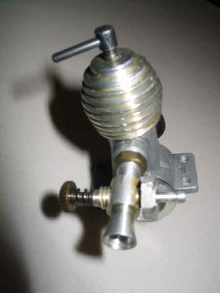

For the Mills 75, I only removed the fuel bowl. The needle can be revolved to point the spraybar outboard whether upright, inverted, or sideways.

Here is a rear-end pic of the India Mills 75 that I converted to CL.
