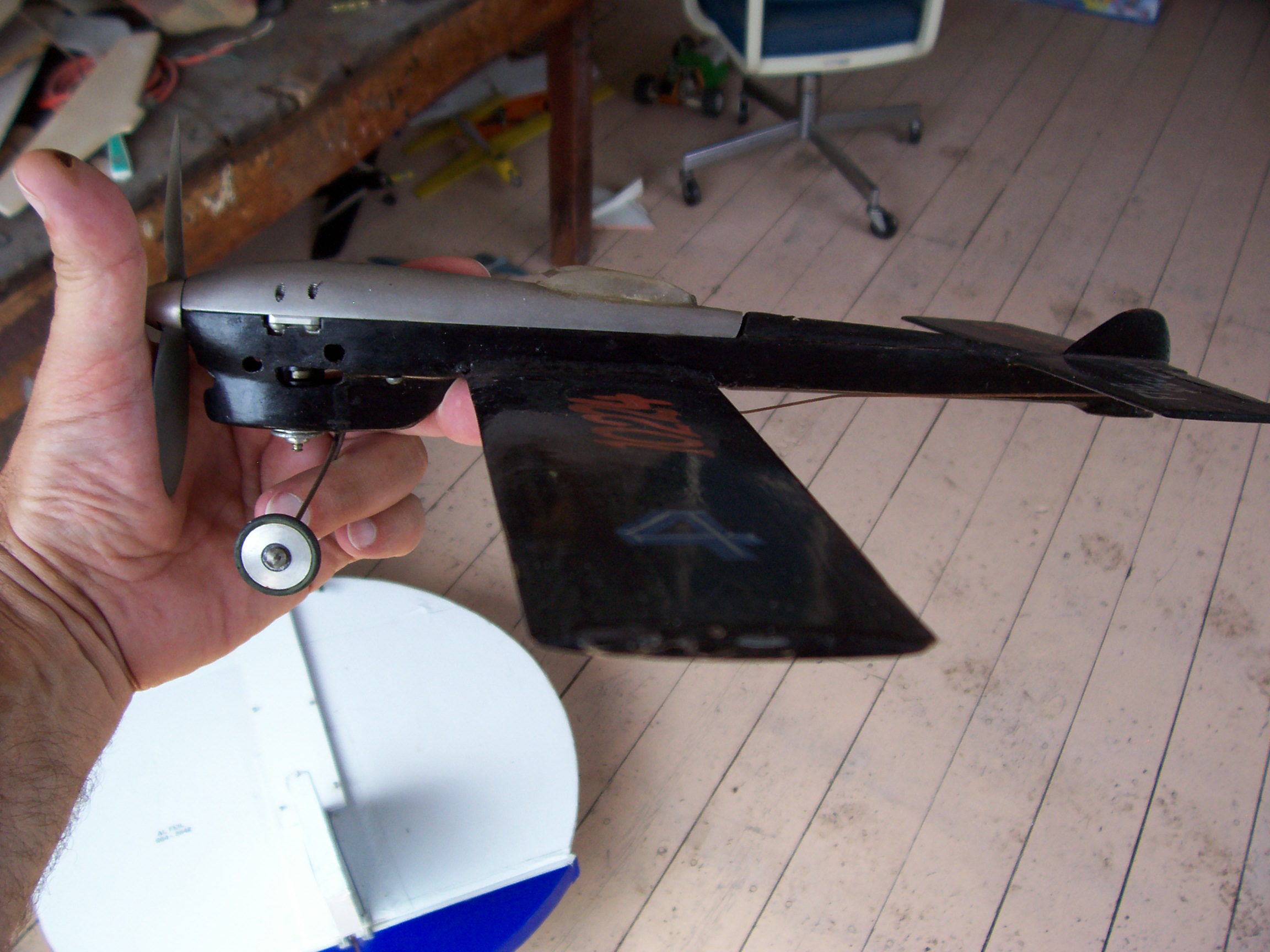

PS This is the current state of my C/L program - a leftover Guillows Trainer from the 60's I recently got in an estate sale.
The one thing going for it is that it was built by a NASA engineer, so you know it has to be good.
I have a ways to go.

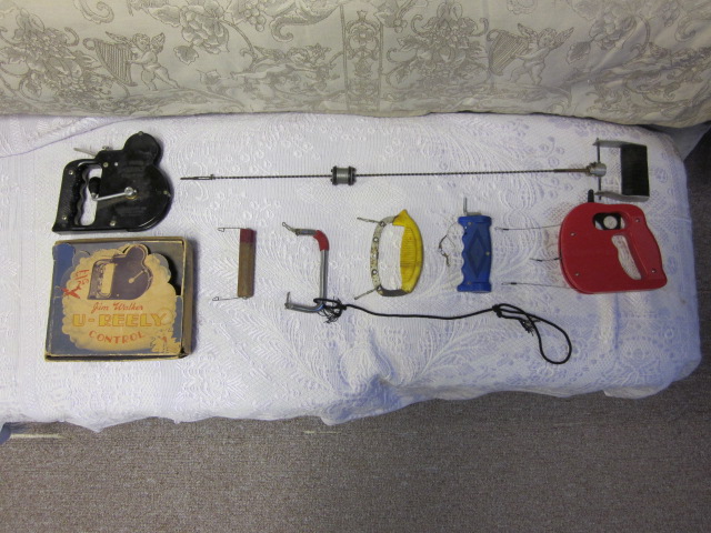

Hi aspeed, both the video and photo help to get an idea bout these monolines.
The monoline handle you have in your photo, you use one hand on the handle and in the other you hold a string ?
I take it you spin the bobbin by pulling the string, and that gets transmitted to the plane?

Your Model shown fired up my interest. What size engine is on the plane? It looks like a McCoy bluehead R/C.
Orv.

Do I understand you correctly. You took the standard .014" solid control line and anchored it at the end of the outboard wing. Then at the fuselage you attached a horn, which is connected directly to the elevator horn by a pushrod, to the line. You then passed the line through a leadout at the end of the inboard wing. If I am correct, this system doesn't have the transmission ratio that the commercial units have using the helix or the worm gear and only needs a small amount of twist to effect control. This would mean that the line between the anchor at the outboard wingtip and the horn at the fuse. acts like a torque rod wanting to neutralize the control.
If this is the way you provide control, it is very simple and clever.
What is the down-side?
Do you have any data relating to how much twist per foot of line is needed to give you say +/- 30 degrees of "horn-on-the-line" movement on a plane with a 2 foot wingspan?
I ask because this seems like an interesting project to do experiments with the mono-line idea.
What I imagine is that if you don't twist the line to follow the pitch-up or down of the model, the elevator movement would be effected by the pitching action. This brings up a very interesting condition. You could arrange the control setup so that the model would have automatic pitch stability control... when the model pitches down, the elevator goes up... in other words, a mechanical auto-pilot.... Cool!
I wonder why Stanzel didn't use your system.
Please let me know what you think.
Orv.

It does have a blue head, just checked. It's a .19 and has an exhaust baffle.
Now, I would tell you this plane doesn't mean much to me but I was hoping someone knew what it was.
If you are interested in having it, the major obstacle is shipping costs for this solid pine airplane to Saskatoon.
If you're interested in having it let me know. Something like this plane I prefer to have it in the hands of someone that it matters to. I was hoping it might have some N-factor (Nostalgia) for someone.

Your model did raise my N-factor. At Air Cadet camp in 1957, I purchased a McCoy 19 C/L engine and a Guillows trainer like you have. Up to that time I could only afford 1/2A motors and planes. This was my first "big" outfit and a pretty proud moment. I built and flew the model at the Camp. It is a good trainer and a good starting point for you in C/L.
I am however not going to take you up on your kind offer since I am already loaded down with engines and planes along with sliding into home plate age wise... but thanks.

Bright Garden, to your #32 (or was it #33?) - The handle at top right in the post #30 photo of several handles looks like a mono-line handle.
The long 'wire' with the bobbin in the middle is actually two solid wires twisted together along their length. The bobbin has a slot just wide enough to fit the wire diameter, and just long enough to fit the pair of them. At the handle end, the wires run in a bearing that can withstand the model's pull, yet let the bobbin rotate the twinned solid wires..
As mentioned above, the end of the flying line is formed to loop like the eye of an oversize knitting needle. The AMA Rulebook has good illustrations of how to make and use this kind of connection. Visitors to the AMA website can have access without joining as members. (I consider membership worthwhile. A personal thing...) A split bead or very small bobbin connects that wire to the controller.
Remember - you hold the bobbin from rotating, and slide it towards you or away to make it rotate the twisted wire pair to put turns into the flying wire. THAT'S what turns the 'cam' unit at the model. (As mentioned, consecutive loops have the same effect as sliding the controller bobbin. You can let go of it to spin it along the twist to restore neutral where you want it.)
Mono-line is most useful for speed models. The 1/2A model with the metal pan looks like it is for the "Proto Speed" event. Nice decorations on the decoration, no?
The black handle is the traditional U-Reely. It and the smaller ones in the middle require your lines to be closely matched in length. Adjustment for a comfortable neutral is limited. The yellow handle with a flat metal plate does allow some adjustment.
The large handle on the right is a 3-line unit that can operate a throttle. The "science" of that is fascinating! The trigger and the lever out the top are connected, and operate the other function. The top and bottom lines are for 'elevator' control. unless you really need a throttled CL model, fussing with 3-lines is a nuisance. The standard 2-line setup is much more natural feeling, and easier to hook up.

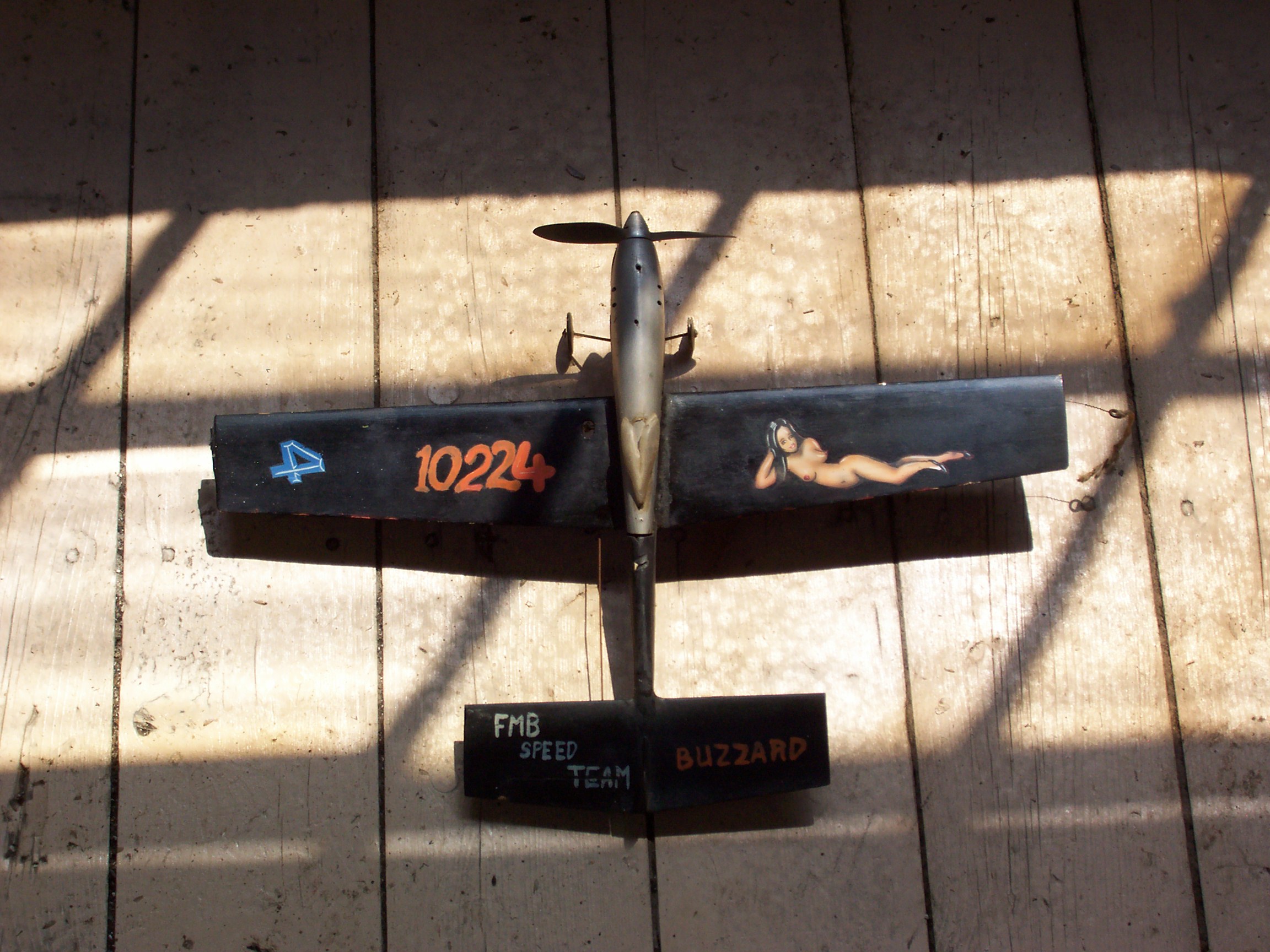

340 kph is around 211 mph I think. Pretty quick. This was likely an earlier attempt at the 'unlimited' FAI record www.youtube.com/watch?v=u0MN6NHChZI The older AMA D speed which was a .65 cu in. limit was hitting 200 mph when I was a teenager. Nitro was allowed as well as a pipe. As soon as 200 mph was hit, the pipe was banned. Then it hit 200 again, and 10% fuel was the new rule. A piped .61 would be fun to try on nitro again especially if you could use a thin monoline. There are surely better motors now than in the 1970's. I would want some control when going fast. The planes oscillate with any breeze and the planes hit hard at over 150 mph, been there done that. The parts scatter.
