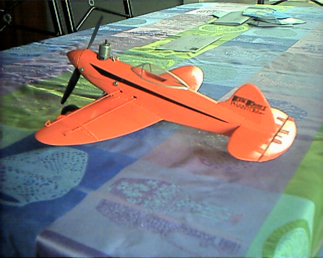

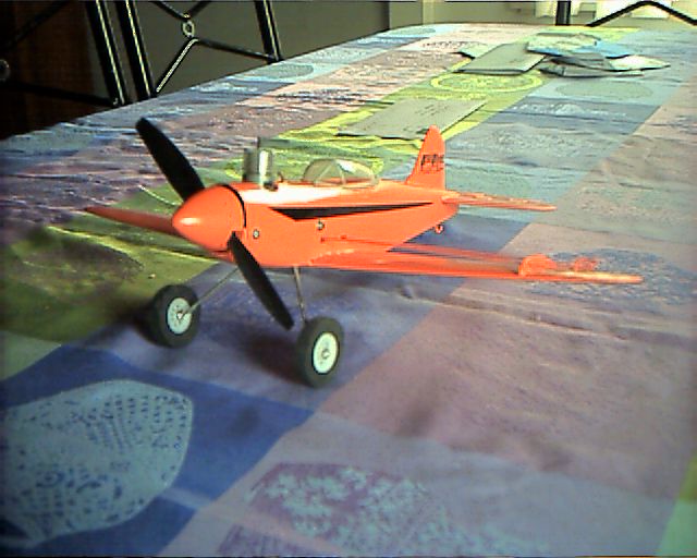

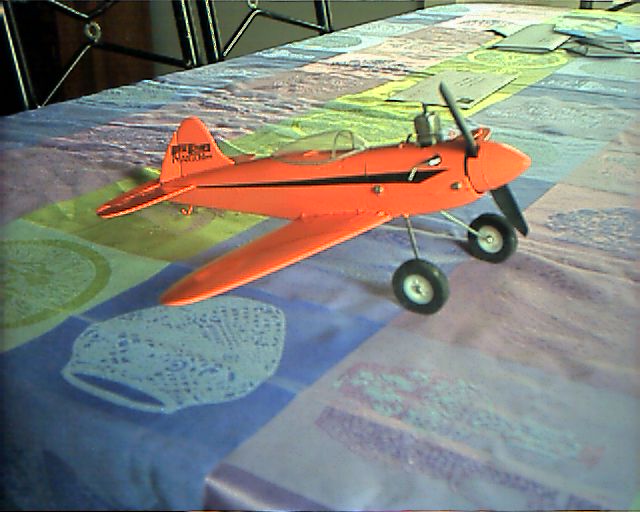

I've just finished this 50's Keil Kraft Phantom Mite. 16" span, DC Merlin 049 diesel powered. Just a bit of fun, and helps use up some of the scrap balsa stockpile................John

Nice!!!
Looks like a lot of fun.

Looks great John. Will be waiting for flight report.

Now that's CLASSY!!! Alot of guys don't understand why some one would build something like that but man, what fun!!

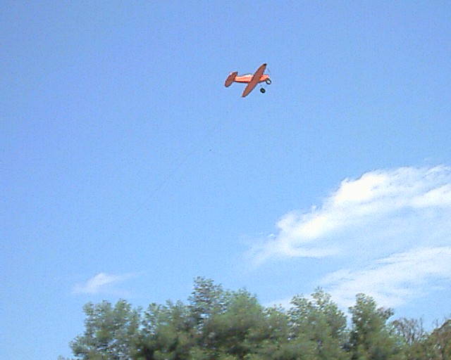

I was doing some flying this A.M. and my pal took some snaps of the Phantom Mite, thought I'd share 'em with you........John

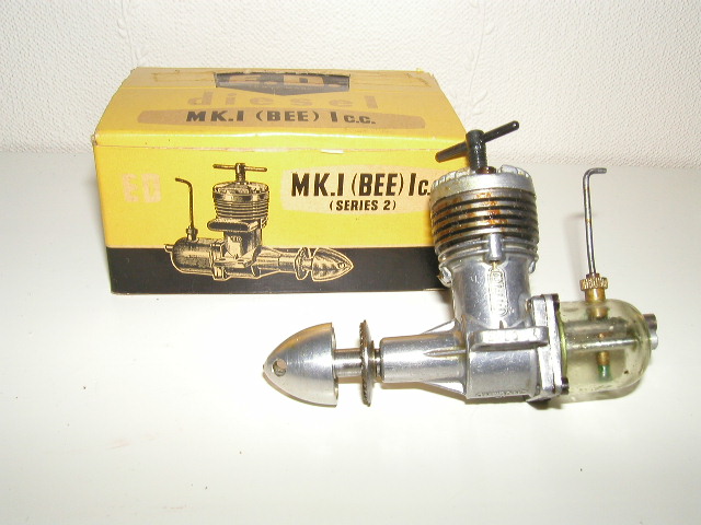

Hey, i has plan of Keil Kraft Phantom and the engine at the plane are 1-1.5 cc diesel. I copied the plan from the book "Control Line Manual" by R.G. Moulton who i won in EB..Y in last week.
I begin to build the Phantom, and i has unused and NIB ED Bee MK.1 serie 2 showed as in the plan.
The plane can make wing over and loop..
Here are the pic with plan. Hope it is possible to resize plan with Isiplot.. Wing span shall be 21" with Isiplot, resize with "Caliber Raster" from wingtip to center of wing,then hit 10.5". All are ready to print in right size.

Vauxhall, i can see your plane has cowling over the nose and fastened with screws, are the material made of thinn aluminiumsheet or thinn steelsheet?
I think it is better with sheet over the nose instead build up balsablock over the nose and make difficult to take out the engine for cleaning..

The top cowl is made from thin aluminium from a drink can. Lighter than the wood version, doesn't cost anything after I had the pleasure of emptying the (beer) can. As you said it's attached by 4 small screws and goes back past the fuel tank. I did the same thing on my 22" span Phantom. Here's the Phantom Mite with the cowling removed showing the semi circular fuel tank and the DC Merlin...........John
