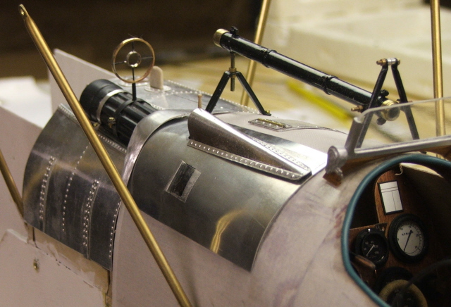

I've been working on the access cover for the Vickers. I thought about vacu-forming the parts, but since I've never done that, I just stuck with aluminum. And, besides, aluminum looks so much like...Aluminum!
The air scoop over the gun was used by American squadrons for extra cooling.
I also remade the front sight out of brass tubing and wire. The old sight looked ok, but was plastic and flimsy. I was affraid it would blow apart in flight.(I really do intend to fly it)
Steve
The air scoop over the gun was used by American squadrons for extra cooling. I also remade the front sight out of brass tubing and wire. The old sight looked ok, but was plastic and flimsy. I was affraid it would blow apart in flight.(I really do intend to fly it)
