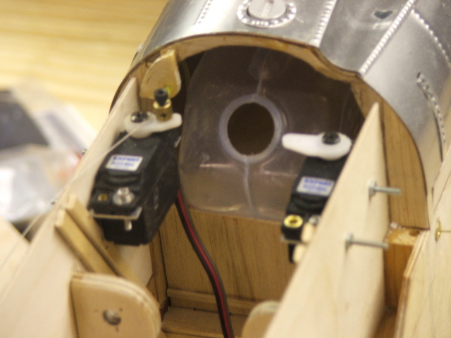

I'm just about finished with the engine compartment. I decided to put the servos up front for the throttle and bomb drop.I put a baffle behind the engine, slanted down to the scale baffle. This should help direct the air flow down and out. It also forms a compartment for the servos. I put the on off switch,the charge jack,and the remote glow plug conection in the radio compartment behind the cockpit. I still have to find out what size tank to use. It shouldn't take too much for a 9 min flight.
Steve

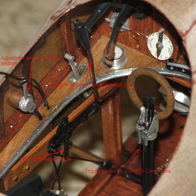

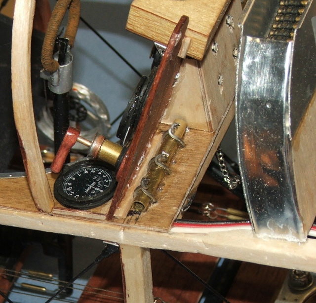

I finished a couple of cockpit details. The trigger cables for the Vickers & Lewis guns are black phone wire, attached to the triggers with 1/16 aluminum tubing. The copper "tubing" for the synchronizing gear is 14 gage copper wire. The bomb release and shutter lever are patterned from pics of the French #3 cockpit. Now all that's left are the magneto, and mag switches, and the cockpit will be finished.

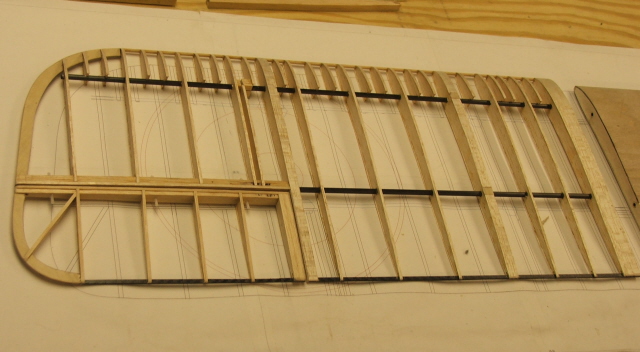

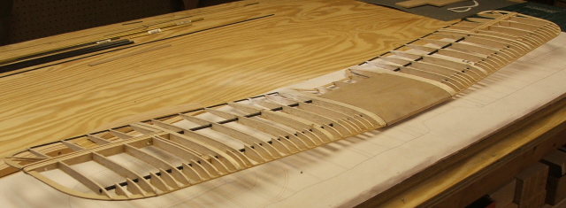

I finished up the top wing this morning. The cabane is sheeted with two layers of 1/64 ply. The sections are joined with 1/8 music wire, bent to 5deg. for dihedral. The brackets on the bottom go around, and are soldered to the brass spars.
Steve

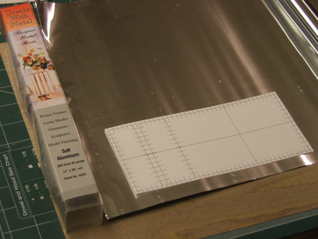

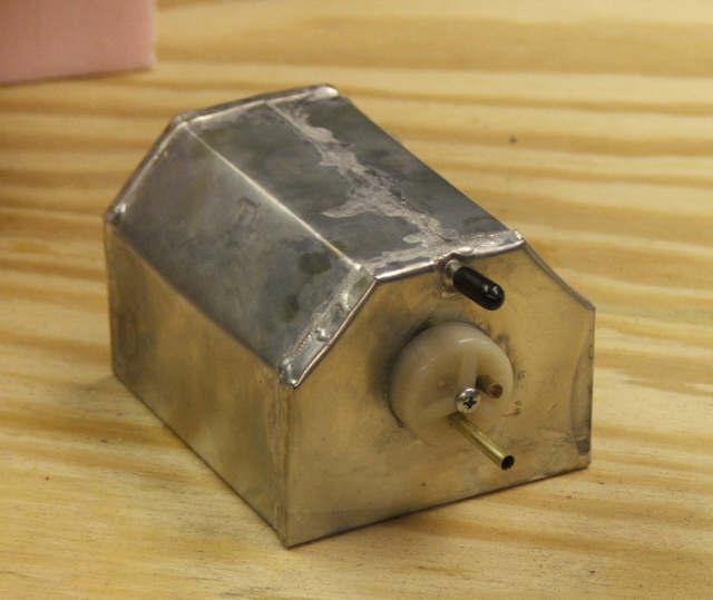

Hi, Tim. Thanks . If you go to the R/C Scale forum, You'll find a more in depth thread on the build. There's a lot more interest in the R/C side.
Today I did the " wing tank". The leading edge of the cabane is a tank on the full size. It's divided so that about two thirds holds gas, and one third is the expansion tank for the radiator.
I simulated this by punching " rivets" into a peice of .005 soft aluminum, and laminating it to the sheeting with contact cement.
I'll post a thread on how to do the rivets under R/C Scale How to's.

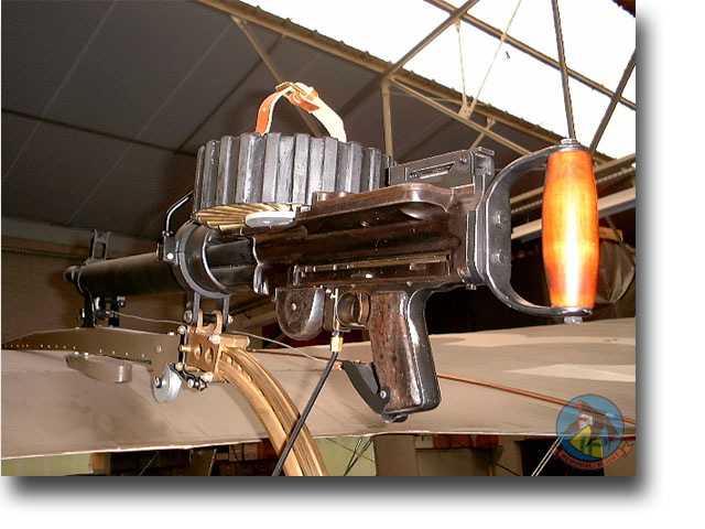

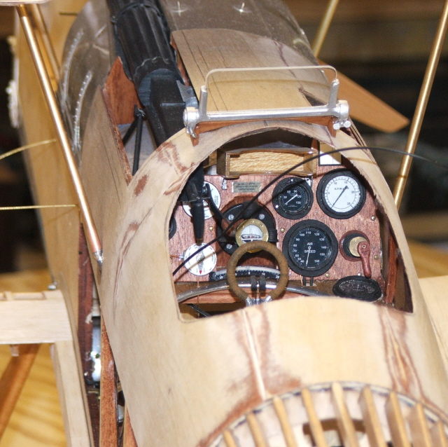

In that picture it shows the wire, cable, or rod what ever it is that goes to the trigger of the machinegun.
Do you have a clearer picture of that ?
I dont fully understand how the cable or what ever it is pulls the trigger or attaches to the trigger.
Yes and that picture just flat looks like a real plane.
SEEYA, TIM
Old 01-29-2007 | 09:06 PM
  #62
smcouch77's Avatar
Joined: Oct 2006
Posts: 712
From: Indianapolis, IN
Default RE: SE5a 1/6 Scale
That is a picture of #904. It's the only original SE5a that's still airworthy. Can you imagine flying around in a 90 year old plane.
The cable for the trigger conects inside the gun. It can be fired either from the control collum, or with the regular trigger. The thumb button on the right fires the Lewis. The one on the right fires the Vickers.

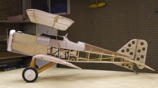

Well, I finally got the wing panels built. Now I can make the struts, and get some bare bones shots. All the components are built now. I still have some detail work to do before I can start covering. It's hard at this point to resist the urge to "HURRY UP!!"

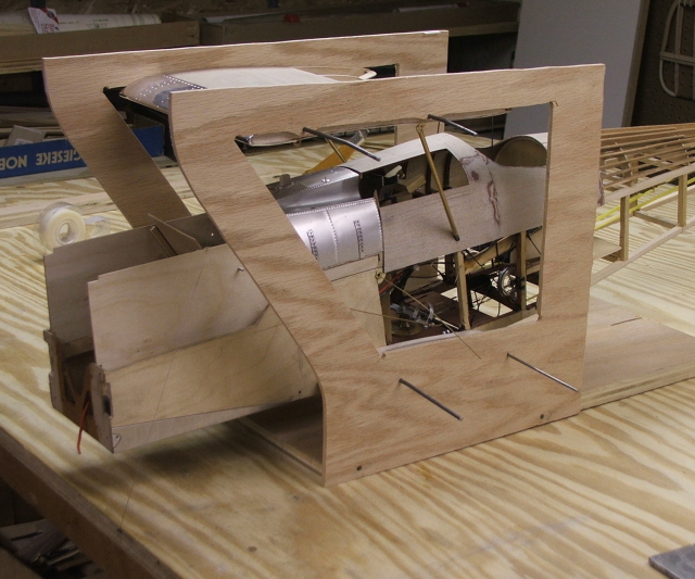

I'm making the cabane struts with 5/32 brass tubing. It's smashed at the top and drilled for a 2-56 bolt. The bottom fits over a piece of 1/8 music wire, bent to fit into tubing that's wired and epoxied to the fuse. The jig holds everything straight while I mess around with it.
Steve

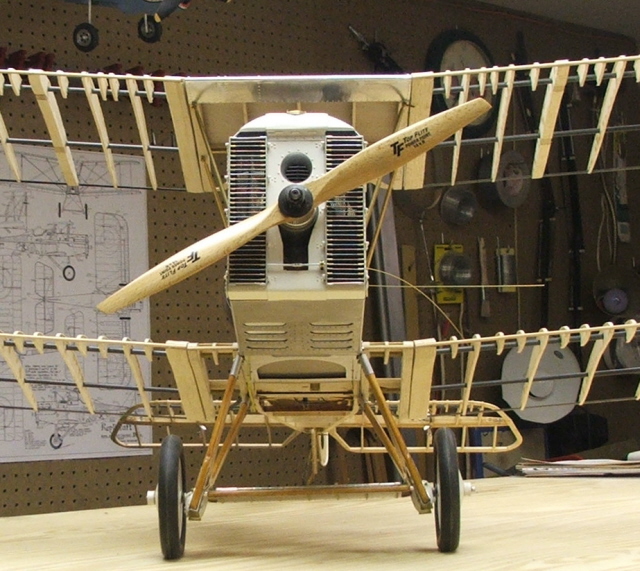

OK. Now I've got to make a bunch of brackets, rigging wires, and the interplane struts. Then I'll be ready to cover it all up[&o]

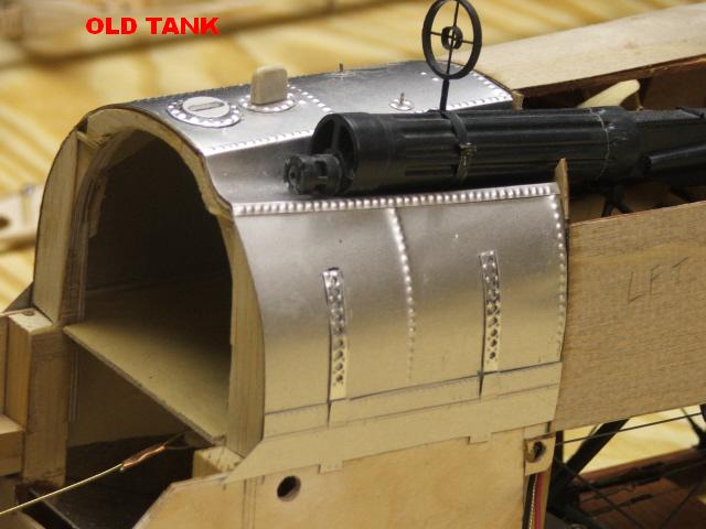

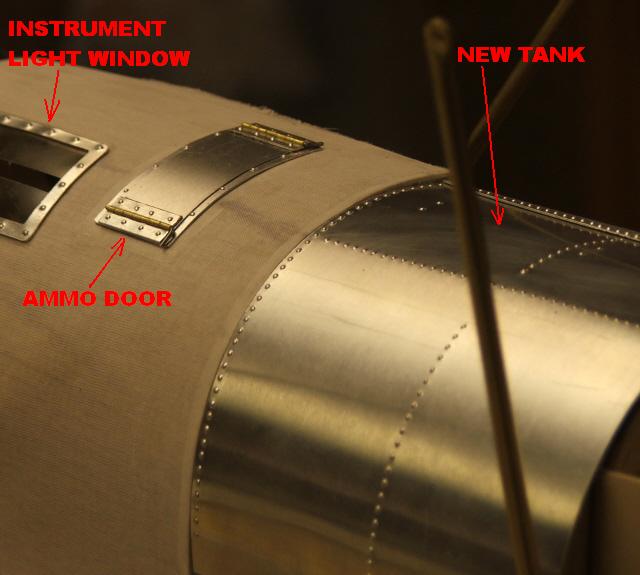

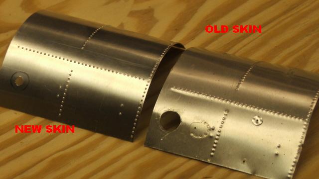

Thanks, Dick. There's a thread in this forum for SE5a questions and pics. Why not post some pics. I'd love to see your project.
Well, I HAD to do it. After I started adding riveted parts, made with my new dies, the rivets on the tank just looked shabby.[&o] So, I peeled off the skin and re-skinned the tank. It really didn't take too long, and now I'm happy again At least for now
Steve

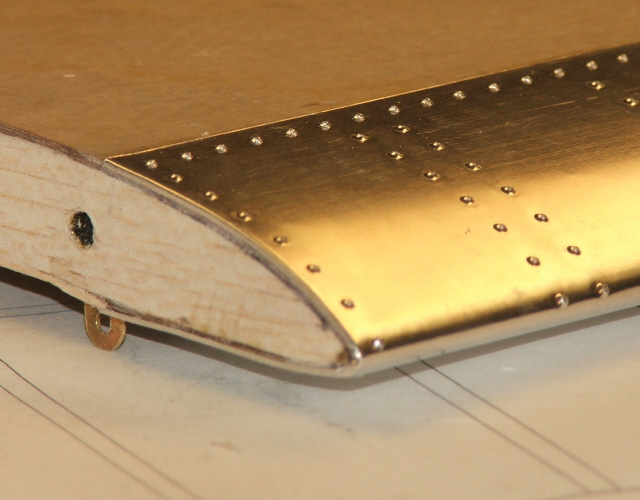

ID:	628335   Click image for larger version
ID:	628336   Click image for larger version
ID:	628337   Click image for larger version
