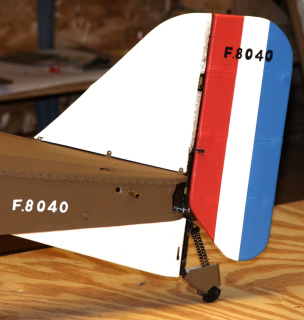

Old 07-15-2007 | 04:07 PM
  #157
My Feedback: (20)
Posts: 973
Received 11 Likes on 10 Posts
From: Cincinnati, OH,
Default RE: SE5a 1/6 Scale
The only stuff I've used in a rapidograph was drawing ink. I've used paint in the nib style pens, but had trouble getting it to start flowing.
Old 07-18-2007 | 08:34 PM
  #158
smcouch77's Avatar
Joined: Oct 2006
Posts: 712
From: Indianapolis, IN
I finished all the painting/varnishing and have started final assembly. I'm starting with the tail and control cables so I can cover up the bottom. Here are the fins, rudder and skid. When it's all done I'll paint all the bolts and brackets.
Steve

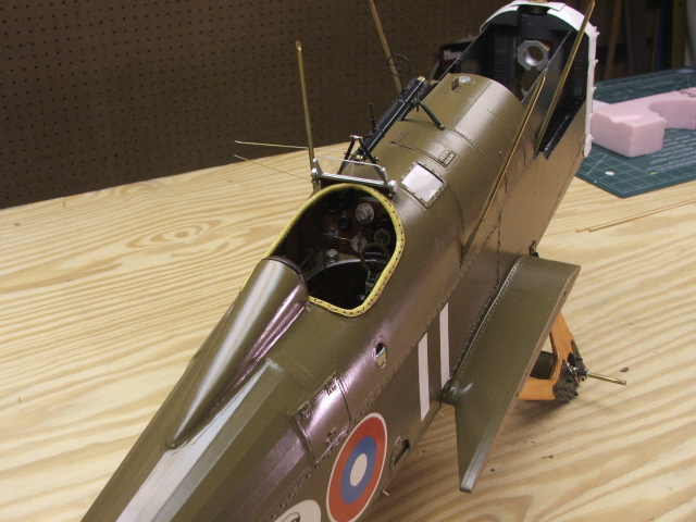

Steve

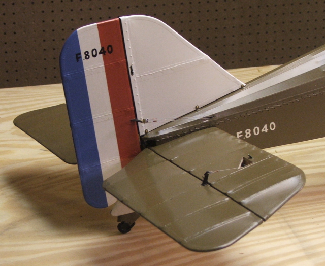

Old 07-19-2007 | 08:46 PM
  #161
smcouch77's Avatar
Joined: Oct 2006
Posts: 712

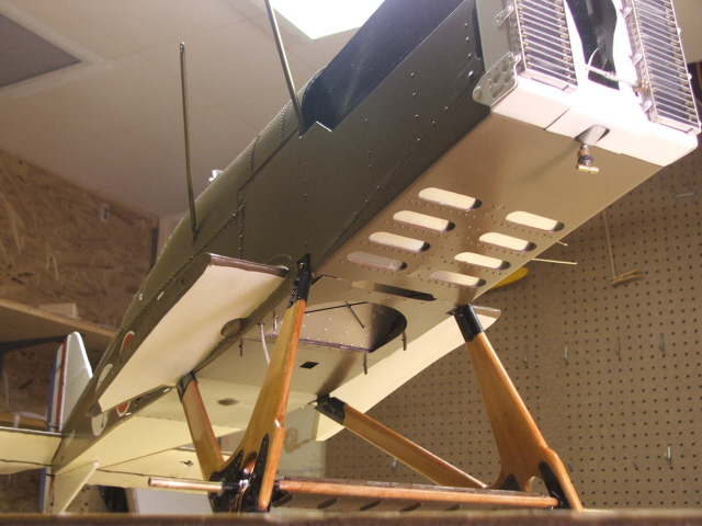

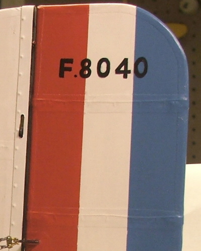

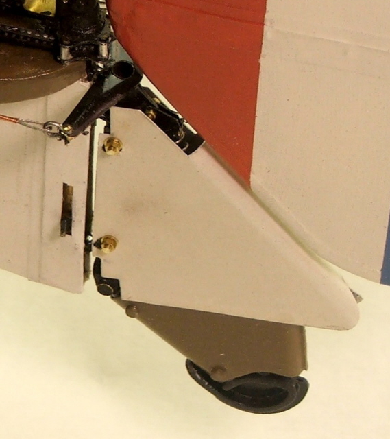

Today, I installed the stab and elevators. Also I rigged the elevator control cables.The bottom panels are all in place, the landing gear is finished, and I did a few details around the cockpit. Tomorrow I'll install the wings and start on the rigging.
Steve

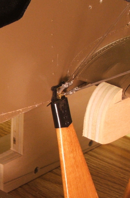

I have one side rigged, one side to go. The wires are steel music wire. How should I "finish" them. I can think of three options. Clear Coat, Paint, or WD 40. I think the oil would be best. Any suggestions?
Steve

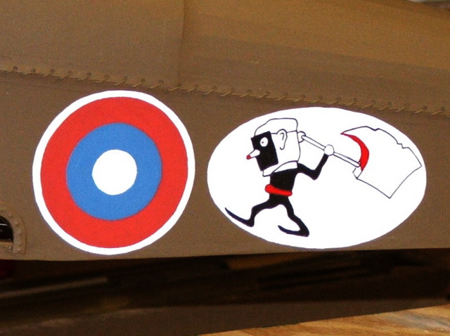

Well, it's been a busy couple of weeks, getting ready for the NATS. Instead of trying to catch up with one post, I'll try to cover everything in several posts.
My little plane did much better than I ever expected. She took 1st place in FAI scale, and Highest static score. Now I have seven weeks to finish up all the details before the Team Trials. I'll try to post some pics later this evening.
Steve

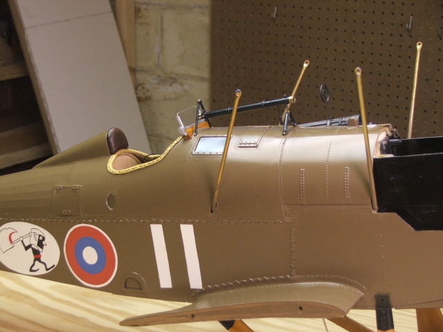

Here are a couple of shots.
Steve
