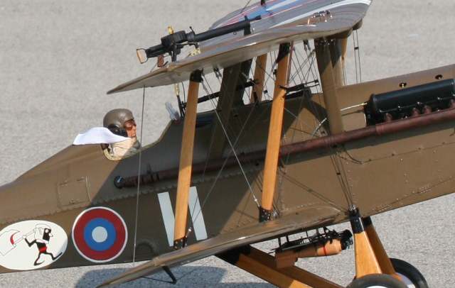

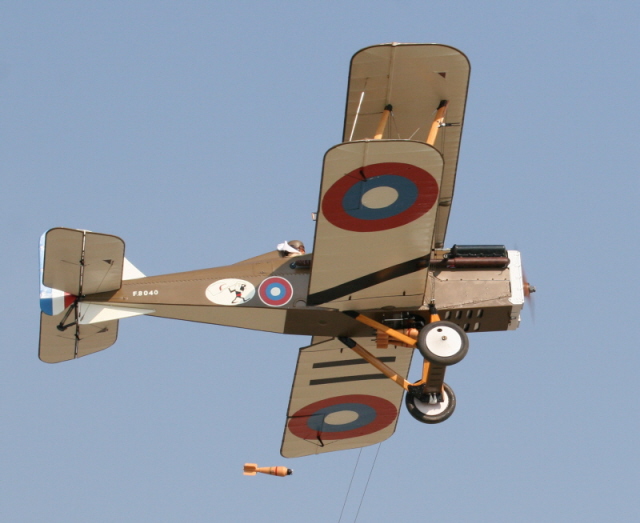

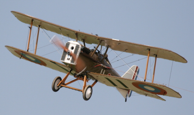

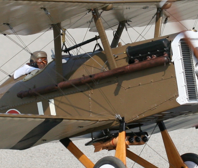

Here's a couple of shots I got at Muncie before we got started this morning.
Steve

Steve, these pictures with are STUNNING!!!........I put one on my computer desktop. just beautiful.

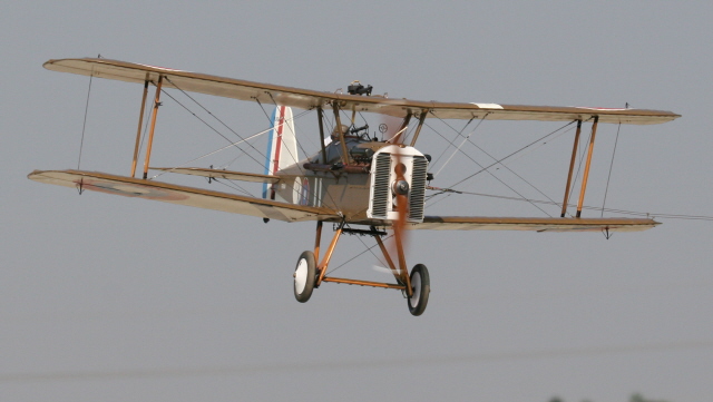

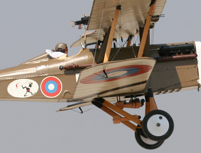

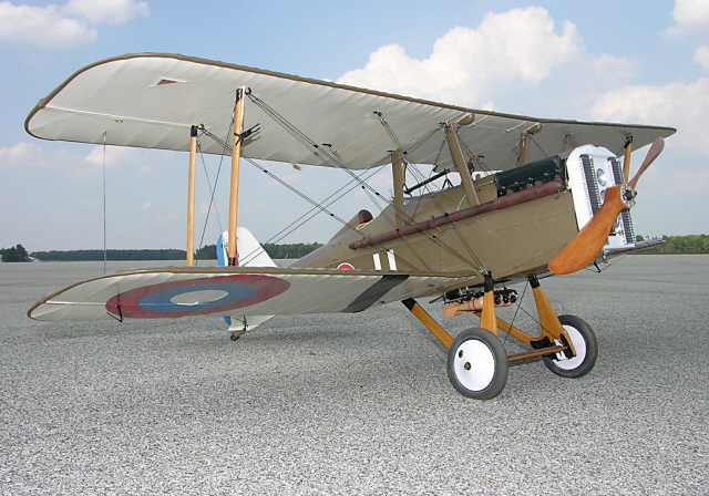

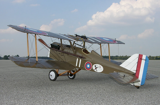

The smoke has cleared, so here's the rundown. My static score was good, 2853 out of a possible 3000. I had power problems with my first flight and wasn't able to finish it. I scored fine on what I did, though. I found that the problem was the fuel. I was blown out of the second flight. A down draft I guess. Anyway the plane droped about 4 feet and took off the wheels. Landing a SE5a without wheels is not without consequences. Of course it flipped over. I managed to get it repaired (enough to fly) but the wind Saturday morning was just too much. Only 4 out of the 11 planes tried, and they were lucky to have survived. I finished 5th, which isn't too bad for not getting in a full flight.
I just received some great pictures from Mark Lanterman, from Airborne Media, which he took at the contest. He said it's OK to post them so here they are. It's amazing what a good camera and a great photographer can do. Thanks, Mark!
Steve
PS Notice the bee in the second pic between the wings.

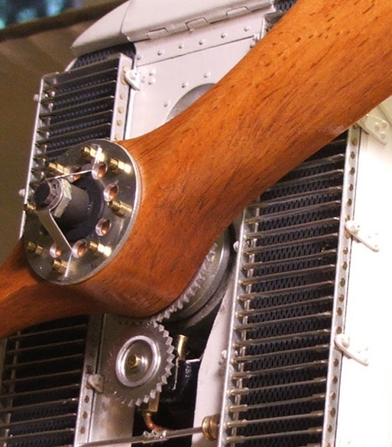

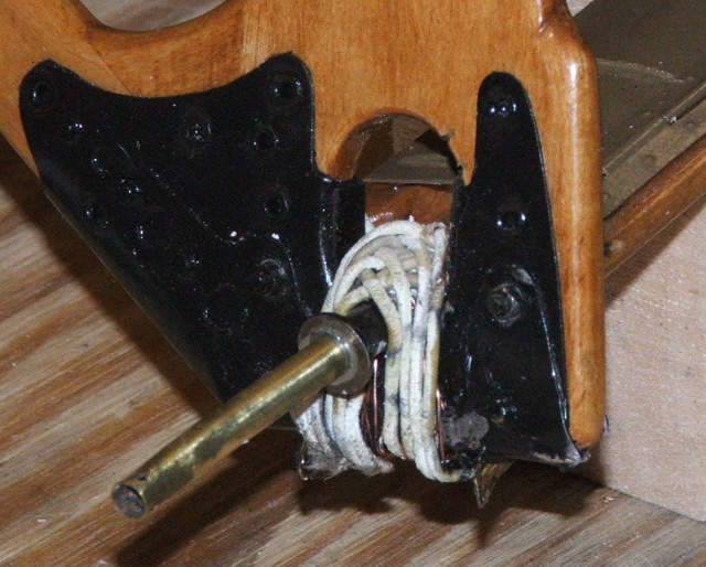

Here are a couple of close ups. It's a little beat up from landing without wheels on pavement. OUCH![sm=cry_smile.gif] I wrapped the axle to the struts with copper and then soldered them. I didn't want it to slide to the outside of the circle. The bungee is elastic cord I got at a fabric store.
Steve

Thanks. I'm toying with sodering a large washer of brass shim stock to the inside of a wheel collar 5/32" to stop the endplay movement of the axle.
Functional bungee should take quite abit of shock load off the struts. Maybe make the lower section from UHMW . thread or press fit the music wire leg and strut at proper angles.

I didn't use music wire in the legs. They are solid wood, wrapped and riveted on the ends. I tried using functional bungee on my test plane. The ground handling was terrible (the outside wing tip would drop and drag), and it bounced on landing. With the axle held solid, it taxis fine and has no bounce on landing.
Steve
