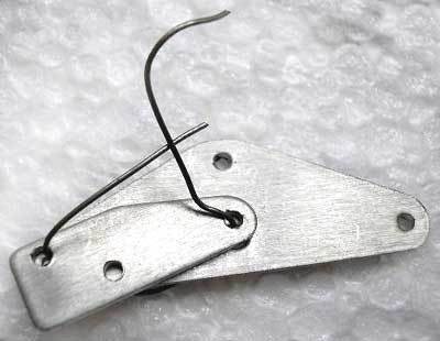

I has a soviet made U/C airplane building set, the wing span are at 40 cm/16". The fuselage are made of whole spruce and the wings of spruce plywood. There are not building manual or plan. The set are made in Gomel in belarus.
How size engine are best for the airplane at 40 cm/16" wingspan?

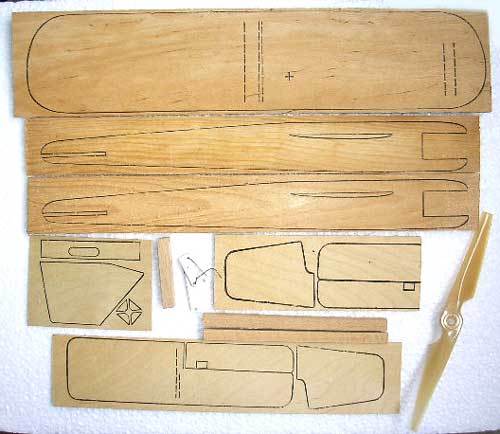

2.5 cc diesel are too big for the airplane with 40 cm/16" wingspan. Must be smaller engine, how small are the engine?
See at the pic of the set of airplane..
Jens Eirik

Is that prop in the center pic part of the kit? If so, perhaps its size will give a better guess.

That airplane, made out of hardwood, is going to be (1) heavy and (2) tail heavy. It is going to have to have some nose weight to be flyable, and fly fairly fast to stay in the air. Looking at it I agree that the MP3 2.5 cc is a little much. Maybe one of the heavier 1.5 cc diesels. The prop and the width of the cutout for the engine should be good clues. For an 049, I would use balsa and perhaps extend the nose a little.

Propeller are marked in size x pitch in mm: 200x200 (7,87"x7,87").. The pitch are large as diameter, maybe a stronger engine to run a propeller with big pitch..[X(]

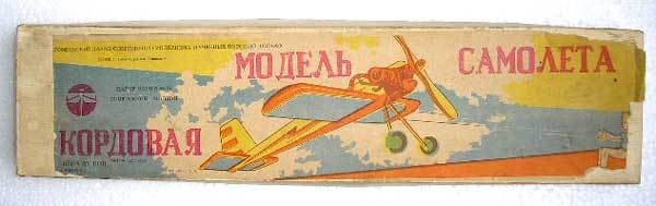

I don't know cyrillic characters, but the large wording on the box looks like it would sound like something meaning Model Monoplane. I can't read the small print. If you read Russian, or know someone who can, more information might be right there.

I am speaking and reading russian since i am married with ukrainan wife.
ÐšÐ¾Ñ€Ð´Ð¾Ð²Ð°Ñ Ð¼Ð¾Ð´ÐµÐ»ÑŒ Ñамолет mean Line controlled model air plane, the small text are informaion where the airplane was produced in ГомельÑкий Завод Спортивного Ñамолета (Gomelskiy sportairplane factory).
There are not technical information, nothing text about engine size..
The airplane are smaller than other airplane with 2.5 cc engine and the width of the cutout for the engine are 21 mm/0,826 inc.

if the motor hole is 21 mm wide it fits EXACTLY a MK16 and MK 17 1.5cc diesel, of course russian. The model has the right wingspan for it. The 200X200 propeller should NOT be good for this engine, but it could in some way work.
