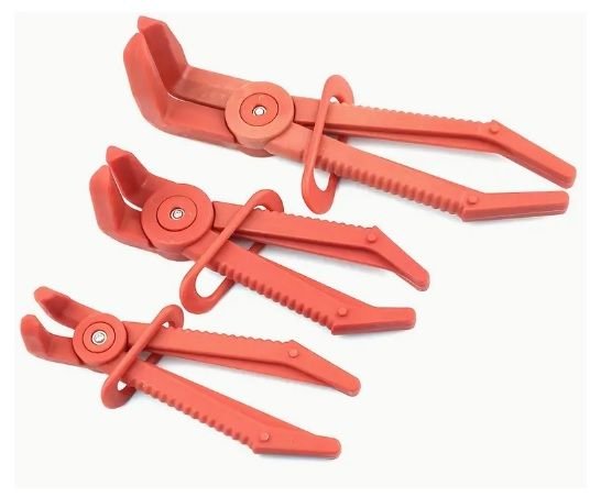

Two and a half turns sticks in my head but my control line days were prior to 1975 so I could easily be wrong, and it may vary for different engines. If it starts too lean it will likely shut down, or you can use a fuel line plier hand clamp to shut it down and it will help keep your hand and fingers away from the prop. Or whatever way you prefer to shut it down. I have some of these clamps (in my shop) and plan to use them. Have not tried them yet. If it is too rich just screw the needle valve in until it starts to break from a 4 cycle into a 2 cycle and away you go....
Nylon Hose Clamp Tool Set Brake Fuel Water Line Clamp Plier Hands Free Tool Car Repair Tools Hose Pliers - ****
3Pcs/Set Nylon Hose Clamp Tool Set Brake Fuel Water Line Clamp Plier Hands Free Tool Car Repair Tools Hose Pliers (Color : Red-bend-3pcs) - Amazon.com 3Pcs/Set Nylon Hose Clamp Tool Set Brake Fuel Water Line Clamp Plier Hands Free Tool Car Repair Tools Hose Pliers (Color : Red-bend-3pcs) - Amazon.com
Plier Clamp

Ya I can see that they would be handy but my area is so small I use a set of hemostats. But I had to modify them by adding red permitex sealer to stop them from damaging my fuel line. I have 6 planes that I can fly, kinda grounded sliced up my right thumb on a saw six stitches. Really sore but only five days sense I did that. All my Fox Stunt 35s only one has a K&B NVA just two turns with it. The hole in the Venturi is noticeably larger compaired to the Fox. Two square tips and three pin head tips. Later version. Mecca has the original needle tip. But two of my engines have the flat. On the square tip model. Those are the leakers. Still use fuel lube on the threads to help seal it up. Never had much luck using the fuel tubing. Ordered blue fuel tubes four sizes one foot each size. Fits fueled garden edgers. Think I may try it. They claim they are Ethinol proof. Should be fine with my 25% Castro fuel methane mix, use touch of liter fluid in the winter. Add to my fuel half ounce, and prime. AJ
