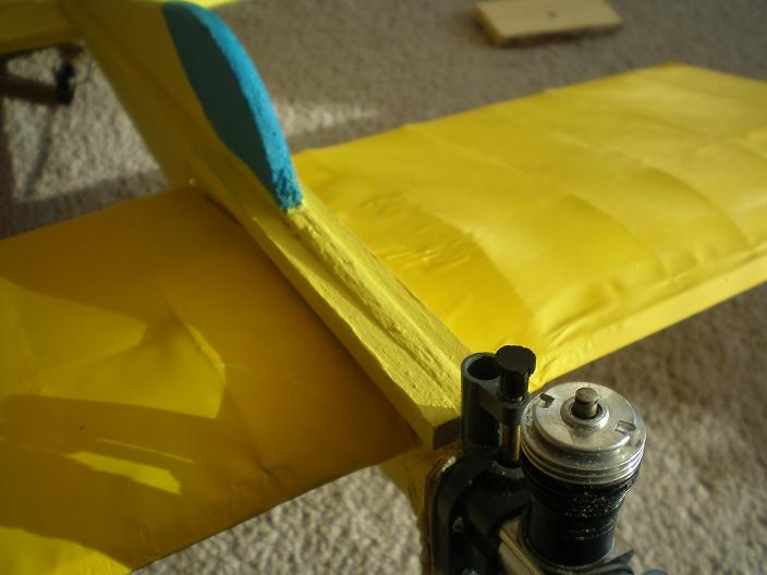

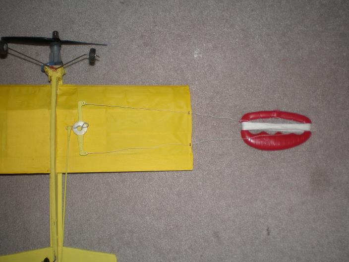

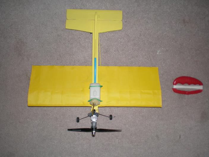

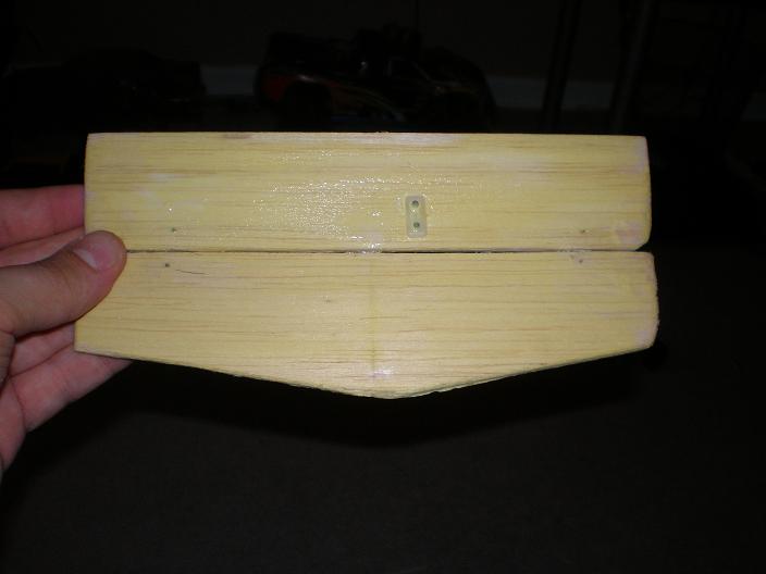

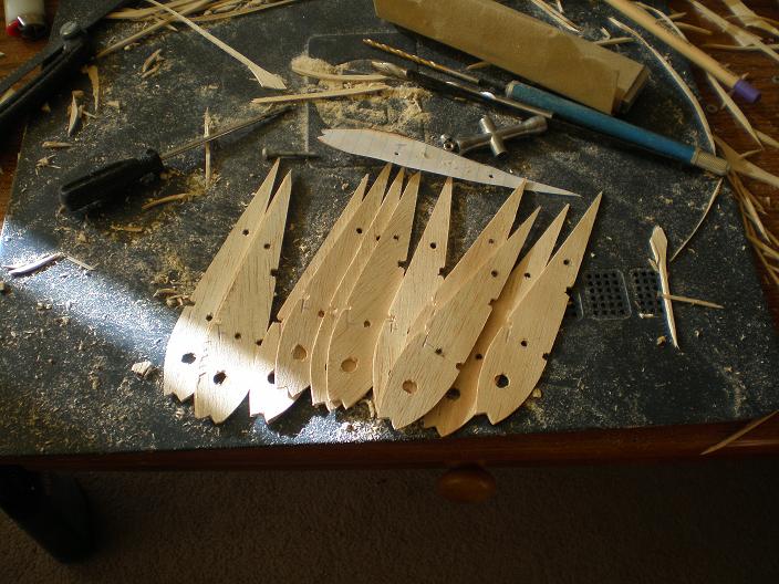

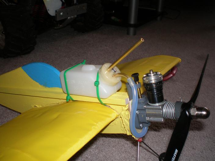

I never found that site before but it had everything i needed. Here is a few pics of the c/l i started. I never labeled any of the pics so if you got any questions and see anything i have done wrong or could just make it better lat me know

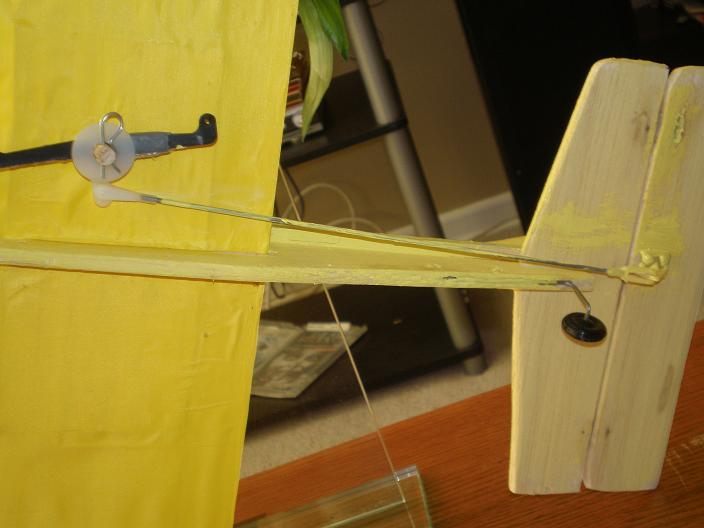

It looks better than my first plane. Make sure the wings and tail are straight. Also make sure that the controls work freely.
Here are some things to look out for next time:
- Make sure the wing ribs are cut with the grain running straight. That will give you the most strength. Note the second pic where a few have the grain running crooked.
- Learn to make glue joints using very little glue. Note the picture where you glued the trailing edge on. If you put just a little glue on the ribs, let it soak in, then add just a little more and apply the trailing edge. It is usually easier if you apply the trailing edge to the top, then add weights. When dry, turn the wing over and again glue the trailing edge to the top. For the most strength and least weight, male sure everything fits well with no gaps. NEVER try to fill gaps with glue. Good glue joints are harder to make but well worth learning. It comes with experience so you need to build lots of planes.
- Hinges. I noticed you used RC hinges. I hope they are the barrel type and move easily. The sheet nylon ones are good when you have a servo to move them but not when you depend on the pull of the model as on a CL ship. Sewn or cloth hinges are better for small CL models.
- Your control setup. By moving your bellcrank closer to the ship and the control horn a little more inboard so that the pushrod is parallel to the fuselage would look better and possibly work better. Keep that in mind for your next ship.
- When you need to fill gaps like the bellcrank mount and fuselage to wing joint, use a balsa as a filler, with a small amount of glue to hold it in place.
- The rudder will probably break off easily. It is much stronger if the balsa grain is running up and down.
- The engine mount could use some support, like a triangular balsa block as high as the engine mount and back to the wing leading edge on the left side and from the bottom of the tank to the bottom of the fuselage, also back to the wing leading edge on the right side.
- You do not show your fuel tank installation. What do you have?
Some other pointers: Fly over grass if you can. Let someone hand launch it for you. You can also run some cardboard over grass for take off if you want. Concrete or asphalt eats airplanes.
Have you ran the engine yet?
Looking good so far.
George

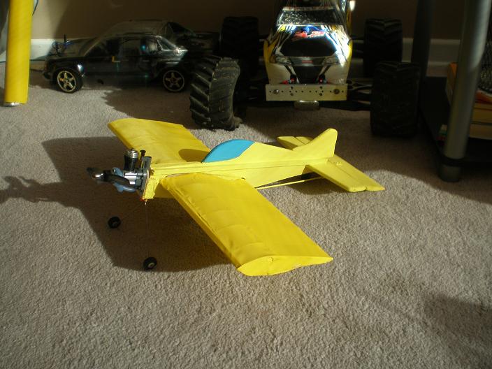

Looks good. I think it will be tail heavy. It can balance on the leading edge of the wing and still be stuntable.

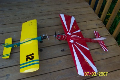

you don't have to have plans. Here is a couple I built from scratch and they fly great. The red one I call the TRICK STAR has a Norvel .061 and will fly any AMA manover in the book and is light as a feather and tough as nails. The yellow and turquoise I call the SWEAT BEE and is powered by a Cox Black Widow .049 and is a real hot rod! It flys a bit fast but has good line tension and is very managable.

You have done some great work there! You should be very proud, especially with the wing ribs.
The biggest problem I see for now is far too much glue. Glue that is not actually holding part of the plane together is just dead weight. The test is:
If you can see any glue after the parts are put together (but not dry yet) then you have used too much glue. I see glue smeared in many places that the parts are not touching. This is something that you will learn in time and it will be well worth the trouble once learned.
The second biggest problem I see is that the engine firewall is going to give you lots of trouble because you need a lot more bracing. If you don't, expect the firewall and engine to part company with the rest of the model early in its life.
Keep up the good work!
Robert.

Ok well I think I'm in some trouble now. The guy at my LHS said he wouldn't have anything or even be able to get me anything in that would work with my cox engine . So I hope you guys cab help me out, or even give me some good insight on some tank building materials.

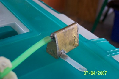

I made this one from brass shim stock, a tin can works well too. A wedge tank would be a good choice for a CL plane since the centrifugal (spelling?) force will be working for you, no need for a clunk like an RC tank. Maybe someone has a diagram of the insides.
Don't be a "suckerforamoneypit" my Grandfather always told me, "If you aint got what you need make it!" If you can't make it try www.brodak.com

Thanks for the tank plans. but do you think i will be able to solder a tin can and if so is there some kind of solder or flux that would be better to use.

I have made several from a tin can using paste flux and rosin core solder. A torch, soldering gun or iron work well, just skuff up the surface a little, brush on some flux, add a thin layer of melted solder (called tinning) and fuse the sides together with heat. Practice on scraps first to get your techique down. Give it try, it's actually pretty easy.

Sounds good. But i got to ask when i fuse it together will i apply the soldering gun directly to the tin to heat it up?

Yep! Give it a try, you'll see.

Another possibility is to use a 35 mm film cannister. There is a shoe repair glue called 'Goop" which you can use to seal the holes for tubes. Annother possibility is to use a small balloon. Attach it to the fuel line (twisty tie or rubber band) with some fuel line inside with a couple of notches cut in it. You fill the baloon with a syringe through the fuel line, then suck all the air out. Leave the baloon soft. You can put the balloon inside the film cannister, or use the cannister as a tank directly.

Well my C/L is done. I want to say thank you to all u guys for helping me out. Here are a few pics, I didnt make my own tank yet but the weekend i am going to give it a try. Also i will going to flying her the weekend, So i will try and get a small clip for you guys.
