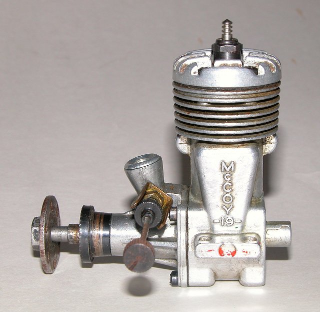

I just purchased a set of Walter Musciano plans for the Beechcraft Staggerwing and wanted to know which engine to use? The plans call for a .15 to .25 engine...........and I was thinking of buying a new Fox .25BB Schneurle CL engine, would that be a good engine or too much for the airplane? Any other suggestions would be welcomed and appreciated thanks!!! [8D]

Although I have never seen those plans, I would suggest something around .10 or .15. When Walt Designed those planes, he used engines like OK Cub, McCoy sport, etc. that were not noted for power. What engine options does it show on the plans.
Although the Fox .25BB schnuerle is an excellent engine, it may be too heavy and powerful for that plane. I am assuming you are using it as a sport/scale ship. If it is for racing, it should be fine.

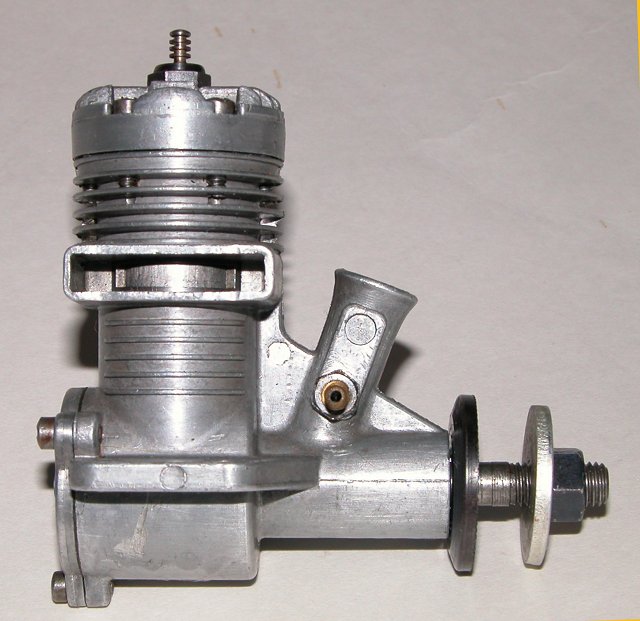

Sounds like it would be perfect for one of the older non-schneurle .19 engines such a Fox, K&B greenhead, Veco plain-bearing, McCoy Sportsman or Testors-McCoy lightning bolt case. You can pick them up for peanuts on auctions or classified ads and they are wonderful engines.
