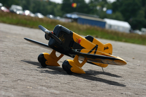

plasti-kote polyurethane varnish: #591 clear gloss varnish. This works also very well on firewalls.
I also used a waterbased polyurethane floor varnish to seal the decals wich are laser-printed on the back side of an overhead projector sheet. This varnish is not 100% diesel proof but very resistant to glow fuel.
