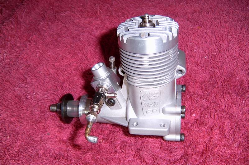

I was wondering if it's possible to convert an OS 40 fp rc engine to control line by removing the existing carb and replacing it with a venturi and needle valve assembly. The engine is new in the box, and I was hoping it could be done without altering it in any way just in case I wanted to use it for rc again.

If OS makes a venturi and spraybar, it'll certainly be possible. If not, then finding a venturi that fits and a spraybar that works will require some serious looking. Unless someone around here has already done the deed and knows what parts to get.
Maurice,
Should work without problem. You may still be able to find the venturii and needle valve assembly at Tower. If not there are some 3rd party "cottage" guys who can supply the pieces.
Depending on what type of CL flying you'd like to do, the FP has served well. For some, box-stock (other than the venturii/NVA change) worked well. For more serious "stunt" CLPA fliers, there were various mods. There are many good CL fliers in Eastern NJ, btw.
If a manufacturer produces the same engine in CL/FF and RC versions, often, the CL/FF versions are identical to the RC version, except for a venturii/NVA in place of a throttle. For CL Stunt, engines like the 40-FP have done well with mods as simple as one or two added head gaskets.
The "Classic" 4 cycle/ 2 cycle "stunt" run mode always sounds good, but so many "modern" (i.e., ABC or equivalent, Schenurle-ported) engines are primarily designed for the higher RPM RC use. You would lose too much power running them around 9,500-10,000 RPM to get that sound. The answer has often come down to running a slightly larger, flatter pitch prop to get nearer the engine's best power range and still keep airspeed (thus laptime) manageable.
Recommended prop for RC with a 40-FP RC version is something like a 10-6; for comfortable CL use an 11-4 or 11-5 lets it rev to its comfort zone, and doesn't spin you dizzy on 60+foot lines.
Another few things have worked reliably: a fairly hot plug, 10% nitro, 11% each castor and synthetic oil fuel, and muffler pressure to the tank. BTW, the huge stock muffler can be replaced by a much smaller, lighter "chip" or "tongue" type. These look like the extension neck on the stock mufflers, capped at the outer end and drilled with many small holes to let the hot gases out. They reduced sound well, if not as well as the big trashcans, and can provide muffler pressure for the tank.
The run setting should be a "wet 2-cycle" - smooth, steady 2-cycling, but not peaked out. Definitely visible exhaust "vapors." In stunt, maneuver airloads caused the firing mode shift from 4- to 2-cycle in the older iron piston/steel sleeve, baffle piston engines. If things went right, you heard a 4 cycle purr and a 2 cycle shriek as maneuvers loaded the engine. With a "wet 2-cycle" run, there's little audible change in engine sound.
You start to think there's no RPM change. (I still think there is, but we can't discern it as easily. It isn't the sound of firing every other revolution then shifting to firing every time as in the traditional 4/2 style run.)
If you can find the Joisey control-line guys, they can help you a lot...
Luck!

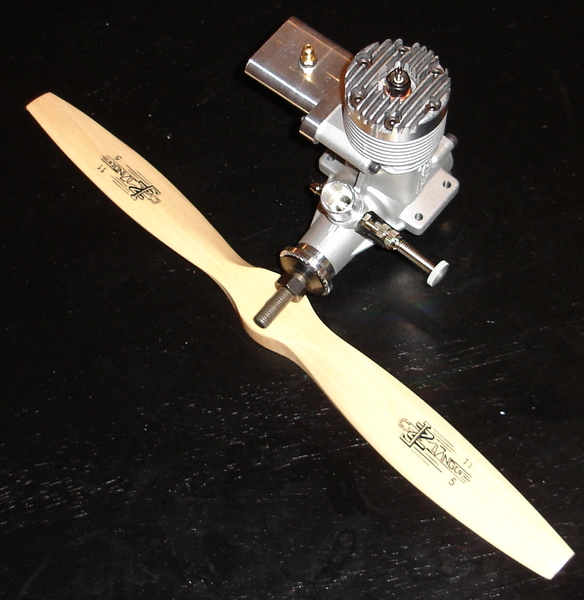

Hi Maurice
I recently bought a 2nd-hand 35 FP which had been modified exactly as you describe. The RC carb came with it and can be easily retrofitted if I want. I haven't flown it in a model yet, but it runs well on the bench.
I can't imagine that the 40 FP would be much different.

Hi Maurice, as far as I know it's standard, but I haven't pulled it apart yet. The previous owner mentioned using it for mainly CL stunt and a bit of RC, but made no mention of mods.
Steve

I am going to go against convention wisdom.
I have a lot of fp 40 time. 3 of them. There are a lot of people telling you you must block the boost port or get expensive rework done to use it for control line. None of mine are. You don't need it, unless want to fly contests and are real picky. I think many people that suggest rework never owned one. And yes some have had issues with it.
People block the boost port to detune the engine and make it happier running slower. They also sometimes change the head shape or change the timing by gringing on the sleeve.
I have been successful by going to a real flat prop(11x3), fuel with a little more oil, and an extra head gasket. If you run a 5 or 6 in pitch prop, the plane will fly quite fast. And yes I still have a a few run aways on hot days. Not very often anymore. Unless I have driven 200mi to a contest I don't care.
Again, don't send your motor out to get reworked until you know you like flying stunt. It might cost you $50-$75 and be gone for a month to get this done. Is that motor worth a $50 rework? Probally not. Save your money and go out and fly, then the use rework money to get a Brodak 40, the new evo 36 or an OS LA 46, if you feel the need.
There are fliers in NJ than can help you. They use this motor without rework and are happy with it.

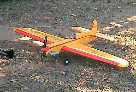

I've been running an OS.40 FP in my ARTF Nobler for a couple of years now. Like yours, mine was an r/c engine, I bought the NVA and venturi ( same as the LA part ) from my LHS. I'm a big fan of the FP series engines for C/L, also got some .15's and a .25, all converted from r/c to C/L. They're good engines, you'll be happy with your FP.40.

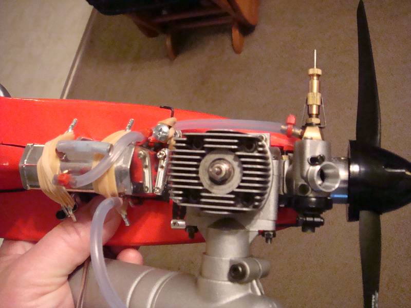

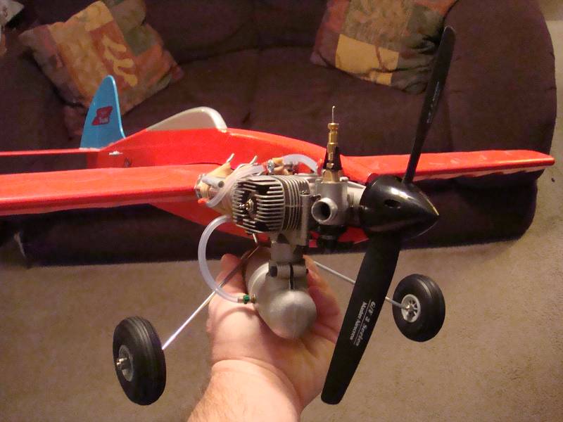

Joined: Oct 2007
Posts: 67
From: East Bernard, TX
ORIGINAL: da Rock
Lots of people just lock the throttle wide open and go from there. That works great.
The only real difference is that I can start the motor at idle (throttle control wire in the "up" position), stroll out to the center, then have my trusty ground crew push the throttle control wire full down, which opens the carb (and engine) wide.
I don't know about you guys, but I've always felt a bit bad about leaving some poor slob hanging onto the end of a SCREAMING machine while I run out to the center and give the controls one last check before signaling for a release. This is all cool if your ground crew is a fellow brain damaged Modeler, but if your wife, girlfriend, child, or just some dummy strolling by has been pressed into service, the time from engine start to release seems TOO LONG.
WORSE if this is an air launch...
I apologize if my photos or verbage do not fully explain what I intend. I can pull it apart a bit and try new photos if anyone is interested.
Keep 'em turning!
Matagordababy (Steve) / [email protected] / 1-979-335-4552
