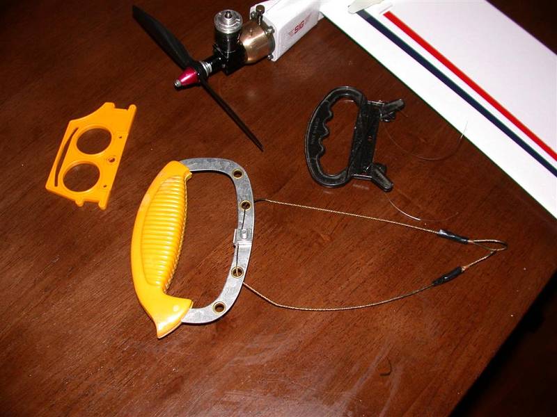

I just raided my wife's sewing box and found some "cotton wrapped polyester button and carpet thread" which I cannot break by hand, and some straight nylon upholstery thread, which is also impossible to break without cutting though my hand. I think for the first time out I'll give 'em a whirl (sorry for the bad pun). As for line length, what do ya'll recommend? I'm thinking 30-35' - sound about right?
It's kinda neat being able to say that so far, I have $0 in the project. The kit was a gift, the glues and paints I already had on hand and the engine was put together outta my "spares" box... (It's a Golden Black Widow Bee which runs rather well and consistently.)
As for handles, I have three to choose from... I'm guessing if I swap out the leads on the center handle in favor of something lighter, that will be my best bet, yes?

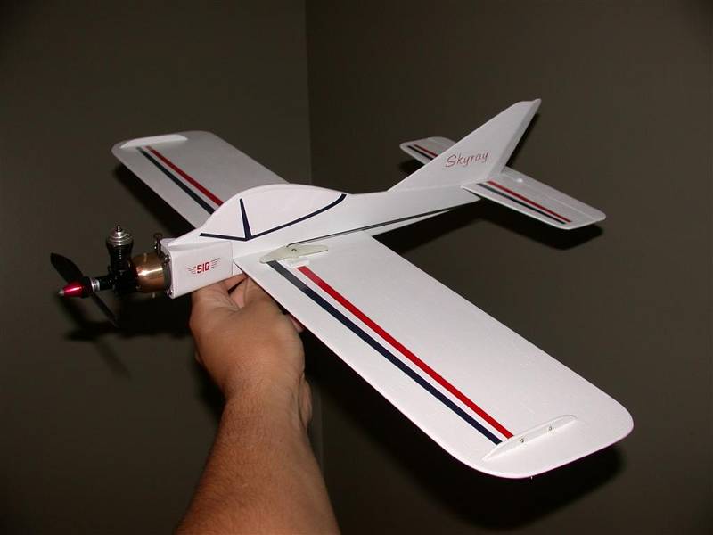

Joe, for starters use the thread but I would measure out at least 35 to 37 feet. Less diametyer will have you screwing yourself in the ground. No need of that
The thread will be light but draggy. The .008 wire is your best choice for future use. Trust me you will love it.
As for the handle, just choose the one that feels most comfortable.
Did you build this one? The finish is really first class.

I would use 30 ft lines for the first try. I would not try longer lengths at first unless the plane is very light, under 5 1/2 ounces. The most important consideration in control line flying is line tension, lose it and crash. Shorter lines will help insure tight lines and protection from the occasional wind gust. You will turn a bit faster though so be ready for it.
If 30 foot lines work OK, try a longer lines after a flight or two.
.008 cable is very nice to fly with but it is very fragile. It kinks and breaks easily.
Be sure to launch at the correct area of the circle with respect to the wind. Never launch into the wind like you would an RC plane.
The Skyray flies well and is very stable. Have fun!

Nice job on the Skyray. Make sure you use a narrow spacing on the handle. This will give you less sensitive controls for those first few flights.
Good luck with it.
George

As far as that "first class finish", I'm a little ashamed to admit it's just Rustoleum. Yea, I know it's heavy, but I did hit the balsa with a coat of sanding sealer before I painted it in an effort to keep the wood from soaking up too much paint. I really wanted to try my hand at a doped finish, but my LHS wanted an arm and a leg for the stuff - I would have been almost $30 into it, had just enough supplies to do the job, and stuck with a color I wasn't too interested in. [:'(] Good news though, she only weights 5 3/4 oz (with the tip weight and lead out lines installed) so I guess I didn't do too bad!
Hopefully I'll be checking in with a flight report before too long...
