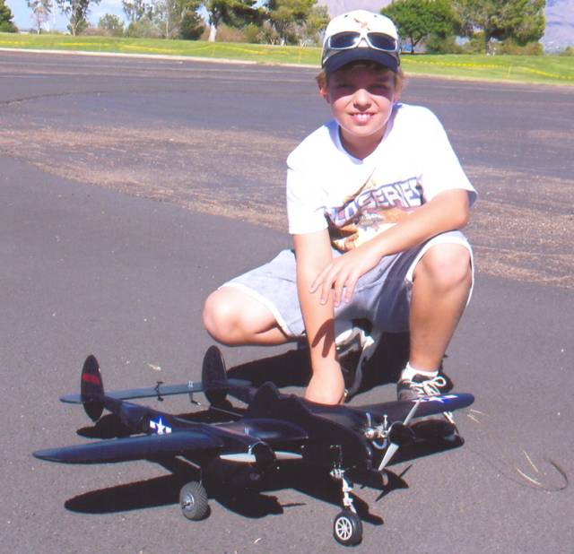

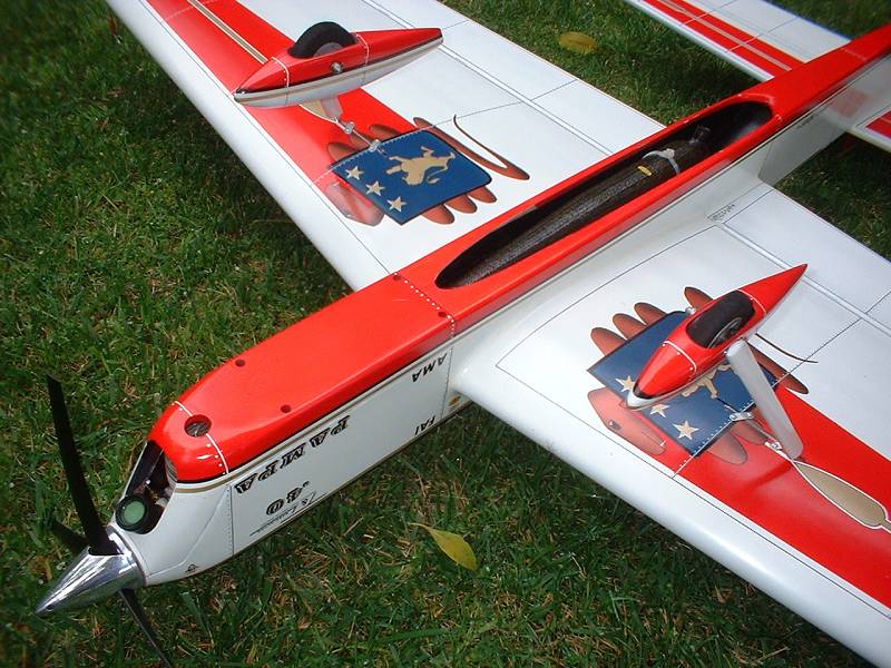

Here are some of my C/L ships, Stunter with a PA 61 on a carbon pipe, Tigercat is an Old Timer Scale job, son's p-38 1/2A Profile Scale ship with the same JRoberts 3line bellcrank your ship proably has, his is throttling two Norvel 049's.
