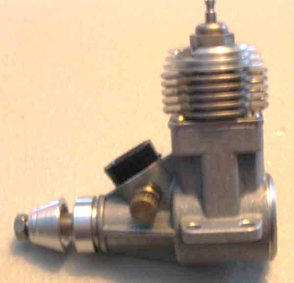

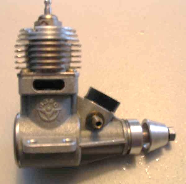

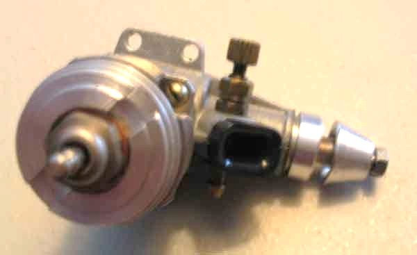

ORIGINAL: kersplat
Is this the version with the venturi the size of a toilet bowl?
Might you be referring to the AME Zeus? I think it was before the NORVELs and only came in .049 AFAIK.
I THINK the only difference between NORVEL's AME and Big Mig is the cylinder porting. They came in both .049 and .061.
George
