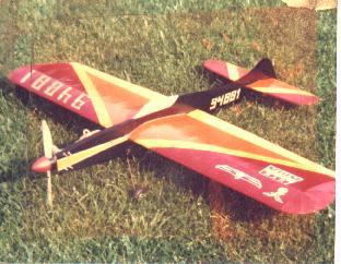

So heres the deal- Im 65, restarting control line after 55 years, when young could only afford 049 stuff, was advised by an another old control liner not to start with an 049 plane so I got a ARF Flitestreak put an old Fox 35 on it, used an old EZ Just control line handle and crashed and crashed and crashed until I decided to go another way. So I relearned on a 15 powered plane cobbled together and now have a Supertigre 40 powered plane given to me by another old guy; It is a flapless homemade stunt plane. My questions are: This plane weighs 46 ounces and takes about 25 feet to do a loop. If I speed up the controls to tighten it up I get into the PIO mode. Would a lighter plane loop better without being oversensitive? How about a plane with flaps? I can go round and round ok and do inside and outside loops but it gets close to the ground sometimes. I know Im older and slower but eventually I hope to get some modest proficiency. Advice please
ORIGINAL: Planehutch888
.... So I relearned on a 15 powered plane cobbled together and now have a Supertigre 40 powered plane given to me by another old guy; It is a flapless homemade stunt plane. My questions are: This plane weighs 46 ounces and takes about 25 feet to do a loop. If I speed up the controls to tighten it up I get into the PIO mode. Would a lighter plane loop better without being oversensitive? How about a plane with flaps? I can go round and round ok and do inside and outside loops but it gets close to the ground sometimes. I know Im older and slower but eventually I hope to get some modest proficiency. Advice please
If you want advice on a different plane, then the answers to your question are all "It depends .... ". If everything else is equal, then yes, lighter planes will turn tighter than heavy ones for the same amount of power, control throw, CG location, etc. But small differences in weight will not be noticeable unless you've got everything else trimmed to it's optimum. Same with flapped wings - if they are trimmed correctly, they can have advantages. If they are nose-heavy or otherwise not set up correctly, they are no better. In fact, if turn radius or loop size is your only measuring stick, then an unflapped wing trimmed to it's tail heavy limit will out-turn a flapped wing (think combat planes!). That doesn't mean it's flying "better", since there is way too much personal preference in the term "better".
Since you are able to do insides and outsides (how about inverted?), you mainly need to fly. As you get accustomed to your plane, you will probably want to start getting tighter loops, sharper corners and you'll fly the plane to the shape you are trying to fly. As with most things, practice is the best fix.
Best of luck and welcome back.
Your .40-powered 46 oz plane - my first question would be "what's the wingspan"? Is it supposed to be .40 powered or maybe something less? Personally, I've been flying the old Sterling Skylarks the most, almost since they first came out, and have never put anything larger than a .40 in them - actually, all but 1 of them has used .35's, usually Enya or Fox, and they have a 52" wing. My latest Skylark weighs a whopping 57 oz, uses an old NIB K&B .35 and she flies just as well as any of the others, so if your .40 plane is anywhere even close to that 48-52" wing you might be just a bit overpowered, which can lengthen out maneuvers - she's simply going too fast.
One other item I noticed as I re-read your note for the empteenth time - you said your ST.40-powered plane is a "homemade stunt plane". Sure wish you'd included a pic of her, but in the meantime, is the wing thick enough to lift her around in loops? If she's a "home-built" kit she's probably fine, but if she's someone's home-design she might simply have too thin a wing for tighter loops.
Flapped/non-flapped, doesn't make a whole lot of difference to most plane designs as long as the plane is balanced decently, unless you're actually trying some of the tighter maneuvers where flaps CAN make a difference. I've been flying CL since I was 7 (a lot of decades ago) and in my experience the biggest difference flaps make is actually in landing - but then, maybe I've had so many flapped planes that I just don't notice the actual flying differences anymore. Some of my lighter flapped planes have had a tendency to float a bit and then actually "balloon" if I pulled up too much, too quick, in the final flare to land - makes for some interesting touchdowns on occasion.
Handles - I'm still using my 30+ yr old EZ-just handles too, with full spread and standard 3" bellcrank in the wing with control rods to the innermost point on the control horns (LOADS of control input), but then, I'm used to that set-up so I don't have much problems from it. One problem I've noticed new fliers having with similar set-ups is that they hold the handle too tight and they're too "jittery" with it - but that's what being new to CL is all about, getting used to what's more comfy and smoother for each pilot. MY handle technique (I'm left-handed, by the way) is that I actually hold the handle more with my finger-tips (2 center fingers) and control with my index and pinky finger - a VERY) light and loose touch. Yeah, I know, that's just plain WRONG according to every book I've read, every flier I've flown with, etc etc - but it works for me and always has. I also don't control with my elbow, but with my wrist, which is even more wrong to 99% of CL fliers. BUT, between wrist and finger-tip control, I can (and frequently do) fly nearly any plane right down onto the ground with full power and keep her there until I'm ready to lift off again (that little stunt gets lots of comments on the flying field every time), usually 2 or 3 complete turns around the circle.
For the life of me I can't remember what "PIO" means (that's old age setting in) but I'm going to assume it's "porpoising", plane simply won't steady-up enough to fly smoothly. My first "gut" feel for your particular plane is that you're CG is off - probably too far back. My PERSONAL rule-of-thumb is to put it just at or ahead of the main wing spar (or thickest point of the wing if the spars don't show), never behind that point. If your CG is near that point and your control throws are enough to put your elevator up/down 45 degrees you're going to get the best loops that any particular plane is capable of putting out. If your plane is flapped, the flaps and elevator should move about the same amount (elevator up - flaps down, or elevator down - flaps up).
I added that last paren part just as a reminder - I HAVE seen people set a plane up so both the flaps and elevator went in the same direction. Doesn't work so good.
Hey man, practice, practice, practice. You've been out of it for 55 years, gonna take awhile to get the feel again. Just relax, spend time getting the smell of nitro back into your system, and enjoy yourself. Yeah, your reaction times aren't the same as a guy who's 18, but who cares? Mine aren't either, but I can still fly well enough to have a ball on a Sunday afternoon (or whenever). And don't try my "touchdown at full power" trick until you're back in the groove!! It CAN be a plane-killer.
Keep us posted on how you're making out, and WELCOME BACK TO FLYING!!

Thank you one and all for your input. One thing I knew for sure was that I didn't know. My plane has a 52" wingspan and a 9 " chord. The wing is approx 1.65" Thick so it will fly thru a loop. I use a 10/5 or 11/6 prop. I don't know if it is flying too fast, it may be. I will call Mr Denny soon and meet when convient for him- thanks for that name. I also appreciated the comparison of flapped/ unflapped planes characteristics. One person mentioned 45 degrees elevator movement as the maximum and I figured that out as I tried more and it didn"t tighten things up anymore. I will get a pic of my plane and post it as soon as I figure out how that works. Thanks Again!

When it's too far forward, the plane can't be turned anymore than a certain amount. Lots of people are ok with this and think it means the plane is safer. It actually isn't. There is a sweet spot. Actually, it's more of a sweet range.
When it's moved back, the elevator starts to gain back it's effectiveness. There will be more than enough pitch stability to keep level flight without having to move the elevator at all. You might not think so at first, but judging "enough pitch stability" will grow on ya'. So most times, if you suspect a plane is too nose heavy, moving the CG aft is a pretty safe bet. How do you hedge that bet?
Use something like geistware.com's CG locator application to find out what kind of CG range that specific airplane has. It'll tell you by the width of that range just how touchy that plane is. If the range is narrow, you want to be conservative with the first move. If it's wide, don't go crazy, but don't sweat it. And the results from running the numbers through geistware will be an unbiased judgement of your present CG. It'll tell you if it's "super safe and mushy" for example.
You need a yardstick to use that application. And about 5 minutes.

The old TF kit flite streak plans had the CG on/near the spar, which results in a rather quick response. One of my old kit FS's balances on the spar with the old Fox plain bearing .25 and its very light and quick on the controls. It could easily be moved forward 3/4" for a beginner or someone who doesn't want that sort of light "flickable" response.
The Brodak plans for the full size Flightstreak show the CG right behind the leading edge spar. I have George Aldrich's proof copy. I have seen one of George's plans with the CG above the spar. It is partially erased and George wrote "wrong". Another CG is drawn in as on the Brodak plan. Oddly enough, the CG on the Jr. Flitestreak is back more. I balanced my Jr Flitestreak about 3/8 forward of the plan CG and was very happy with it. It flew the pattern very well. I would not attempt to fly a large Flitestreak balanced on the spar. I wouldn't be able to control it.

I don't know about the old TF kit plans, but it seems the recent ARF models have the CG way aft of where George Aldrich intended it. A fair bit of discussion here: http://www.clstunt.com/htdocs/dc/dcb...ng_type=search
