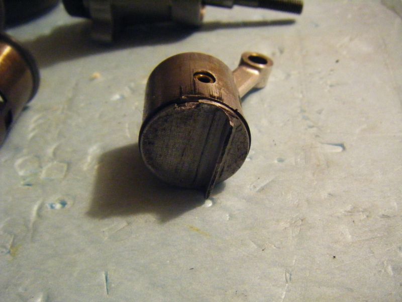

I recently acquired an older Webra .61 with a 5/16 venturi, plenty of healthy compression, of course the story is too good, I ran the engine on my test stand tonight and got one good run I ran it quite rich and it produced a health 2/4 break when lifting the nose of the stand up. After shutting down I discovered all that wonderful compression had gone away, and to top it all off the glow plug stripped out of the head.
So off to the workshop I go alan keys in hand I proceed to strip the engine apart, what I found was a chunk missing from the top of the piston near the cylinder, a piece missing from the ring, a very small amount of aluminum filings not enough to make up for the missing pieces, I'm hoping the pieces went missing over time.
Now here is the weird part on the intake side of the cylinder and the piston are two holes, they look like they where put in by hand, I will try and post a picture.
Can any one tell me if these are stock or not. And does anyone have a spare piston with ring and head laying around?

These holes are stock. The intention of these holes is to allow the incoming fuel/air charge to flow through the piston and keep it cool. OS used this design in their "Max" series.

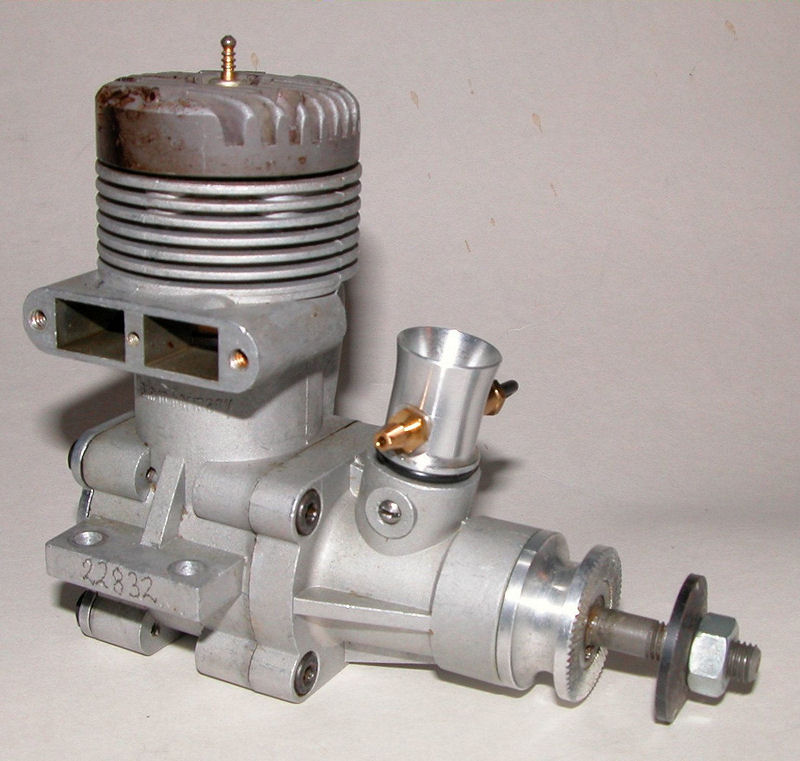

Quite a few of the earlier baffled piston engines had those extra holes. It helped with transferring the usually dead area under the piston, helped cool the piston and gave better lubrication to the top rod bush. The photo shows my Enya 60-IIIB piston/liner.

That "duration" on the holes in the liner, is it original? It looks like they were milled long from round.
Old 06-24-2009 | 11:15 PM
downunder's Avatar
Posts: 4,527
From: Adelaide, AUSTRALIA
Default RE: Webra .61 c/l mod?
That's how Enya machine the holes. This is a new re-issued 60-IIIB.

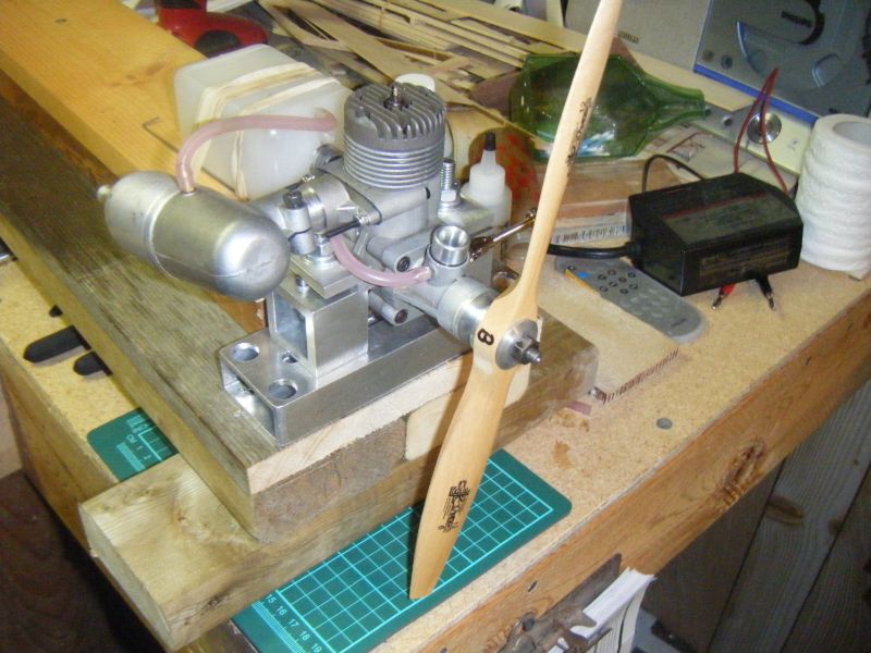

I have a Webra black head '61 CL engine too.

Hi Dan
Your Webra looks allot better than mine right now, is that a Super Tiger venturi?
