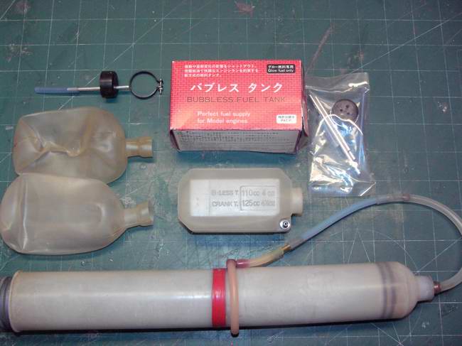

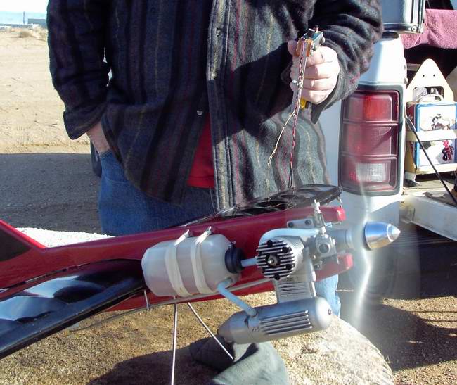

If you have muffler pressure avaliable, don't care about a four/two/four run and willing to go non traditional then you can find no better fuel system than a bubbless tank and there is no experimenting, guesswork works perfectly eveytime.
Avalible from Darrol Cady in 3, 4 and 5.25 ounces Here:
http://www.darrolcady.com/Tettra_Tan...tra_tanks.html
John

Old 10-07-2009 | 01:13 PM
Joined: Jun 2007
Posts: 1,009
From: Lake Worth, FL
Default RE: Need a fuel tank for a VooDoo
The tank I made looks the same general shape as the Brodaks mentioned. Feed tube exits top sheeting, and a pressure tap vent exits near the forward inboard top corner angled to the front at about 45 degrees. I tip the outboard wing down to fill and let it overflow out the pressure vent.
If I had to do it again, I'd add 2 more vent lines for fill/overflow (capped after filling) so I wasn't always removing the feed and tap lines to refuel.
