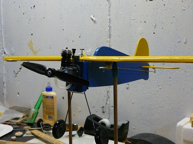

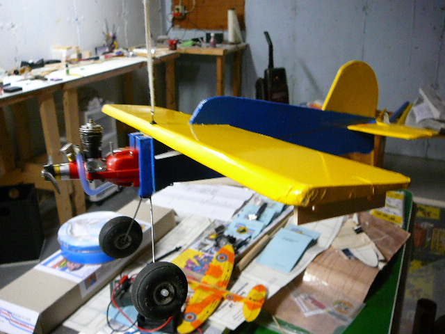

Getting back into CL after a very very long time. Just finished a great kit , Blackhawk Model, American Flyer and ran the engine through 3 tanks. I need to adjust CG. It is 18 inch span, 3 in chord, rectangular. The Curent CG , the way it built out is at 1 inch behind the LE . This is excatly where the Bell crank Screw is. I want a pretty forward CG to use it as a RE Trainer. The Drawing schematically shows the trainer CG like at the High Point on the wing at 0.3 to 0.4 inches fro LE .
I have attached some photos below. But it looks like it will take 2 ozs or more at the nose to move it half inch or so. Not much real estate at engine firewall to do that. Currently all up weight , reday to maiden before CG adjust weight is at 5.5 ozs.
Thanks in advance for all assistance and suggestions.

May want to try a metal spinner. It would be so far forward that you may not need as much weight.

If you are using a Baby Bee, switch to a Golden Bee or Black Widow The extra tank volume moves the whole engine forward.
While typing this, your pictures came up - I see that you have one of the external tank type engines.
Well, it will still help if you can switch to an engine with an integral tank. Also, heavier wheels. I don't particularly like 'heavy hubs' or anything added to the crank shaft, but sometimes it is the best solution.
You can also bend the landing gear so those heavier wheels are farther forward - the way they are now, this will most likely cartwheel on landing anyway. Over grass, it will probably cartwheel regardless of where the wheels are.

I really woudn't try flying this till you get the CG forward. Models like this fly best with the CG truly at the leading edge and I have seen at least a couple show the CG in front of the LE.
Having a model plane with the CG even slightly too far rearward will result in gross control problems wheras even if it is far too forward, just mushes the control a great deal but you still have positive control you can trust.
Electric3D, your model looks well assembled and painted. A joy to look at.
However I can see two mitakes that in the future you might try to avoid. Both of which have played a part of your CG so far back from where it needs to be. I think you went too heavy with the paint as well.
You can help by sanding all portions behind the CG. A lot. Much sanding. Agressive sanding. Then repainting with just a light coat of paint.
The left front wheel needs some care as this will not track in your favor.
Another potential problem is the elevator hinge. It must move freely. By this I mean that the weight of the elevator alone would be enough to cause the elevator to droop all the way down when at rest. If not you will have little or no control in flight. Without the linkage hooked to it you should be able to blow gently on the elevator and have it move all the way up or down.
I am so glad you have chisen to share this wonderful project here and am glad also you have run the engine before taking it to the flying field!

It seems from the photos that the model is covered with an iron on film so any sanding/lightening holes in the rear would be a fairly major undertaking. What I would do is to extend the nose to shift the engine forwards by gluing a block of balsa maybe 1" thick to the firewall then a layer of around 1/8" ply on the front of that to bolt the engine to. The U/C definitely needs to be bent forwards as far as possible (which will help the balance anyway) because it's sitting far too high at the moment which would make even taking off quite tricky.

What build light says about forward CG on 1/2A's is the facts of the matter. If you fly the airplane with CG where it is, when you rebuild it, you can extend the nose forward. There is a Higley heavy hub for your engine will help solve the problem. I would extend the nose as Downunder suggests.

Thank you all very much. I have incorporated all your ideas. Now the plane hangs on a string level ( a bit heavy on right wing due to tip weight). The airplane is mono Kote not painted. Now I hope that the TD 051 with a 5x3 prop starts. I had bought it in mid 90's flew ita while and boxed it up.
The plane now weighs 6.4 ozs or gain weight of almost 1 oz. I think it should be OK . Did bend UC forward.
Now to start the engine and maiden it.

Update : Great News . Plane flies like a charm. With a 3/8 ozs wedge tank tucked in in the right underside near the fuse, the plane flew great for what seem to be forever.The CG came out at 0.45 inches from LE just ahaed of the bellcrank screw. It pulls like crazy and I had to do nothing . It flies level from wing tip to wing tip and nose to rudder. Massive out pull. So the Right wing tip (mounted ahead of the the CG almost near the LE worked great. I flew it with 25 foot dacron line and the wind was clam, slight breeze every now and then to 7 mph. I had a 6 by 4 windsor black carbon prop. It goes fast. To train my flying buddy, we may just reverse the prop ? Maybe not, lets see.
Good trainer and I enjoyed my first flight.
