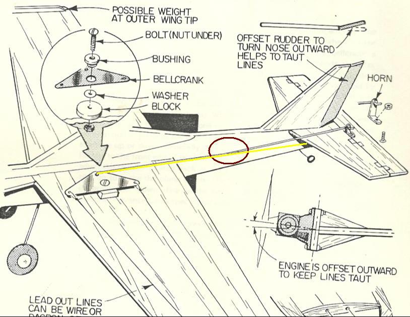

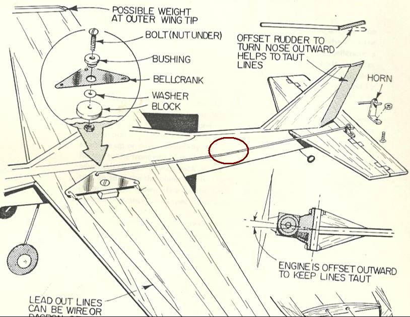

Guys. I find two conflicting scenarios here. See pictures at the bottom. The question is which is the up line ?
Is the line closer to the LE an upline or is that the down line ? Does it matter as long as the down line is perpendicular to the fuse ? Perils of a newbie ! I know, when I fly, that pulling my wrist back or raising my arm , the elevator must go up and pulling my wrist down or lowering my arm the elevator must go down.
So if the bellcrank is at the bottom of the wing and the elevator horn is at the bottom of the eleavtor, the line closer to the LE is down line. If you put the elevator control horn on top of the elevator it becomes a up line.
For a trainer which is better. Or is that just immaterail as long as elevatot corresponds correctly to the wrist action ?

As you've noted, moving the horn from one side of the elevator to the other reverses the direction of the elevator. Moving the bellcrank from top to bottom doesn't matter. Moving it so that the pushrod is outside the fuselage doesn't matter.
What DOES matter is that you have a little bit of sweep back in the leadouts - the leadout guides should be somewhat behind the center of gravity.

Yes as stated above it doesn't matter which line is the up line although usually the rear one is used for up. Do keep the line guide exit behind the CG and don't try to fly a tail heavy plane!!!

For a trainer plane I don't think it really matters which is up and which is down, but for anything else you want your "up" (aerobatics people refer to it more as "top" for 'top of plane') line toward the TE, and your elevator control-horn on the bottom - so you've got max line tension for "top-side" maneuvers.
Excellent points made already about positioning of the belcrank - slightly behind the CG is best. Your tip-line-guides definitely want to be a bit behind the CG, just a bit more than the belcrank to allow for line bow in the wind while the plane is flying. Adjustable lead-out guides are great too. That way you can adjust just exactly where the lines come out of the wing after a couple flights.

For a trainer plane it doesn't really matter if the "up" line is at the front or the back but for stunt planes it's always the front line for "up" because that arrangement helps counteract gyroscopic precession in a hard turn which tries to yaw the model in or out depending on which control direction you give it. "Up" yaws the nose out and "down" yaws it in.
Icolor code the leadouts at both the handle and the plane so that Idon't accidently get the wrong ones connected. Don't laff, I've been doing this for over thirty years! and I've seen folks with as much experience lose planes for the same reason; miss-matched lines.
A couple more things to consider:
Make sure your control system is installed so that if you pull on only one line you do not push or pull the control horn to the limit so that all of the weight is transferred to the stab/elevator.
If possible, you want the leadout positions adjustable. Different diameter or length lines will require different positions because if the amount of bow caused by drag.
It does not matter where in or on the wing the bellcrank is positioned, only where the leadouts exit the wing.

What determines which line does what depends on both the location of the elevator horn and the side of the bellcrank used to move the pushrod.
Jim Walker, probably, established the traditional layout, in which the pushrod connects outboard of the bellcrank pivot. In that case, if the elevator horn is above the elevator, pulling the front line causes UP elevator. Vice versa, if the elev horn is underneath, the front line causes DOWN elevator.
Downunder mentions gyroscopic precession effects. Think of a toy gyroscope. Spin it up and try to tilt the axis. It tries to turn as if it were pushed on the side 90° 'later' in the direction of flywheel rotation. The faster you try to tilt the axis, the more force it generates.
For trainers, or models less maneuverable than fun or contest stunters, this is usually no problem. For stunters with large, hefty props turning considerable RPM, often with fairly heavy spinners mounted, it can be a problem. The gyro effect - for standard rotation engines, flying counterclockwise when upright - UP gyro 'tends' to swing the nose out, and vice versa.
When we apply control motion at the handle, we want to overcome airloads on the control surfaces. That takes a shift of the pull force. In level flight, the lines each carry half the total pull. A sharp corner needs the loaded line to carry more force than the 'other' line. Half the shift is added to the 'pulled' line, and half eased off the 'other' line.
This shifts the point the 'middle' of the total pull force aims into the model. In level flight, it's like two kids who weigh the same on a seesaw, as against one heavy kid and one light kid. With unequal weight kids, the heavier kid sits closer to the pivot, and the lighter one further, than when the weights were equal.
So, with UP line forward, this pull shift moves forward, and partly counters the gyro tendency to turn the nose out. Works just as well on DOWN control - shifting rearward , opposite to the gyro tendency to swing the nose in...
Again, this is important for very maneuverable stunters, and much less so for planes that fly less demandingly. The complication is that to get UP-line forward, you DO have to either take the pushrod to the top of the elevator, or flip the bellcrank over so that the pushrod connects inboard of the pivot. Most stunt models keep the elev horn under the tail surfaces, so the bellcrank gets flipped over.

E3D, The guys who have posted before me have given you good advice though some is possibly far more advanced than you need for now.
There really is no written rule that I know of to follow and at the time the picture you supplied in your first post was printed the usual arrangement was to go with what was simple. Typically most half A models as you showed us have the up line at the rear and the down in the front.
I also believe the model shown in that picture was designed to have the elevator horn on the underside of the elevator. Since the stab and elevator are mounted higher than the wing, this would mean a simple straight pushrod with no bends in the middle and would make the rear lead out line the 'up' line.
Look closely at the pictures I have modified and you will see that the picture has been changed to show the elevator horn and its enlarged detail more clearly to the reader.
One could argue that the plane just needs the slight bend shown to link the push rod but I really believe it would be best to have the elevator horn protrude downward for simplicity.

Terrific Guys. Thank you all very much. Robert thanks for the explanation in pictures. i will print this thread out as future refrence. I am going with the elevator horn on this tariner below the elevator as the kit pictures show that. Will try the other way too and try and get an understanding of your explantions as I fly. I fly anti clockwise. Clockwise, I will have to give it a try.
Again, thanks everyone helping me to make it on my own. Maiden this weekend if the wind stays low.
