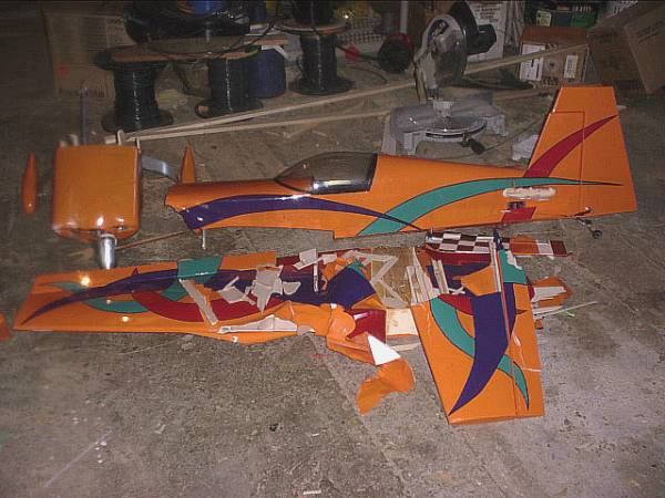

Flew my Midwest extra 300xs last Sunday.This is my first really aerobatic plane,been flying for about 3years . Took off smooth with engine (moki 2.10) running great! Made a few circles around the field to trim it up and was flying very stable and smooth. Had already run a couple of gallons of fuel on the test bench for break-in. I took it up to a safe altitute and did a couple of loops at about 1/2 throttle. On the forth loop I throttled up a to about 3/4 throttle and on the back side of loop I heard a awful fluttering sound. I immidiatly throttled back but it was too late the plane coming apart at the seams. I can only assume that my servos were not heavy enough. I was using s3010 on airlones and s9001 on elevators. Can anyone help me with an explanation? I put alot of time into trying to build this airplane strong. Sealed all the control surface seams. used the kits control arms.

Sorry for the loss. It looks like a beautiful plane. Let's look at what you had:
Futaba specs - 9001
Torque: 54 oz/in @ 4.8V
Futaba specs - 3010
Torque: 72 oz/in @ 4.8V
Midwest Extra Specs -
SPECS: Wingspan: 80"
Fuselage Length: 72.5"
Airfoil: Fully-Symmetrical, Low Wing
Wing Area: 1162 sq. in.
Weight: 14 - 17 lbs.
A 14-17lb plane does not have a chance with 54oz torque servos. Even the 3010's with 72 oz on ailerons is not enough. When you come around the back of a loop, and the G'S start to kick in and your 17lb plane @ 3 G's now weighs 51 lbs, the 54oz servos are toast trying to move and hold the flight surfaces.
I have a Great Planes Patty Wagstaff Extra with similar size and weight, and I remember the manual specifically stating that minimum 90oz servos are mandatory. I fly JR and have 8411's (155oz) on the flying surfaces.
I wish someone would have warned you before flying it that those servos were not enough. I'm surprised that Midwest did not have a warning in the manual.

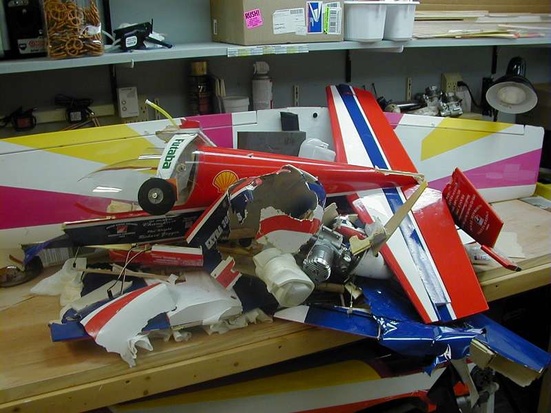

Hehe...I had flutter with my Midwest Extra 300 a few years ago...here's the carnage...and the rebuilt afterwards...
