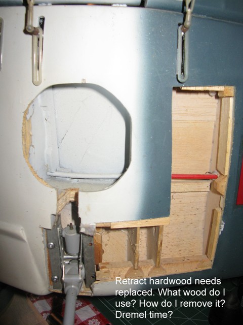

I want to repaint a corsair after some minor work is completed. The problem is, I don't think I can match the paint. What is the recommended approach to this problem? Do you sand the old paint? If so, what grit sandpaper and how would you do it? I also had to purchase a new canopy for it. If someone could provide a link to the best way to paint a canopy, please post it. One of the landing gear mounting blocks is broken. What type of wood to I replace it with?
Thanks for any and all assistance.

For the hard wood mount you can use Spruce blocks 1" X1/2" or so.

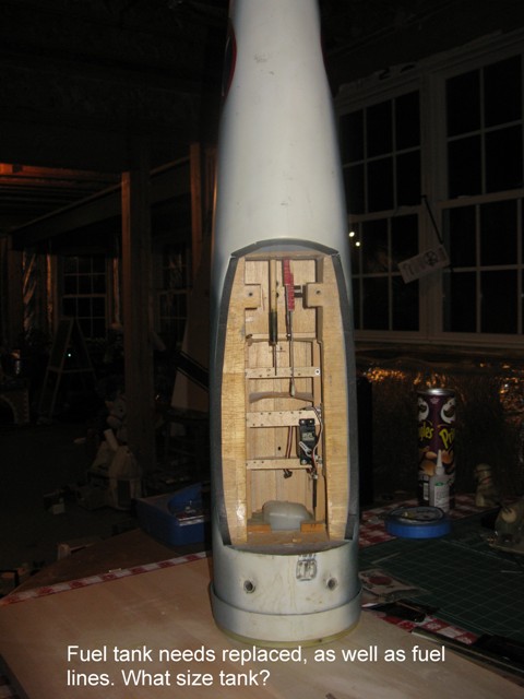

The tank can be used for Gas BUT you will have to get a kit that replaces the Plug and all gas lines are Tygon. I can't tell how large that tank is. My G23 has an 18 oz tank and I can get air time in the 20 minute range.
If the motor mount is strong on the plane and if it has a back plate for mounting straight to the fire wall. Mark your mounting holes and drill your holes to match and then install your blind nuts in the inside and bolt the motor to the fire wall.

Thanks Hunster. I think I will invest in Lado retracts, to save myself some headches. On the engine install, it is a 10oz tank. I could prolly fit a 14 oz in there. As far as the engine, doesn't there need to be some right thrust built in for the G20ei? I am used to an ARF and all that is built in. This is a little diffferent.
