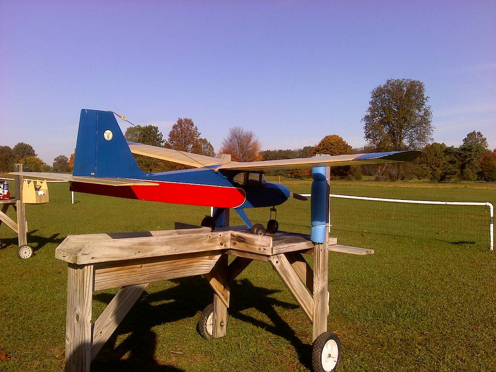

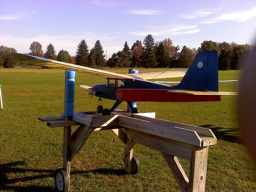

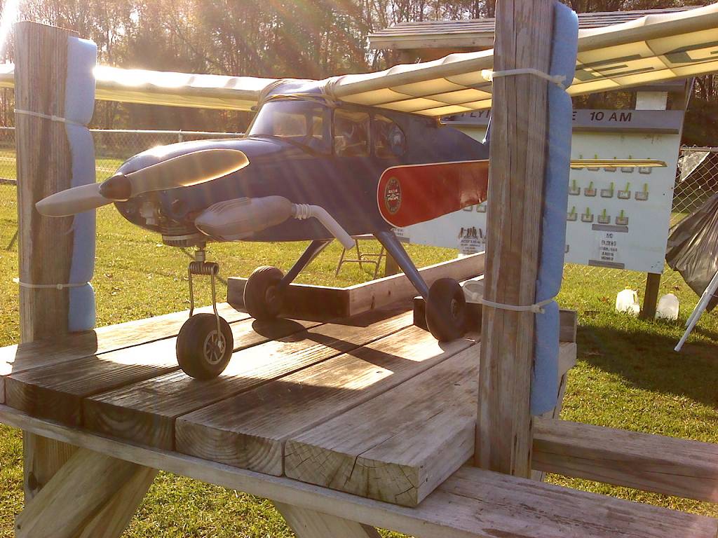

Sorry Seamusg,I didnt mean to take so long to reply.I fly at the Corsair Model Airplane Club,which used to be the Goodyear Model Airplane Club.We just moved to the Kent area from the old fairgrounds due to the metroparks not wanting our hobby anywhere near their new parkland.I also fly down in N.Canton from time to time,but CMAC is closer for me.I live just up the hill from main and G-year blvd here in the heights.Here is a pic from this morning,first guy at the field!
Thanks for the tips guys! I was unsure of my modeling and flying skills after being away for so long,but you helped me brush off those cob- webs and get me in the air.

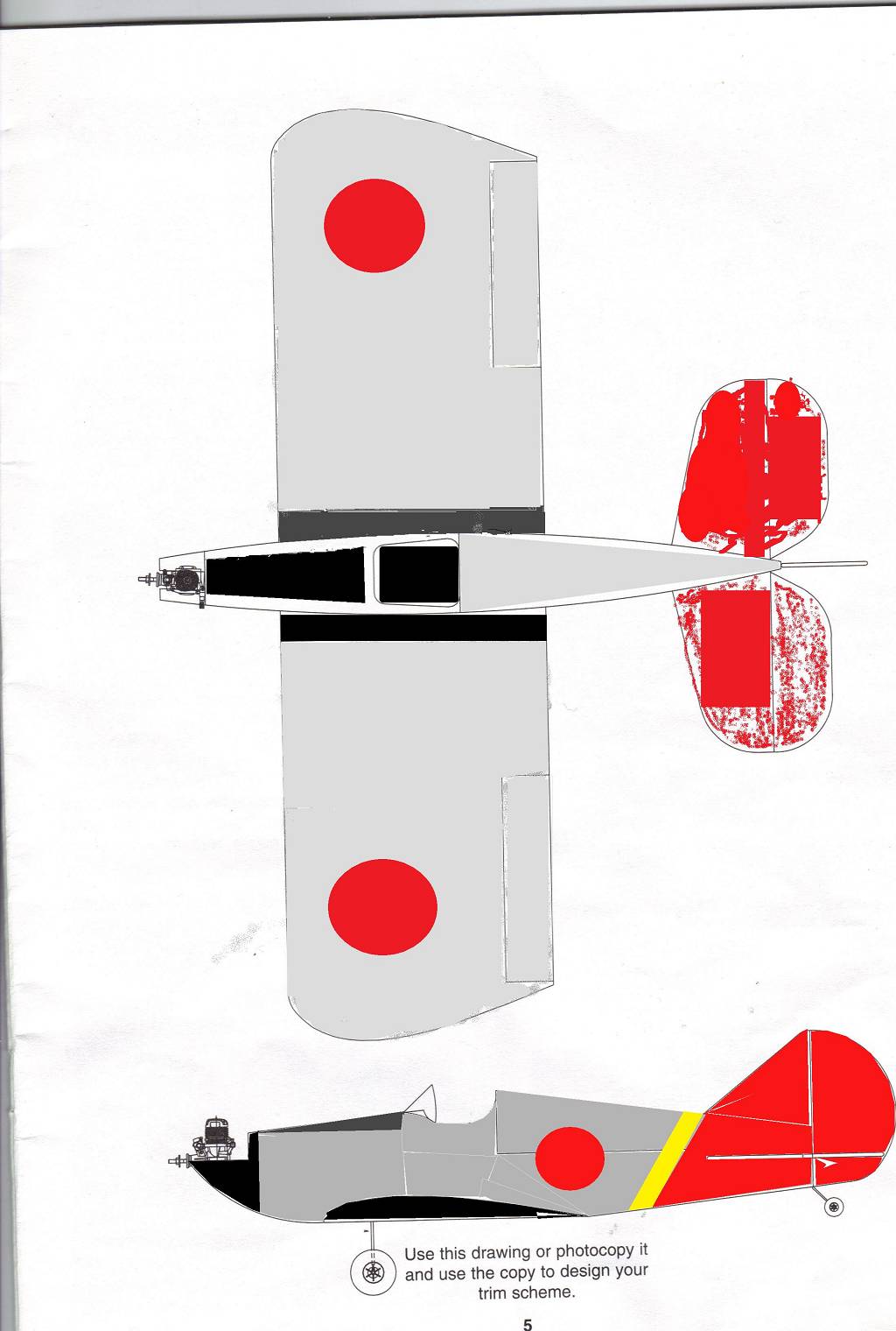

Ok guys,I'm back at it again. After a season of flying the Senior, I wanted to move on to a low wing aircraft. I was planning on building a Slow poke 40 kit this winter,but it was too darn cold in that basement! BUT I found one at a swap meet just recently.The covering isin rough shape with lots of patches and fresh hanger rash that needs patched.So I was thinking of strippingit andmaking my own with a new finish.There's a thread over in sportflying showing some cool cover jobs on slow pokes,and I've been inspired. ButI do have some questions.
Such as,how do you recover the control surfaces? Do you cut the old c/a hinges, recover then rehinge? Or can you somehow get an iron down in the gap enough to get the covering to stick?
I want to make it resemble an old am5 Claude japanese fighter from early wwII.Silver body with a red tail.Whats the best way to cover the open turtledeck on the 'poke' with the 2 color transition?
I'm sure I'll have more questions,but I feel like I'm rambling allready,so I'll stop for now.
Here's what I want it to resemble...

Old 03-11-2011 | 07:50 PM
zippome's Avatar
Joined: Nov 2008
Posts: 394
From: Akron, OH
Default RE: Question about a refurb.
Sorry about the splotchiness.The paint program and I werent getting along...
Old 03-11-2011 | 10:06 PM
OzMo's Avatar
Posts: 2,694
From: OZark, MO
With a little care u can recover ailerons and such while leaving them on. One (theres many) method is to cut notches out of the pieces to go around the hinges.
Watch the wing trailing edge on those when covering it may need some stiffening.
