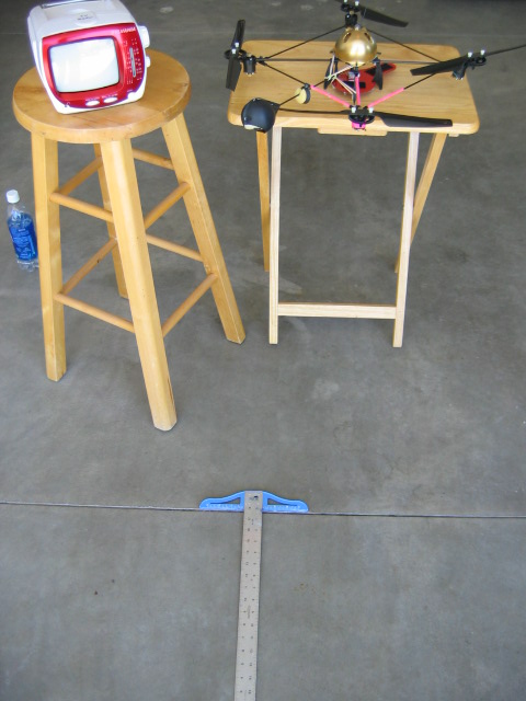

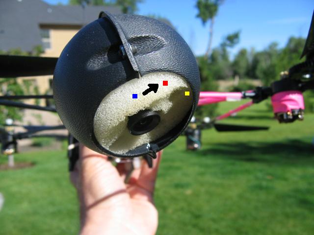

I've decided to set the camera at about 45 degrees downward, and try to leave it there. We'll just have to fly accordingly. I set the camera angle by aligning it with a seam on the garage floor. Here's what it looks like. Also I couldn't resist the gold color for the dome!

I'm assuming that where the foam is protruding is the top. So, if you slighlty spin the foam clockwise, you should have a level frame with that perspective. Do you think the metallic particles in that paint could affect the Rx?

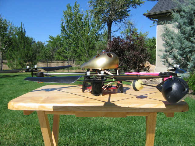

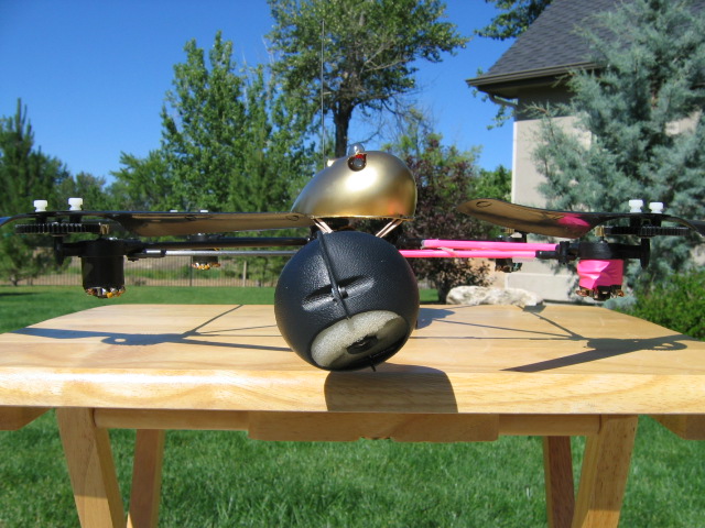

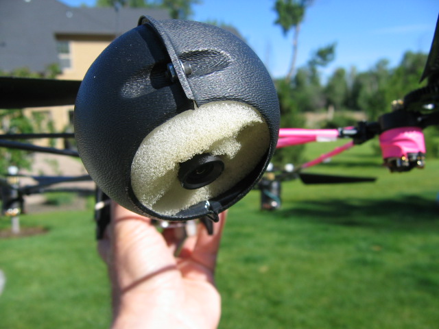

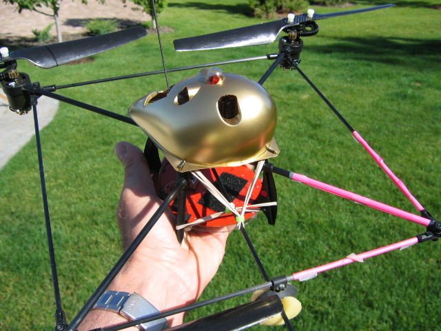

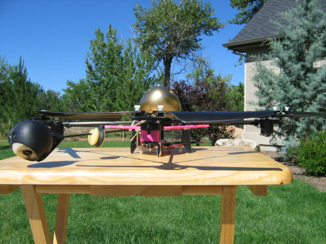

Is the configuration of the camera in your original image the way it was in the video in post #1? Not knowing the top of the frame is what's confusing me. So is the the blue dot considered the top of the frame? If not, is the yellow the top? If the blue dot is the top, then by simply rotating the foam clockwise from the blue to the red should give you a level frame. If red is the top, then never mind.
Joined: Apr 2007
Posts: 273
From: Eagle, ID
Yea, that picture is pretty confusing. Here are some pictures taken from directly in front, at a 45 degree angle looking down the camera mount arm, and directly from the right side. The last picture is how I aligned the camera. First the camera pod was set to point downward at a 45 degree angle. Then the SAVS was set on the table with its arms horizontal/perpendicular to the seam on the floor. The T-square was placed perpendicular to the seam, and directly along the forward axis line of the camera (7 1/2" right of the DF center line). The camera was adjusted so that the seam was horizontal and the camera was looking straight forward, down the ruler. This angle seems to be a very good compromise, and hopefully we won't have to change it too much. I'm editing some video bits shot with this angle and I'll post them in a little while.

ORIGINAL: Sky High
Okay, so the way the camera is positioned in those images is NOT how it was positioned in post #1's video, right?

That was much better and it looked more like a news helo looking down at a sharp angle while over that house. So, the reason it was crooked in the first video is because you tried to align by sight or guess and didn't quite get it.
