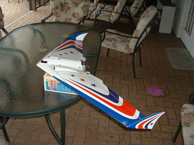

I just bought and flew a Slinger from Great Planes...it is awesome. I had trouble with the rx, I think it might be too close to the motor. Does this sound like it makes sense?? Also should I solder capacitors on the motor.
Also does anyone know of an easy brushless upgrade with a link. I am flying 3s Kokam.

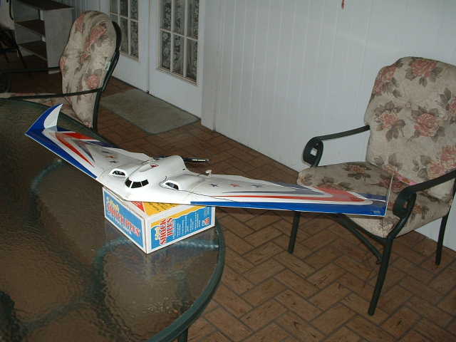

Awesome setup Greg. Nice review and video.
I can't believe how much I like this plane, I only wish I had bought it earlier and saved myself alot of time and money.
Did you glue the wing sections together? Why didn't you use the wing center keel?
I broke off one of the wing tips due to a crash from interferance. I was thinking of velco ing them on...do you think it would work?
Thanks for the reply, I am getting your recomendation for the Kontronic set up.
Joe
ps. (edited) I already have a Himax 2025 brushless setup with a Jeti 18 amp in another plane and was wondering if you think it would be an ok fit for the wing. It looks like it would fit with a little foam shim and wire tie.

RE: Slinger/Brushless
Joe,
I did glue the wings together and found that the extra keel was not needed.
Velcro will work fine for the tips. Use the Industrial Strength Velcro.
The Himax 2025 should work fine. It won't have as much power as the Kontronik 400 but should still beat out the stock Speed 400 by a longshot.
Good luck!

Use a Himax 2815 3000 it is the best speed 400 replacement that you can get for the money, the best is the Aveox 27/13/3 it is about $30 more but it is about 8mph faster. I have used these setups in the slinger and the zagi and it is a marked improvement over the stock setup.
The slinger will not last long stock with a brushless setup, the best thing to do is strip off the monokote and use strapping and packing tape it does weigh more but it will withstand the G's

I just picked up the Kontronic setup that Greg used too. I am balancing the plane right now.
It is a 3.2 mm dia. shaft on the motor, I picked up one of these...
MJ4702 COLLET PROP ADAPTER 3.2MM from www.hobby-lobby.com
If you cut the stock number and paste in the search box on the site...it should come up; otherwise look under prop adapters.
I am still a newbie but I recommend picking up a few wing tips too, I already broke 2 they're kind of brittle.
I think the prop is a 5"X 4.3 but check the writing on the stock prop to be sure. Any prop that size should work.
Also had problems with servos getting loose. And I seem to need alot of weight in the nose to balance wing.
I think that it is due to the lack of weight of the Kokam 11.1/1500mah batteries.
I had a Himax 2025 in the wing and it was insane, 70-80mph. I can't wait to see it now.

I sent you an e-mail on your CG problem. The Kokam 1500 pack is not a good choice here since the setup draws 20amps at full power. I am using the heavier 3-cell Kokam (15C) 2AH pack in my Slinger not the 1500 pack. The 2AH pack delivers 30amps continuous and packs way more power!

I had a 2025-4200 in my slinger...it was really fast. I would say close to twice as fast as stock, people in the park thought it was carrying Hellfires.
The good thing was that it was lighter than stock so it needed less lead in the nose. But I thought that due to the smaller diameter it would need to bo modified to get the motor up so the wing wouldn't rob as much airflow. My first attempt was a quick on the fly adaptation. I shimmed it up with some foam and an extra wire tie. It flew great but because the motor was actually insulated now, it got hot and melted the foam away.
The second time I glued two 3/16" X 2" bamboo sticks at the bottom of the motor compartment pointing for' to aft and that worked fine. Be sure that it still has the built in thrust angle (prop end higher than battery end) or it will never take off.
Also the motor will get pretty hot if you're flying fast but it will be such a dramatic difference you seriously won't need to keep the throttle up for long. 1/2 throttle is faster than stock.

Maiden the Slinger today, WOOHOO!, flies great, I added 1oz of weight to the nose, track pretty straight, it didn't seem to have a lot of speed, maybe 'cause it was too windy or the lipo did't have a full charge or mabe it need to be proped diffrent. I'll try again next weekend.
