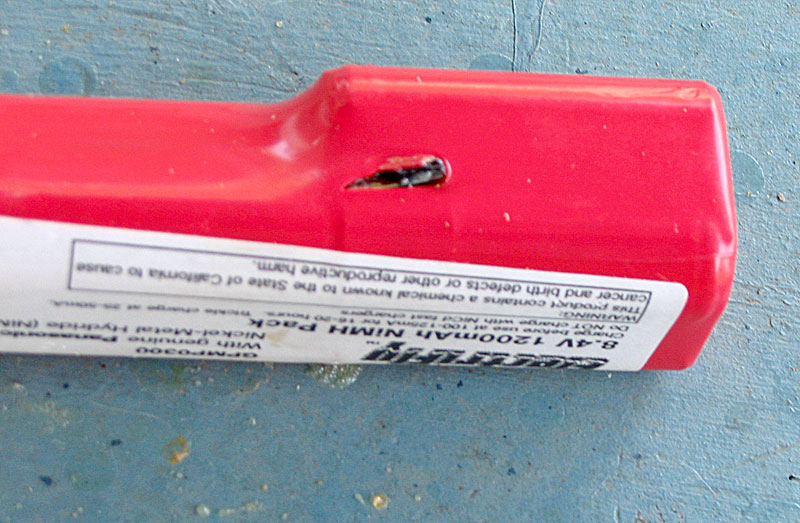

Hi. What do you suppose caused this pack to self destruct? I'm guessing I drew more amps than it could deliver, but that's just my guess.
It was a Great Planes 7-Cell 8.4V 1200mAh 4/5AA NiMH Panasonic plugged into a Great Planes ElectriFly T-600GD ESC System w/Gear Drive. I have no idea how to find out what the discharge rating of Great Planes packs are. I even checked the Panasonic site. I 'm under the impression that I need a pack that can deliver 25 to 30 amps and I have a feeling this pack was probably rated around 8C or 10C although I have no way of knowing. 10C would only be 12amps and I'm sure I exceeded that.
Thanks, David

It would appear from the picture that there may have been a bad solder joint or bad weld on the interconnecting strap, causing it to heat up and burn through the sleeve. I doubt if the cells were at fault in this case.

Thank you, Red. I know I need to break down and buy a watt/amp meter to find out what my electric systems are doing. But, until I get around to that (I'm new to electrics) is there a way I can find out what the discharge ratings of NiMH packs are? I've noticed that almost all Lipo packs provide such information: 15C, 20C, for example. The motor I have came with a 30amp ESC so I'm assuming it's capable of yanking over 20 amps out of a pack. With a 2000mah NiMH pack I would probably need a rating of at least 15C (30 amps).
In the meantime I will send my photo to Great Planes and see if they will replace it. My experience is that they are very good about taking care of people.
Thanks again.

Well, I got a pretty fast response from Great Planes tech support. I was told by them that most sub-C NiMH cells can safely discharge at 20C. That's much higher than I expected.
