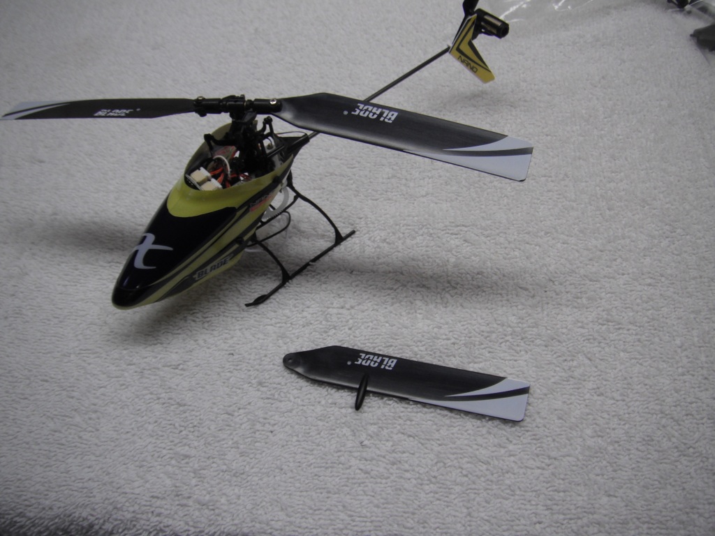

What is the difference between the two blade styles shown in the picture? Advantages, disadvantages, etc.

From what I was told the blades with the small bullets smooth it out and make it fly better but some say it dampens it down too much. I never tried them, but may.

Interesting, it's worth a try. Thanks!
