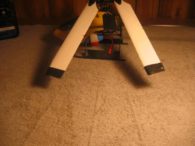

SCARY EVENT:
Hi Guys,
I was out in the garage tonight, practicing hovering and short forward and backward flight. After about 10 minutes, the heli acted totally weird. All in a split second, I heard a pop from the heli, saw something fly off, and hit the wall next to me no more that 2 feet away. I thottled down, trim down and hit kinda hard (broken skid, no big deal).
Here's the deal, I'm sure we all do these. After a blade hit and damaging the end of the blade, solution, black tape. Of course you have to add same amount to the other blade to keep them balanced.
I knew this but never gave it any thought, at the end of the blades, inbedded in balsa wood (flat blades) is a small piece of lead weight, a litter bigger in diameter than the lead in a pencil. This is what flew out of the end of the blade and almost hit me.
Guess, I may change blades more often.
The first picture looks like a normal set of blades, with black tape to fix repairs.... The second picture are the blades after I removed the monocote and removed some of the balsa wood. The blade in the background has the lead weight, the front on doesn't, that's what flew out at high speed and almost got me. Whew!!! Luck me, I didn't get hit.
Dave / Choppersrule

When I repair a blade I always hit the end with CA before I put any tape on. If the weight is showing I trash the pair. Haven't had a weight fly out yet, but anytime you repair them you take that chance. Use common sense, I know there are guys out there screaming at the top of there lungs "Never repair blades!!!!" but I'm cheap and if there's a chunk missing I trash them. Split monocoat happens with practically any scuffle. I've had brand new blades come with split monocoat.

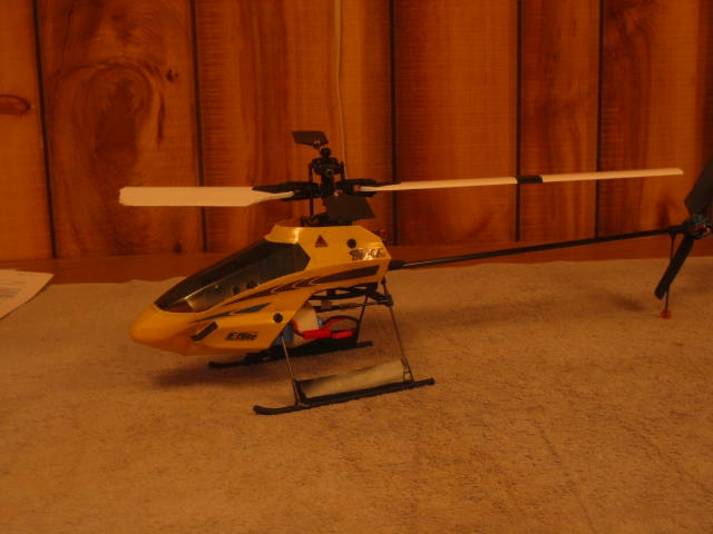

CLEAN CUT:
Hi Fellas,
Remember the other day when I had a lead weight come flying out and almost hit me. Well, I balanced a new set of blades, and the next day was out in the garage again practicing hovering and short forward and backward flight. Everything okay, so far.
About 8:30 PM, I noticed outside it was dead calm. Took my CP to the back 40, having a ball. Ten minutes or so into the flight, I was about 20 feet in the air and a puff (gust) of wind blew the CP. With my fingers moving as fast as they could go, I lost it and crashed into one of the uprights of my woodedn deck.. It sounded absolutely horrible, KAPOW, SMASH. I have lots of practice, throttle down and trim down immediately.. I think I can do it in 3/10ths of a second.
I walked over to pick up, which looked like a total from 20 feet away. Low and behold nothing more than 1 broken blade. Boy, is this a tuff heli, not the easiest to fly but rugged.
See pic of a clean cut,
Dave / Choppersrule
