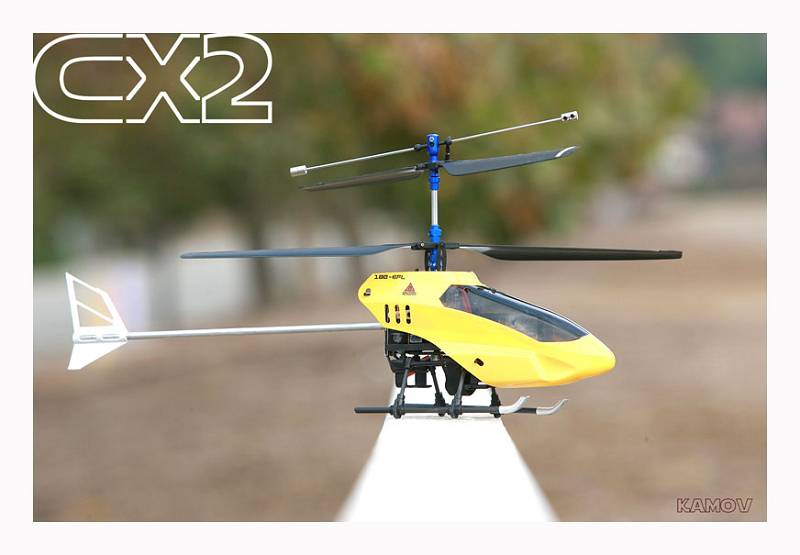

you can make your own skids if you have the tools or the time and like modding i know you can buy them cheaper but its much more fun making them..
made mine out of CF tubes/rods and alum tubing.
...btw i made the tail boom as well from 89 cent alum tubing...the plastic fin is from another heli accessory.
the black thing hanging under the battery tray is the velcro battery strap to hold the battery to prevent the tabs from breaking

What did you use for linking the vertical down supports to the horizontal skid bases? Looks like some kind is link. Was it cut from any CX parts? I have lots of 1/8" CF tubing and some 5mm CF tubes. I'm going to make my own and it looks easier than dremeling holes in the 5mm to CA the down rods. I'm trying to create an exact copy of a Hughes 300 with my CX. Already did the canopy and boom and it's looking real scale.
Old 09-20-2007 | 06:08 PM
Joined: May 2007
Posts: 175
From: CA
Default RE: Blade CX skids?
ViperRR
those are just drip irrigation T-fittings from hardware stores or Outdoor Sprinkler supply stores ...lol...
Aquarium T-fittings from pet store might be another source.. im pretty sure you'll find one that fits your needs
i've seen someone use alum tubing and soldered or glued them but thats for a Hughes 500 type heli
hey we'd like to see a photo of your project and give us tips..lol..
