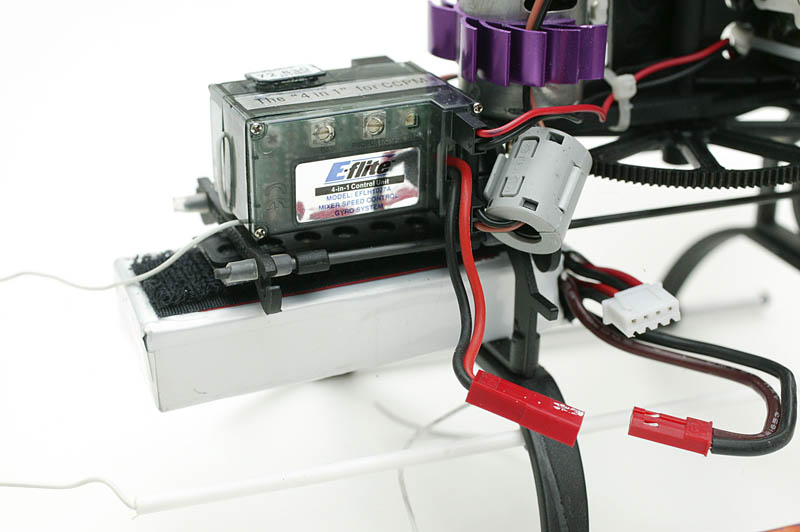

I did the same thing as the last 3 posters. I just want to clarify that you are reusing the stock BCP battery tray platform. I've got velcro on mine. Toss the two crossmembers that force you to use rubber bands. (that is if you are using the skids from HD....I don't know what sort of battery hanger comes w/ the 'superskid' brand)
Here's a pic to clarify.
In case anyone is wondering....the grey can on the motor lead is a ferrite ring, said to reduce RF noise and hence, glitching. Might be voodoo, but it was cheap. However I've not had any problems after adding along w/ the antenna routing. Yeah, I did two things at once.....not a very scientific method. I suspect unwiding the antenna was the real reason.
Drphoto,
I have the Super Skids V3, from the super-skid.com brand. It has the same battery crossmembers that makes you use the rubber bands. I installed them, after about three flights, I dumped them and went back to velcro like you.
I worked at the phone company for 29 years and the ferrite rings do work, the telephone industry buys them by the truck loads.
Good Idea! Who would have 'thunk'.....It sometimes amazes me, that the inexpensive mods, seem to work very well.
Dave / Choppersrule

Why not run the tail wires through the ring too. Is that a $20 heli direct batt you got their? HOw is it working for you I bought 4 worked for awile and then they were junk.

Default RE: heavy tail problems
Yup, that's a 20 buck special. Has worked fine, but I have noticed flight times have started to get shorter recently, so maybe it's starting to crap out. Of course, the motor might be wearing out too. I don't have any battery test equipment. I don't regret buying it though. Got me through the tail in hovering learning curve.
