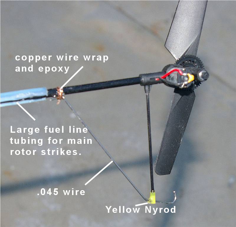

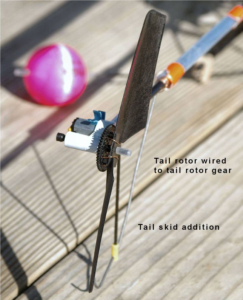

I just got the blade cp pro the other day, its my first helicopter ever. The tail rotor seems to have a plastic tube piece holding it against the gear, is there a better way to secure it in place? It seems to work it self loose after a bit.

A nice little "button" you can make comes from a plastic clevis used on airplanes, etc. Just cut off the piece that has the hole in it, trim it to match the other side, so that it is round. Ream it out so that it will fit over the carbon tail shaft. I use fuel tubing against the tail rotor, then push this against the fuel tubing. It provides enough bite in the carbon fiber that you shouldn't have any more problems.
Old 11-13-2006 | 11:54 AM
Joined: Jun 2002
Posts: 5,211
From: Palmdale, CA
Default RE: Tail Rotor ? Blade CP Pro
The tail support strut digs into the ground and lets the rotor hit. After doing these mods, I haven't had a tail rotor loosen.
