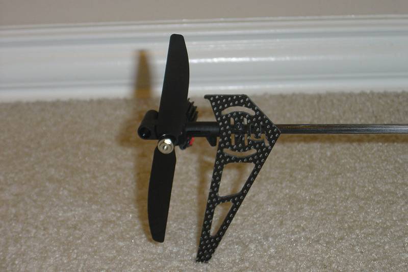

I pretty much wore out the brushed motor over the last two months, so I upgraded to the 370 this weekend. I went ahead with a headlock gyro as well. Still learning and mostly hovering only at this point. After the upgrade, something is not right with the new gyro or who knows what??? Full right rudder won't stop the clockwise rotation when I run up the rpms. I've double checked the instructions and things look right. Any ideas would be welcome, or can someone send me some troubleshooting tips. I plan to bypass the new head lock and put it back on the three-n-one unit tonight to see if it still works right. The only thing I must fess up is that I didn't have a 8 tooth pinion and used a 10 tooth one instead. I don't know much about helis yet, but didn't think that would matter much. My tail motor seems ok, but I really wouldn't know. It stops when I give it left stick, and runs when I give it right. Maybe it's wore out too and don't have the necessary power to counter the brushless torque?? My local Hobby shop is worthless. I know you guys can help....I missed my little heli all weekend. ;o(

YOu may also want to check/change the tail rotor motor. They are notorious for failing. Dco

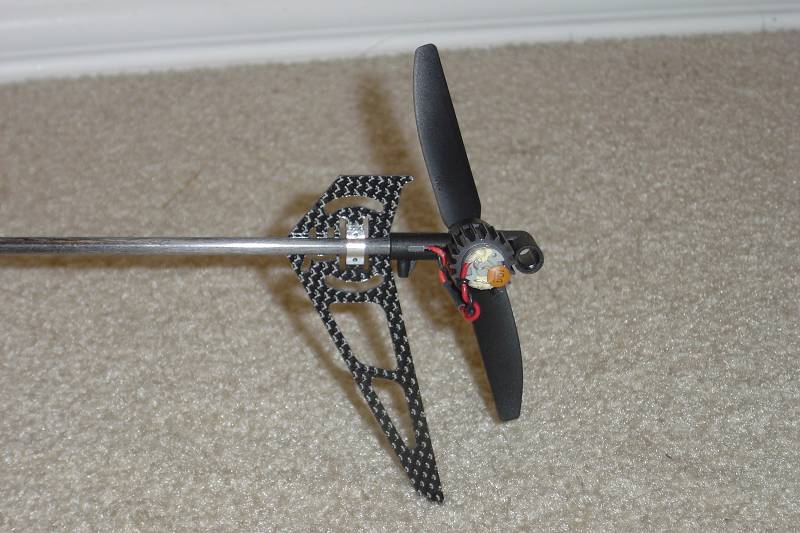

I would almost guarantee it is the tail motor.
Get the GWS CN12-RXC, bigger motor with the direct drive prop w/ adapter GWS H001FD030B, heat sink is like 2 bucks, and you will be amazed with the improved performance. You have to dremel the stock tail mount just a bit, but it will fit in there nicely.
The fin is microheli's for about 12 bucks...

I JUST did the same mod but used the stock tail housing. I think the GWS 3x2 prop is a better option. The prop presses on the shaft and seems to be VERY responsive with plenty of authority. Also, the motor doesn't get hot. I've only hovered in my basement with the new setup (It's dark out) but the tail is LOCKED solid in HH mode. I hovered for about 1 minute and the nose didn't change heading one bit, didn't even have to touch the rudder.
I'll have to fly it before I'm sold but I think I have a real winner.

that gws motor will get smoking hot with that 4030 prop if you fly for a full pack. a 3030 will keep things cool and it will still hold fairly well.

O.k. When you remove the stock motor, if you look at the hole in the mount it fits in, the left side is partially flat.
I used a new 2mm drill bit and shaved it round. Make sure the brass ring on the motor around the shaft actually pushes THROUGH the bigger hole in the mount, if it doesn't, the screws won't grab and the motor is not seated good in the mount..
My screw holes were already enlarged slightly for my dual motor setup, so you may need to enlarge them slightly, but maybe not..
I used a dremel cutoff wheel to cut the stock CF tail boom support off smooth with the boom..
Slap on some kind of fin and your done...
As far as the 4530 prop... The GWS dragonfly II comes with this setup stock, so I would think that motor life should be pretty good with it on, it sure has one hell of a piro rate.
