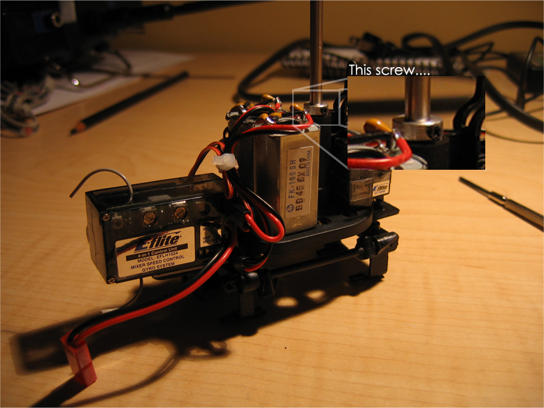

Soo here's the deal, last week I crashed my Blade Cx-2 and I broke my Inner Shaft Head. Soo i change it for an aluminium one. Then when I went for a fly, My heli kept moving on it self to the left side ( Rotating ) not a lot but still... Should I mention that all my minor adjustement button are to idle... Add to that when I start my motor ( bery slow speed) my lower blade start rotating before my upper one ( That's why it keep rotation to the left ). ALSO when my motors are at very slow speeD (when my heli is still on the ground ) I can see my heli "shaking" a bit. I can see that the outer shaft looks to be the reason why...
I started to dessasemble my Cx-2 tonight and and other prob came up, CAN'T Pull out my outer shaft cuz of a screw ( look at the pictures ) I wounder that maybe some of you guys might know how to put it out and also if some of you think that the prob is coming from an other part, might be helpful to tell me

Yeah, just remove that screw from the shaft retaining collar (the silver thing) and the whole thing slides off the top of the outer shaft.
Pull the outer shaft down through the bottom of the body, be careful not to lose the bearings.
Check to see if it's true. (Hint - if you have a hard time getting it out of the bearings, it's probably not true.)
Buy a new one, and lube it just a LITTLE bit, like a thin film, with some sort of machine oil from your LHS and you should be good to go! Also, I'm pretty sure my lower rotors spin first also, will have to check on that.

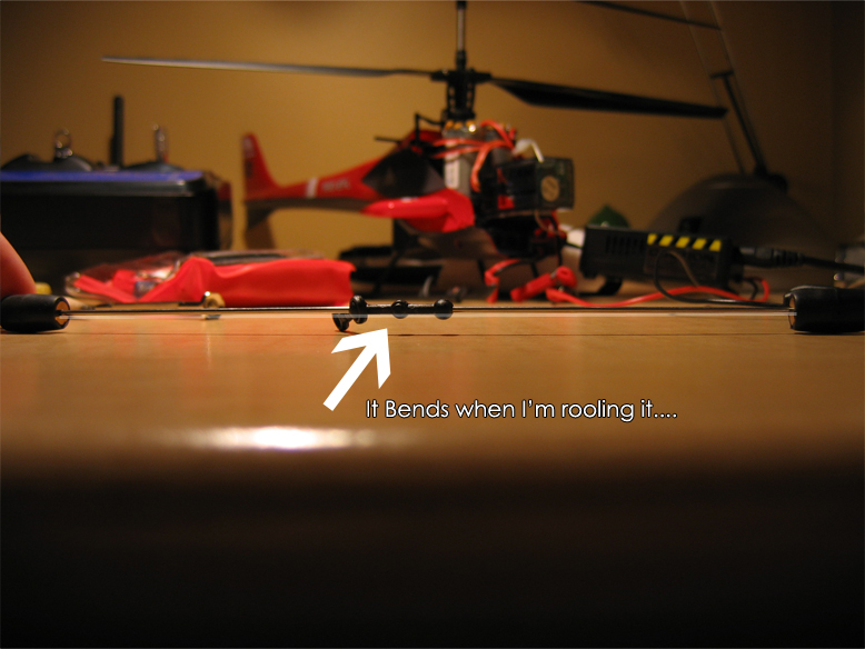

I've try to see if my Flybar was bend and actually it was a little... When I'm rooling it, there's a siede when the middle is about 5-6 Milimeter higher then the other...
Do you guys think that it might be the problem?? Could it be why it vibrates???

Straight flybars on the CX2 are very critical, either try to make it perfectly straight or replace it. These helis are small and anything just a tad bit out of alignment will cause major problems.

Just for fun, try..... take all the blades off and spin it up, (leave flybar on) if stll vibrating, good chance the flybar is a tad out of balance.

If you guys really want to balance this heli, you need to take the inner shaft w/flybar, link, and upper blades attached,and balance them as a unit. I know, the flybar has a little slop in the holes, and it will take a little while to get both sides the same, but it is well worth it, and way better than balancing them seperately.That 2 gram link arm to the upper blades, at 1600 rpm will throw a wrench into the works, see?! 1 inch or so off the center of the shaft, at high rpm has got to have an effect on balance. Don't get me wrong, I got one at x-mas, and love it, they fly good out of the box, but if you go through it and "blueprint it" they are awesome.Oil all contact points (balls and arms, shafts)I oil everything except the gears, and the flybar, it's loose enough. And carefully balance all rotating assemblies as a unit, and you will have a most awesome flying machine!No binding in the shafts is a must!!! You can have slightly bent shafts without much binding, so be aware.If everything is balanced, you shouldn't have much shake at any rpm.
