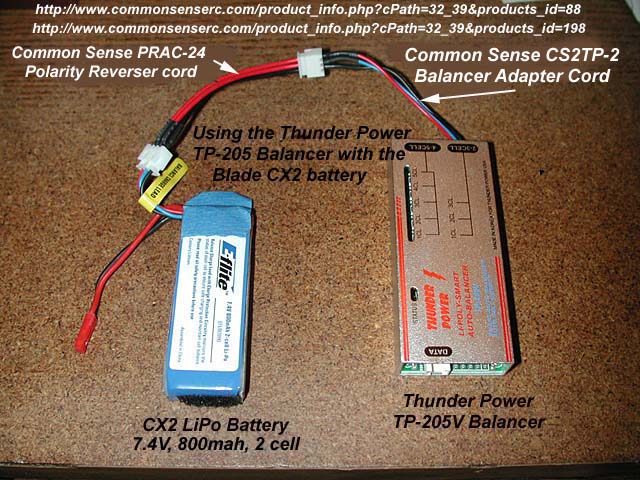

Default RE: CX2 battery - TP205 Balancer
It works perfectly!
The only thing I don't like is the connector adapter block into the TP-205 is a (3) pin...the TP Balance Port is a (4) pin - so you have to be careful to connect it to the correct pins in the Balancer!
You must reverse the polarity!
