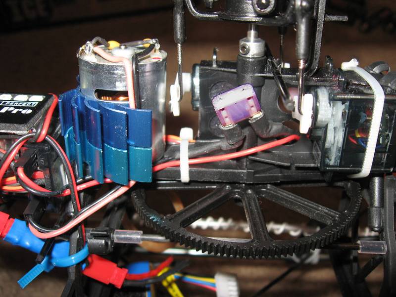

Hi, I just got a cp pro and installed training gear, added an extra set of weights to the fly bar and was given some advice to move in the rods on the servo arms. I was wondering what adjustments I would need to make if I move the arms on the bell hiller head in on the servo arms? how far should I move them in? Also I read a thread about putting a 7amp fuse inline on the main motor and a 2 amp fuse on the tail motor. Does anyone have pics of this mod? I'm not sure what they look like. Where would you pick them up?

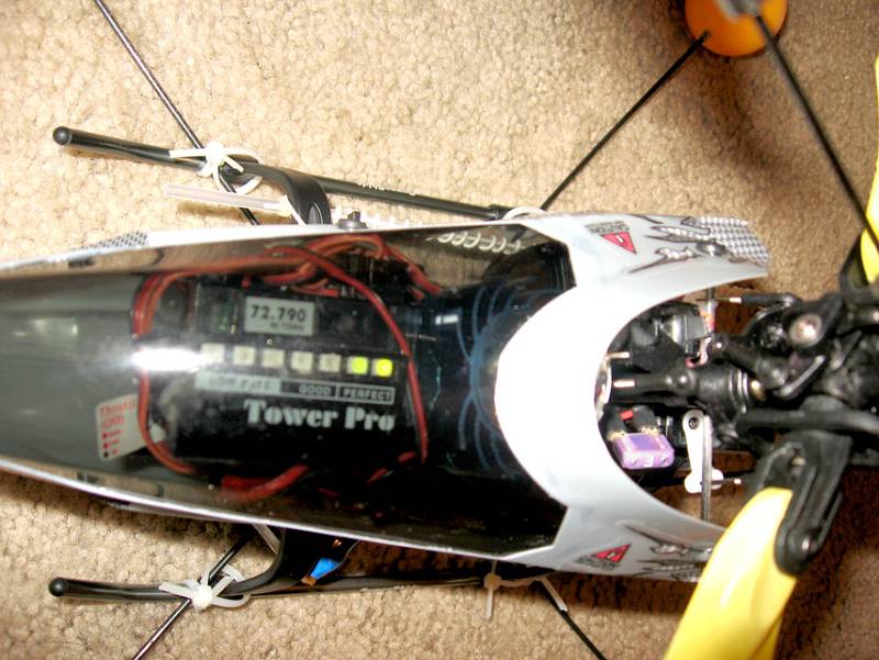

I haven't done the main motor mod yet, but here is a pic of my mod. I got all the parts I needed, including the spade connectors at the local car stereo shop. They were like what are you using this for anyways, I said an RC heli. They were pretty impressed and talked to me about it for a few min.
I use a 7.5A for the main and a 3A for the tail, although a 2A on the tail might be better. Som people just solder it in, so that there is less chance for failure, but I like the quick disconnect because I can change it out at the feild, and usually I don't have the ability to run a soldering iron where I fly... I have a pdf on it written by SSG Scott... if you want it PM me with your e-mail and I'll send it to you
Whatever you do... do not put the resistor that alot of people talk about in-line with the fuse and tail motor. If you want to know why I can explain it... but it's just a bad idea that's been implaced by people who don't know enough about electronics.
