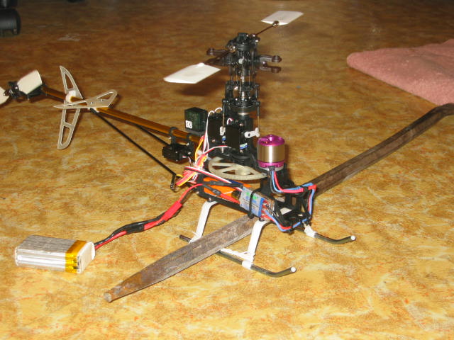

What are reasons to cause this. It dips nose down during hover than quickly back again. Almost like interference. Very hard to deal with pain in the butt. Could crash if I didn't have lightning like reflexes! JOKE! Thanks Ron

Darticus,
Almost sounds like the front servo may be going out on ya. Normally, interference won't cause exactly the same symtom evertime. Interference will cause all kinds of weird or erratic conditions of the heli.

Is there a good way to check this without spending more money. What if I just power up without throttle, leave on the floor and watch? Will it flicker? Ron

Darticus,
See attached picture. Just use something to weigh it down, I use a crowbar thru the skids. Taking the blades of is suggested.
That way you can run the main motor up and watch everything. Move the right stick in all directions and watch for something peculiar to happen. Move throttle stick up and down too.
Dave / Choppersrule

It shouldn't be a problem, the skids are angled into the main frame. But, be carefull and move the throttle slowly. In bench testing, like this, I always wear safety glasses/goggles. Even the Pro can cause some serious bodily damage.
