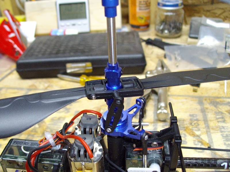

Okay here are some pics! Sorry for the quality it's with the wifes digicam that isn't the best.
The first picture shows the twister
Both upper and lower sections of the hub are secured properly.
[img]http://www.rcuniverse.com/forum/forceddownload.asp?file=0;6535668
IMGP0352.jpg[/img]
The second shot shows how the upper hub is separating or rotating on the blade hub upper side.
You can see how the rounded part of the hub has raised edges that should align with the flat of the hub notice how it's twisted over. This is the same as the first one I destroyed. [img]http://www.rcuniverse.com/forum/forceddownload.asp?file=1;6535668
IMGP0351.jpg[/img]
Both upper and lower sections of the hub are secured properly.[img]http://www.rcuniverse.com/forum/forceddownload.asp?file=0;6535668
IMGP0352.jpg[/img]
IMGP0351.jpg[/img]

After thinking about this for awhile the break is a good thing. Looking at the MH cnc hub it's solid as a brick, with a smack hard enough to twist the eflite hub, for sure the MH one would have taken out the outer shaft, then again an outer shaft is alot cheaper than a cnc lower hub.

Again, if this is the E-Flite lower then it is two pieces that can easily twist out of alignment.
Also, it does not look like the upper set screws could possibly be in the holes on the outer shaft because they are not screwed in far enough.
So if it is the two piecer then I can see how the upper part of the head is twisting.
If the picture is of the MH lower head then I have no idea what happened.
Am I missing something?
EDIT: It didn't register that the title here is "E-Flite" CNC Lower Hub.
So, I stand by my analysis that the two upper set screws are not in the shaft holes and/or the lower set screws are not tight enough.
yeah, i agree - the upper set screws didn't get into the shaft holes - the lower screws are only there to help vertically center the hub on the shaft so they don't have shaft holes to go into, but the upper screws must be in the shaft holes or you will get twist, or worse, sliding up and down! - on the one-piece hub you can fly without the lower screws, but the upper ones are mandatory, and they gotta be in the shaft holes - same with the stock lower hub

Wolf, CX and Bry. The set screws are set correctly! Trust me
They are in the holes and set deep enough. The Eflite upper hub is actually three pieces. You have the upper section with the blade lugs and set screws, then you have the lower section with the guide rods for the swash linkage and lower set screws.
Third section what third section?? Stump is on crack again!
If you look very closely at the upper piece of the hub it is actually two pieces. The rounded bottom section that has the blade lugs and this piece is compressed onto the upper section that has the set screw holes. What has happened with mine is the section with the blade lugs rotates on the section with the set screws.
When set properly on the outer shaft the upper set screws, the blade lugs and the lower set screws align one above each other with the guide legs for the swash linkage being at a 90 degree angle. Have a look at the second picture above again. You will see that the upper and lower set screws are still aligned correctly however the blade lugs are at roughly a 30 degree angle.
This is the second hub I have had separate at the same location. Unfortunately I threw out the first one. I should have kept it and taken pictures of it. When I replace this one I will shoot some pics and post them to further illustrate what is happening.
I'm still wondering if this is manufactured this way or did I get two bad hubs.
Found a picture, here is a side preview of the eflite lower hub. Note how the blade lugs and set screws align, now look at the second picture. See how the blade lugs have twisted off line with the set screw. And you guys thought I was on crack
They are in the holes and set deep enough. The Eflite upper hub is actually three pieces. You have the upper section with the blade lugs and set screws, then you have the lower section with the guide rods for the swash linkage and lower set screws. Third section what third section?? Stump is on crack again!
stump,
OK, I'll buy that explanation. I don't have that part so I wasn't sure.
Get the MicroHeli lower head, it's all one piece. Mine has worked great so far...only a few flights.
And it is lighter than E-flite's.
HopMeUp on ebay has the part for about $9 plus shipping. It comes in blue or silver. I've had excellent results with this seller.
I also have their phone number if you want to call them about shipping to Canada, PM me.
You could always use something like JB Weld to stick them together.

Didn't know that stump3r. You learn something new every day!
I have been running the E-Flite aluminum lower head on my new CX2 for several months. I just installed one on my old CX2 as well. No problems. The one time where I saw what you have right now is when the lower set screws came loose and the lower portion rotated. I was able to fix it.

I'm still shocked over how little of a hit it took to rotate it! I'm thinking of emailing horizon however typical manufacturer would claim abuse and not send anything anyway

You are not imagining things. My E-flight lower head failed exactly the way you discribed. I was wondering if I had the only one doing that. I wonder how many more out there are having the same problem?

I got mine a few months ago. I am thinking about putting a drop of superglue on it to see if that holds it in place. If not I am going to replace it with the MicroHeli one.
